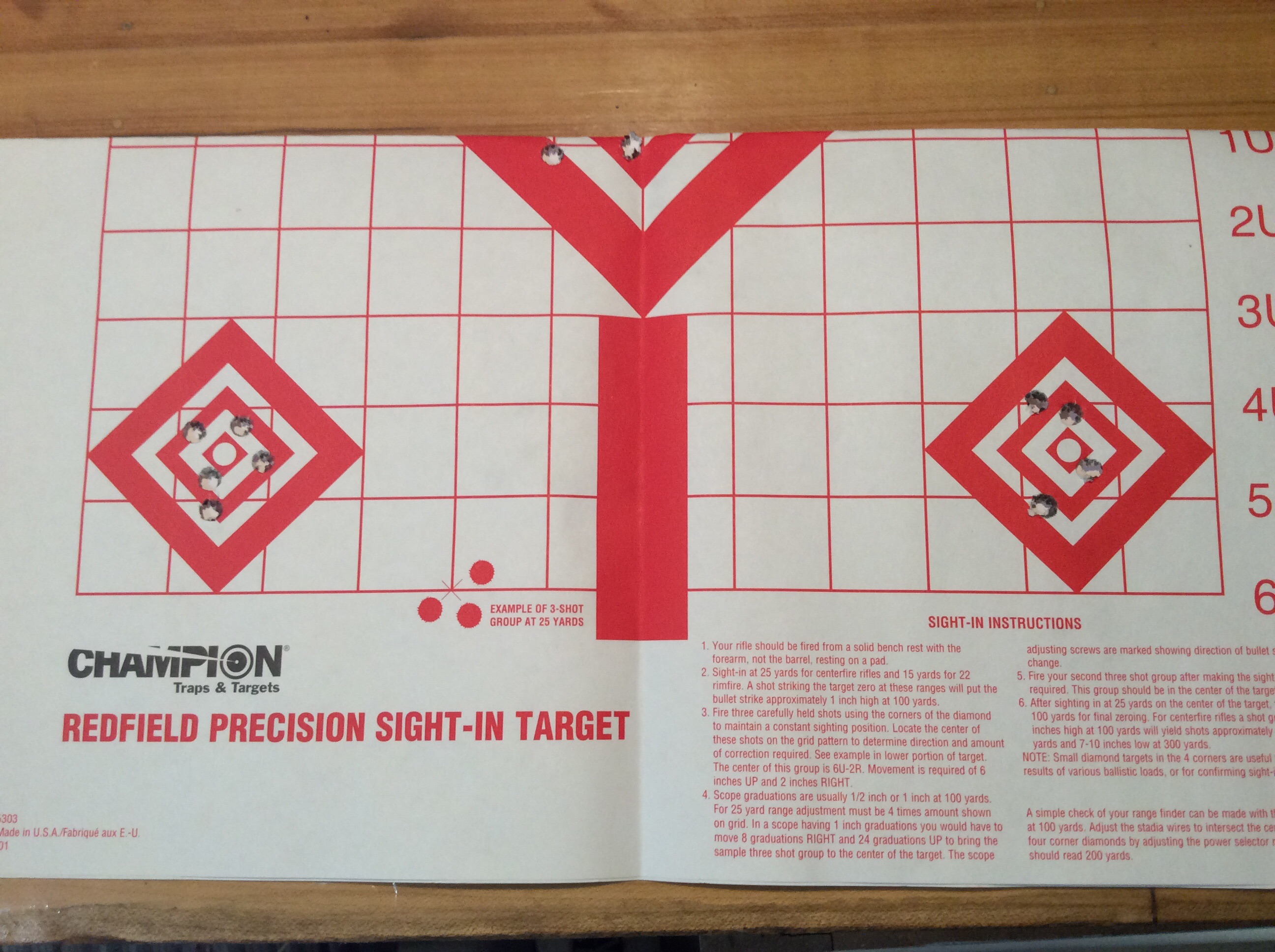

  6. Preliminary results are very good. I wasn't looking for a group but it showed me what it's capable of. Went out to zero scope. Used hornady Amax 120 to start tuning adjustable block. So that is the mess in the middle. Then put in my hand loads and let my friend (who is a novice shooter) shoot top left target while trying to re zero for hand loads. I then got behind it and shot the top right target. First shot went to high right. Adjusted windage and then shot the top left hole. Adjusted elevation 3 clicks down (to much but I'm learning mils for the first time) then I shot that very tight 5 shot group. That 6th shot is the one just right and low of the very tight group. After that I clicked elevation up 2 and shot the final 2 in the mag. Those ones right at middle are the last two shots. the bottom two targets were then shot by my friend again. Ran out of time or else I woulda got back up and seen what I could do after being completely zeroed for all 10 shots.
