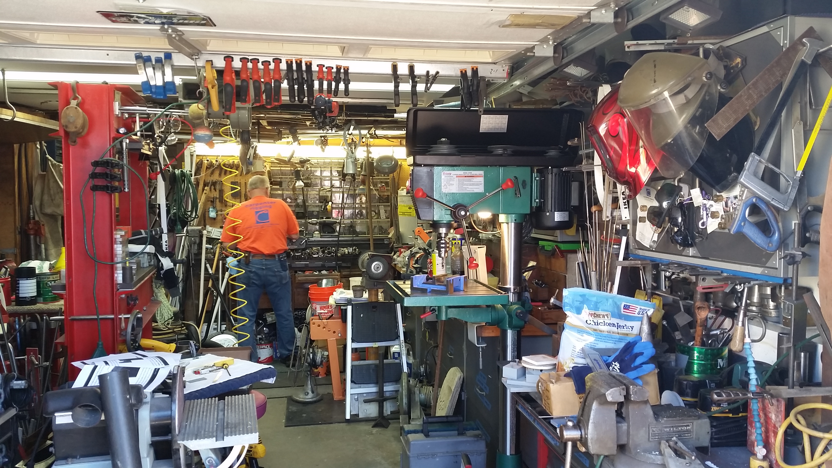

  14. hi all, so I came on here a couple months back when I ordered everything for my 308 build & got way to busy to start on it until today, so today I started on the Juggernaut JT10 80% lower & came in to a few speed bumps I will call them with it. #1: their video & instructions they provide via youtube & some very basic instructions that take all of about 1 minute to read on paper were actually set for their AR15 lower & not the 308, while they are for the most part the same in principle they just dont work out real well without a little extra work, with their jig if you follow the instructions it will end up with quite a bit of bowing in it, they should have provided shims for the bolts "no problem my pop made a set" #2: the billet aluminum their using gave me a little bit of trouble "maybe this is common & I'm just a newbie" while drilling out the 1/8" holes in the top I ran in to an area where all of the sudden the aluminum got so hard I had to put an immense amount of pressure on it to get another 1/4" of hole drilled out " I was keeping an average of a 1/4" at a time between cleaning & lubricating" this continued with a group of holes all in one area of the receiver, biggest issue with this is that I had a bit snap off in one of the holes, I left it & will deal with that tomorrow. so I finished off the rest of the 1/8" holes & decided to call it a day, images are the shims that pop made fore the jig & pop at the lathe, I'll add an update after working on it tomorrow
