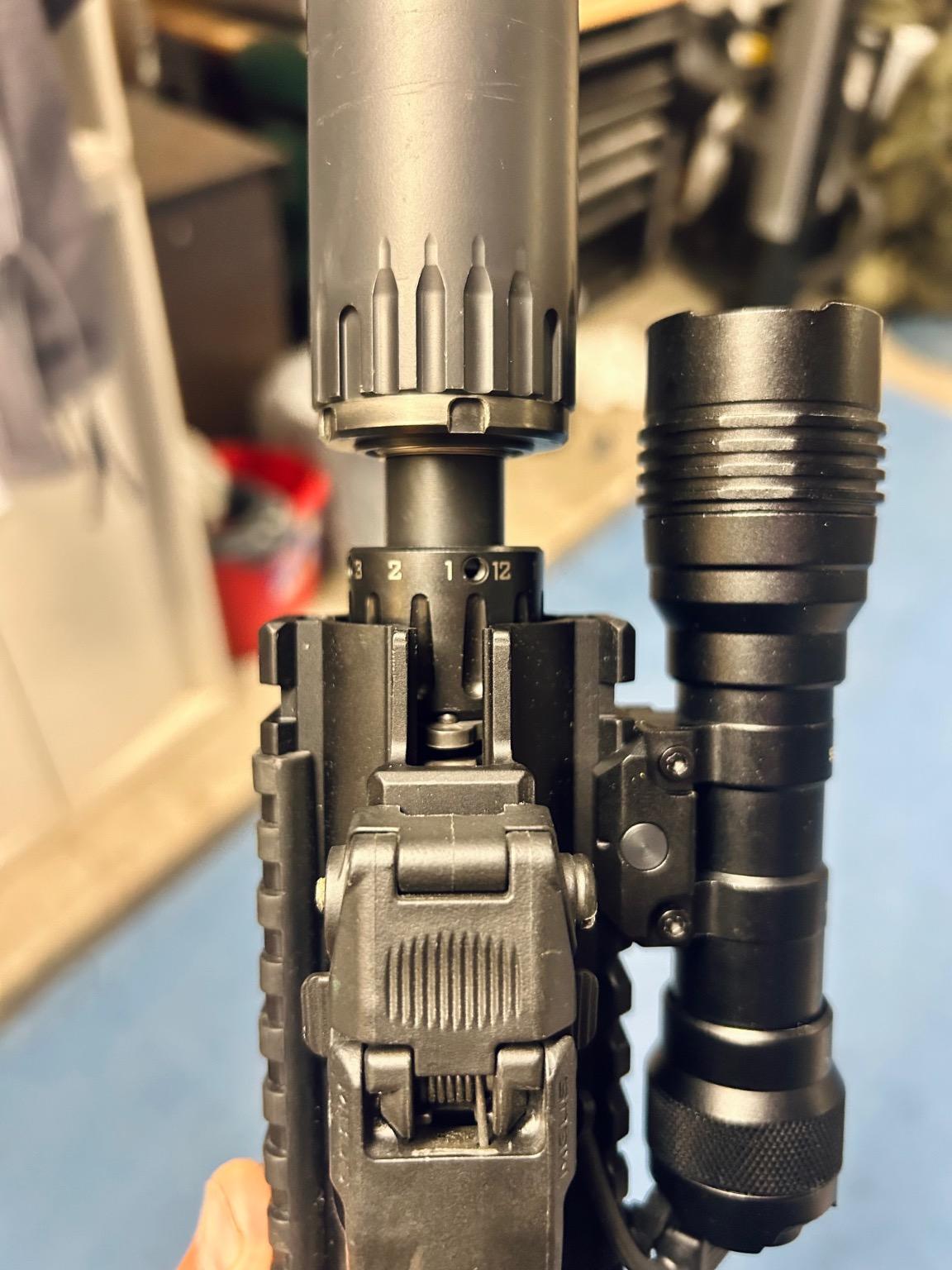

    So…just now installed today. It was very tight. Almost too tight. I don’t ever want to disassemble this thing. The rail gives me just enough clearance to adjust the rifle speed gas block. Sad thing is,it’s set in the most closed setting out of 12 positions and it cycles decent. Ejection is 2-3o’clock. Apparently you need to buy different plungers to have a different range of settings. id like 3-4 o’clock ejection so i need to get a kit from them to close off the port more. The KAK 10.5 carbine gas port was .071”. My cut down BA 12.5” barrel was I think slightly smaller which was enough to cycle on any setting. I still have the BA I cut to 10.5” from 12.5” atleast but I wanted to try this KAK barrel. I like the rails look very much. This size is very handy but I gotta ask an opinion from everyone. Is this 10.5” 308 worthy of a 1-6 like it has or should I save it for another setup? Should I go red dot and x3 magnifier instead? Still bulky either way or just do a red dot? This build was supposed to be an upscaled mk18. Just curious in what everyone thinks. this is a fun gun. It might see occasional 300+ yard shots on steel. I might go to TX to visit a good friend and hog hunt. Hope you guys like how the rail turned out.

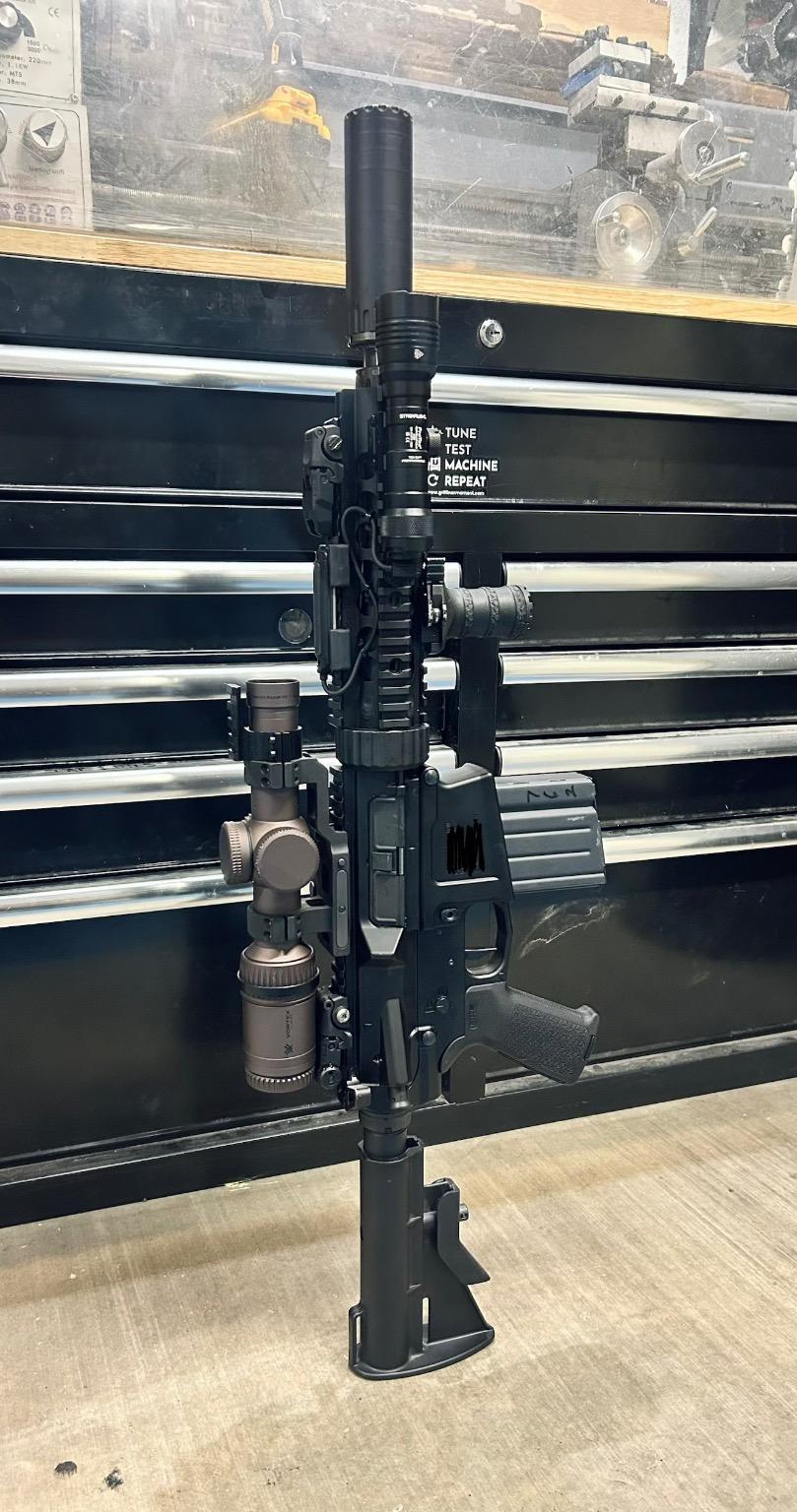

  16. I’m usually on the Form 1 forum and posted this there. Just copied and pasted for your pleasure 😉 Love this painfully stupid gun. But first sorry I don’t take great in-depth pics of the parts/rifle. It’s so damn handy I’m excited to take it out this weekend and sight in the Aimpoint and BUIS. Finally built this beast. Took a long time to give in and do it. Always had it planned but was waiting to find a DD Lite rail for it. Those are badass quad rails that Daniel Defense made years ago and can’t be found. (I love quads) for full build parts listing you can click on the videos description. This was a fun build. Not a build I intend to shoot a lot. Will not be a 600yrd gun. might try to bang steel with it that far once or twice. Won’t be a bug out gun. But it will be a gun to have people shoot unsuppressed to see their reaction!!Recoil isn’t that bad actually. Only changes might be a stock and grip swap. I’m fond of the classics I’m using though. The old Surefire is very dim but I love the look and gray color I don’t like AGBs. Never have. It’s one more thing to fail. Regardless of how good they are they can fail. I don’t want to set a gun for suppressed use only and call it good. Never liked adjusting back and forth especially when the block has 25-30 adjustment settings or needed tools(Allen wrench stores in pistol grip but what if lost?)The Riflespeed AGB I was turned onto kicks ass. 12 settings and easily adjusted on the fly with no tools. Expensive ($200) but was way worth it. Unfortunately 308 DI guns have issues suppressing because of over gassing. I think this gas block saved me and helped me build it with confidence. I ended up cutting down a 12.5 BA barrel to 10.5. I guess I could’ve bought a KAK 10.5 and tried it. Ehh..wanted to see if I could do it myself anyways. Some of you might ask why not a 8.6 blkout? Don’t get me started... I have no need for a caliber I can’t find especially one that’s very restrictive on what projectile to use on reloading. Then finally the price. It doesn’t fit my budget anyway. I would 100% rather build a 338 Spectre or 9x39 first for an odd ball caliber. The 7.62x51 is everwhere and if I wanted to shoot 100rds at a time it’s way more economical then 8.6.
