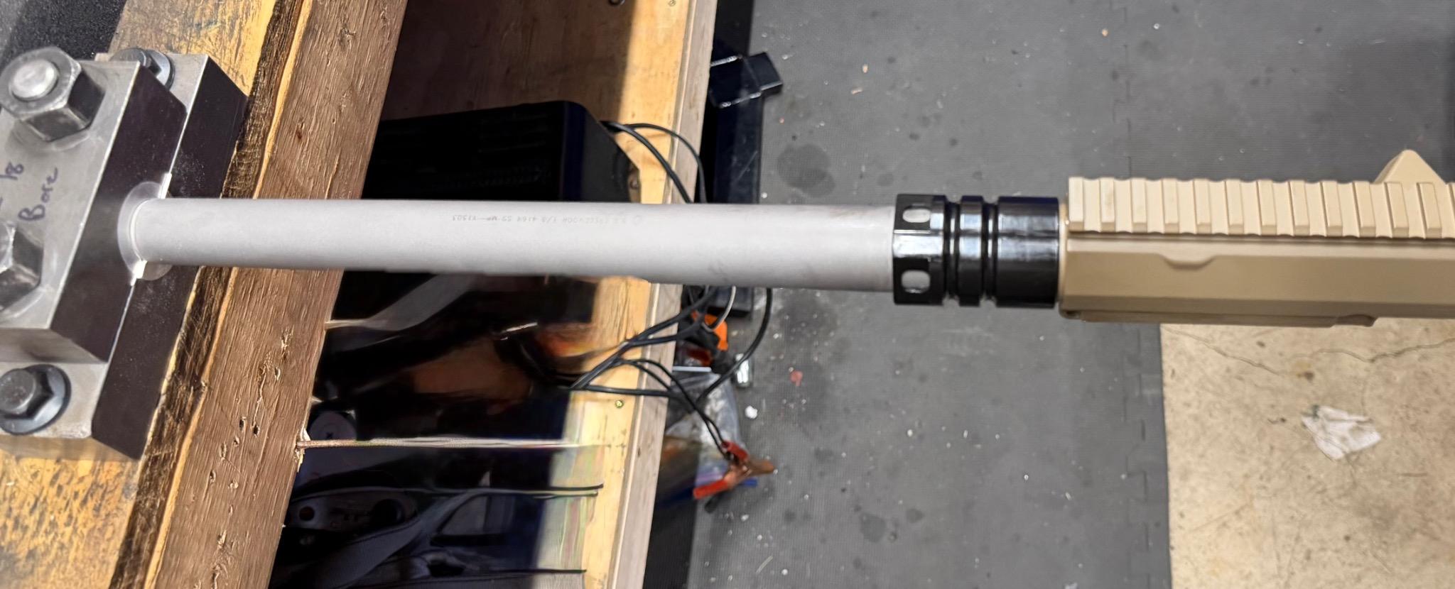

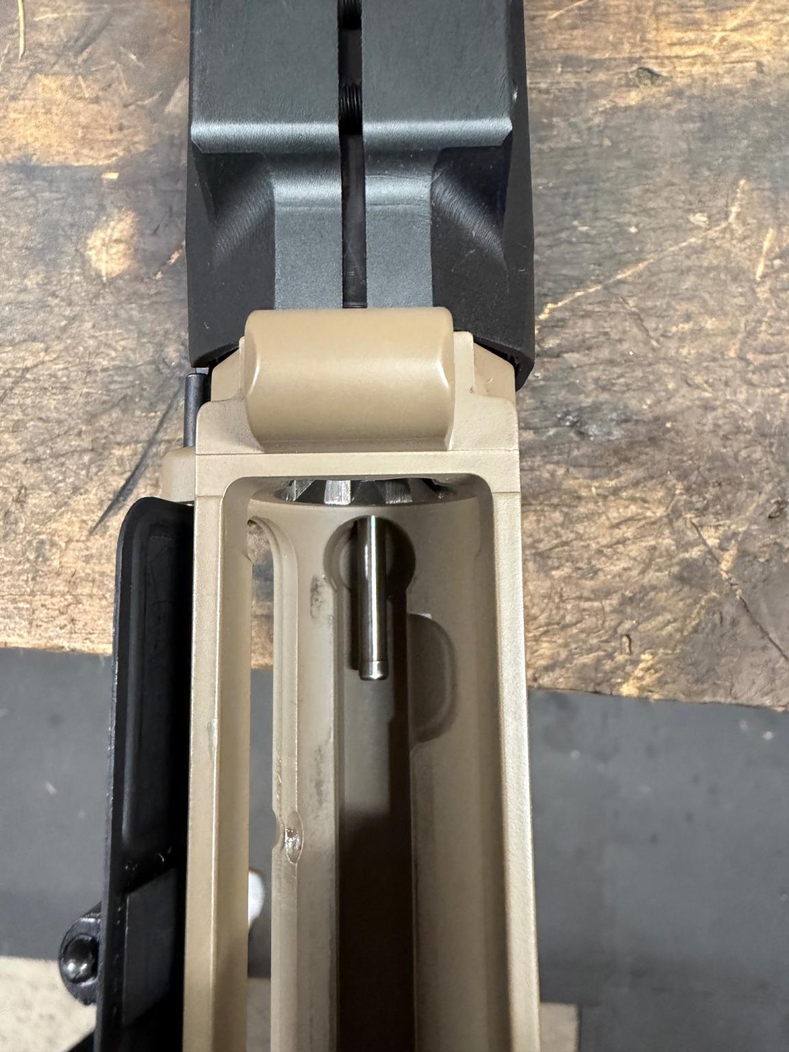

  1. I recently purchased an m5 upper in fde (only color they had available) from my local gun store. He's been sitting on a couple for awhile so they were made by the old owners of Aero. While I had it in my hands it I noticed the rear lug missing a chamfer on one side, so I tried it on my lower and it had a ton of slop even with the adjustment screw up against the bottom lug. Took some measurements and sure enough it was off, so I sent an email to Aero along with the pictures and they sent me a return label to inspect it. That was on Oct 21st, received an email that the upper is out of spec on Nov 4th and they will replace it when one comes available, but no eta. Get home today and I have a package waiting for me, less than a month turn around even though they just started up production again is an A+ in my book. I just wanted to say I have complete faith in the new owners of Aero, they could have just said tough luck and not their problem but they went above and beyond to help me. They even let me pick the finish of the new upper I received. Hopefully they can get their backlog caught up and we will have an assortment of quality parts available again. (The new upper fits great, the finish is just a hair more matte than the lower I bought in 2020 but with a little oil you can't tell)

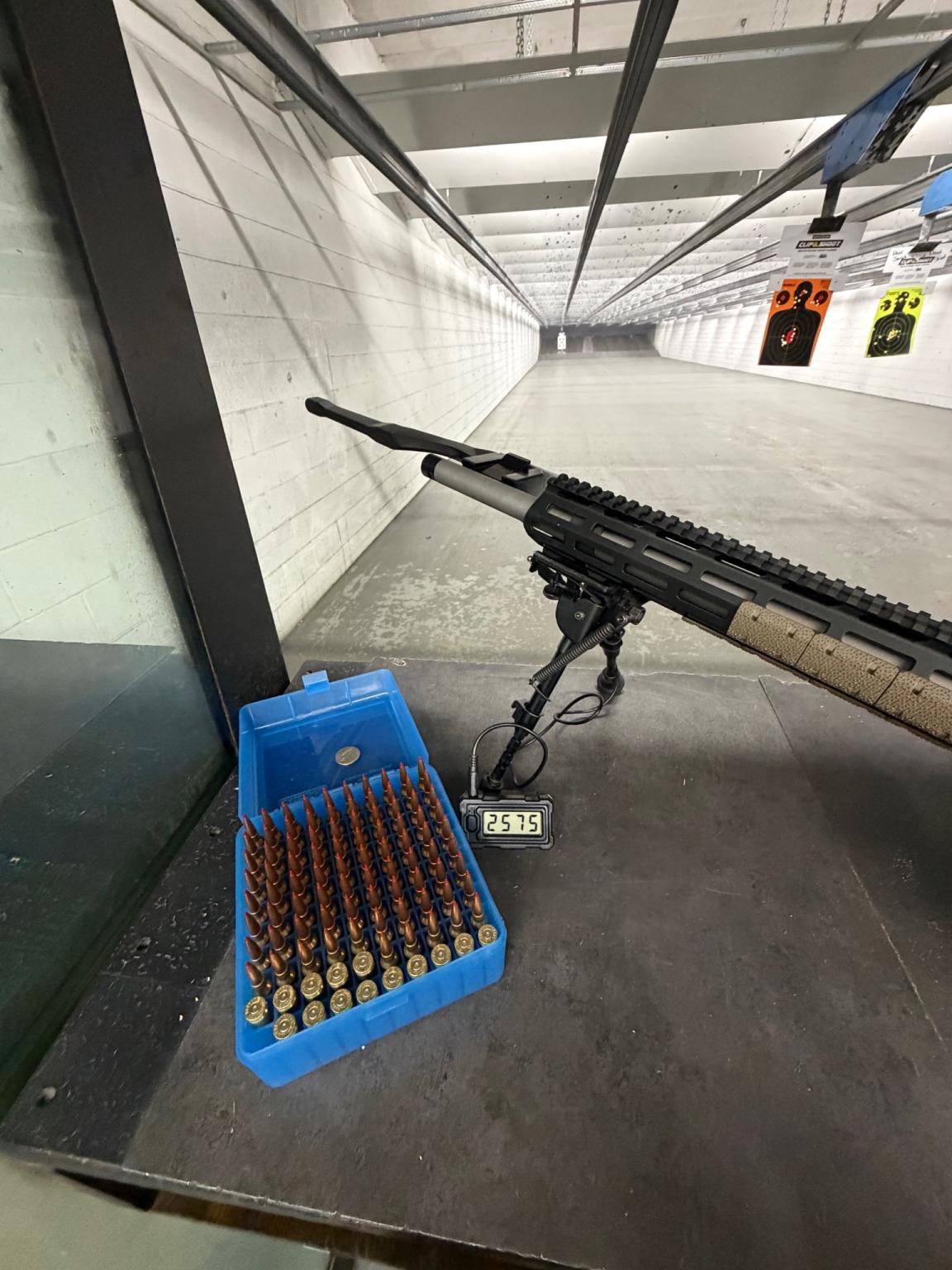

  3. I got out to shoot again today, the top row with the silver primers are my standard load with 205m primers and the gold primers are cci41’s. Even with the gas block adjusted in 1 click I still had pierced primers, it was enough gas to eject the empty but not enough to pick up a new round out of the mag. Moved onto the reloads with the #41 primers and not a single puncture! That seemed to finally solved my problem but then a new one arised, as I was picking up my brass halfway through shooting I noticed these very deep gouges from the ejectors. The chrono showed 2606 fps as my average speed with sd-11 and es-53, so I picked up a little bit of speed but nothing that should cause the case head to gouge like this. I did one more experiment and shot 5 rounds with the gas block completely closed, and while there were light marks on the case head they weren’t pronounced at all. Would this be a timing issue again or something with the cases? These were reloaded exactly the same as my previous batch except the primer change, they were also the other half of my Lapua brass so they weren’t subjected to a pressure event like the previous 50rds of brass I fired.
  4. I only shot 3 rounds with it adjusted in one click, but didn't get any pierced primers but that could be because of the small sample size. Overall 7 out of 50 primers pierced so I guess that would be a not so common thing happening for me. I loaded up 10 rounds same as before and 40 with the cci #41 primers and will hopefully get to test them tomorrow. I am curious how the milspec primers would increase my fps compared to my regular match primers?

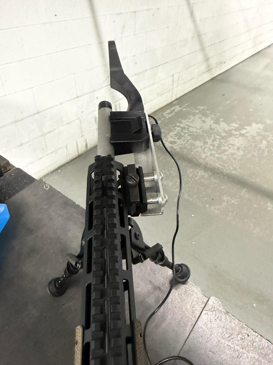

  5. If you want cheap, I use a magnetospeed sporter and modified it so it freefloats the barrel and doesn't effect harmonics. You can build it all for less than $100 if you have the tooling. If interested Ill give you everything I used and a print to follow.
  6. It is a smaller diameter firing pin bolt with the smaller diameter pin. Checked it with my standard firing pin and the standard pin wont go into the high pressure bolt. I did adjust the gas block one click when shooting but then it wasnt locking back on an empty mag while firing it single shot. For reshooting the loads, should I only reload the brass with ruptured primers and retest that way? I will retest with the gas block one click in and see if that makes a difference as well and report back.

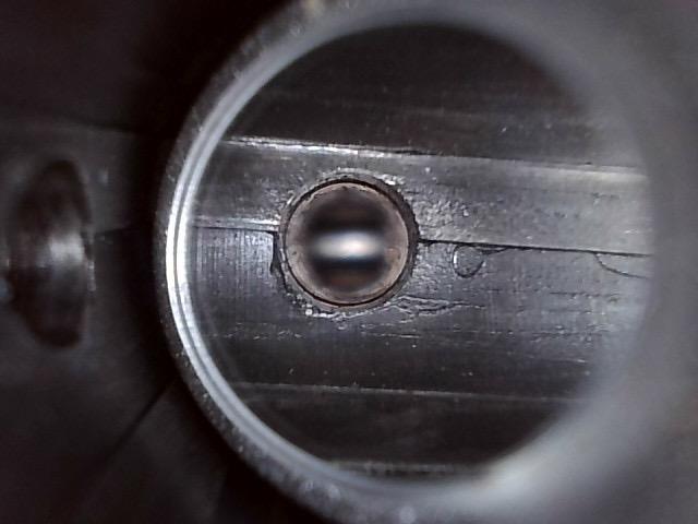

  7. Talk about impeccable timing! I just finally got the chance to test it today, I am having another issue but it's not due to the previous issues. I was going to make another thread but since you're here and have reloading experience ill pick your mind. Rifle functions fine if the primers don't get pierced, once they blow the remains end up in the firing pin channel and locks up the bolt. I tried 2 brand new firing pins to rule out that issue but get the same results. For rifle specs: recoil system is an armalite setup their spring, h3 buffer and 7-3/4 tube, Bcg is Kak high pressure with dual ejectors and smaller .068 firing pin, and barrel is a BA 20"6.5CM with rifle length gas tube, aero adjustable gas block and gastube in the middle of the cutout. Load data is: Lapua SRP twice reloaded using federal 205m primers, 40.2g H4350, 140g eldm's with a Lee factory crimp die. FPS average is 2577 with an sd7 and es38 over 50 rounds so nothing close to hot. I had the same experience using cci400 primers and thought the thicker primer cups of the 205m would help but they didn't. I do have cci #41 primers I could try that are milspec, but already have a full brick of the 205m primers i planned to use just for this build. I built this gun with the intention of strictly reloading for it since I have a bunch of primers and 8lbs of H4350. At this point I wonder if I will have to change my load data and choose new bullets or something else because the pierced primers are starting to etch into my boltface and ruin my firing pin tips.

  10. That’s a perfect explanation, I apologize for leaving out critical information. At least I know for next time👍 I will put up my build list when I test the adjustable gas block, I would like some results to share incase someone is having the same issues I am. For the magnetospeed mount, I have access to cnc mills/lathes that most people dont so it would be hard to do a write up using only handtools. If you’re interested, I can make a thread that would include a print and possibly try to explain how I would do it by hand. It was rather cheap and if you don’t care about how it looks I cant see why someone can’t do it with some drills and a dremel with a burr tool.

  14. I do have a .875 journal but I doubt that would make that much of a difference, any other ideas to check or do I get an adjustable gas block or extra heavy buffer?
