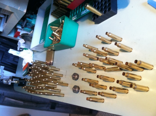

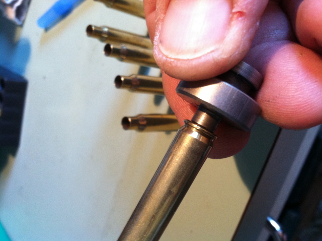

I have an older ( most of my reloading equipment is well past twenty year mark ) RCBS Swaging tool. I'm using the primer pocket uniformer to test the primer pockets for resistance & after testing some that i just sized & cleaned I got about 1/4 that didn't pass my new test . Not that any or all would pop a primer but, with feeling no resistance to inserting the tool , they are put maside for the scrap brass , Range master at the range . He collects brass for recycling for cash for his after school youth shooting class, a good cause I don't mind contributing to.
The photos show brass that I can not insert the primer pocket tool into with out resistance & those that do . I only use this tool on really large or heavy crimped pockets . I use my deburring tool to clean most up .
The brass to the right or lower part of photo didn't pass.

I went through all my .223/5.56 ,300BLK & 308 that was sized & deprimed & cleaned,. decided to try seating some primers in both the passed & those that didn't & you can definitly tell the difference seating the primers in both the .223/5.56 & 300BLK & cut down 5.56 , formed to 300BLK , didn't matter what manufacturer or cal. .The only brass for .308 I have ready are all 308 , no milspec brass, all commercial remington ,WW, FC, the FC at least had some resistance.
Definitly another testing to make sure I have no problems with reloads. I just have to set some LC or other milspec 7.62x51 brass to do more testing on the 308's.
