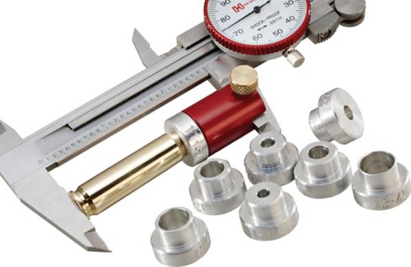

Once you fire a brand new piece of brass, it's now fire-formed to your chamber.  Measure the length of it, fired.  Use comparator gauges, and check the length, against the shoulder.  Set your dies up so that you bump the shoulder either only 0.002" or 0.003" back from the fired length.
You'll never, ever have a problem.  :thumbup:
Hornady Lock-N-Load .224 - .308 Comparator Set | Field & Stream
