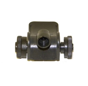

texas30cal Posted December 16, 2012 Report Share Posted December 16, 2012 I didn't really know where to post this, move if necessary. The rifle shoots great but the hole in the rear sight is so large that when focusing on the front sight it is very hard to tell if I have the front sight in the center, also it is very blurry to me, I understand that I can't focus on both at once, but I can't even make out the edge of the hole. My eyes aren't perfect but could they be the problem? I don't have any problem with any of my pistol sights but even my 10-22 and henry 22 look the same way to me. Is this what the sight with the hood and smaller hole is for? I also saw a gentleman that actually makes lenses that go in the hood, does anyone know anything about these? Quote Link to comment Share on other sites More sharing options...
98Z5V Posted December 16, 2012 Report Share Posted December 16, 2012 Quote Is this what the sight with the hood and smaller hole is for?Yep. Hooded National Match rear sight. <thumbsup> Quote Link to comment Share on other sites More sharing options...
N Jensen Posted December 17, 2012 Report Share Posted December 17, 2012 A little more info, the hooded rear sight comes in two sizes .520 and .595 you also will have a the ability for 1/2 min adj by turning the hood 1/2 turn to the next detente. You mention that the front sight is blurry? With the hood installed you can insert a diopter into the hood and that will help with the front sight focus. Check out this link http://www.bjonessights.com/SR.html the cost isn't bad to get a front sight in focus. Also installing the rear sight can be worked so the end result is good clicks up and down and without any play. Not many sights go together and end up without any play in them. If you have any play sided to side that can be felt the group on target will be big as well. Steps to fix it are out there and isn't that hard to do. I assume the windage knob has a spring and ball underneath it. If it does you are half way to a 1/2 min rear sight on your rifle, just buy the hood and slide. Good luck. Quote Link to comment Share on other sites More sharing options...
texas30cal Posted December 17, 2012 Author Report Share Posted December 17, 2012 Thank's for the replies, I meant that the front is clear but the rear is very blurry, but I understand I can't focus on both. Is that what the diopter is for? Quote Link to comment Share on other sites More sharing options...
N Jensen Posted December 17, 2012 Report Share Posted December 17, 2012 Yes, the diopter helps one to focus on the front sight. Quote Link to comment Share on other sites More sharing options...
