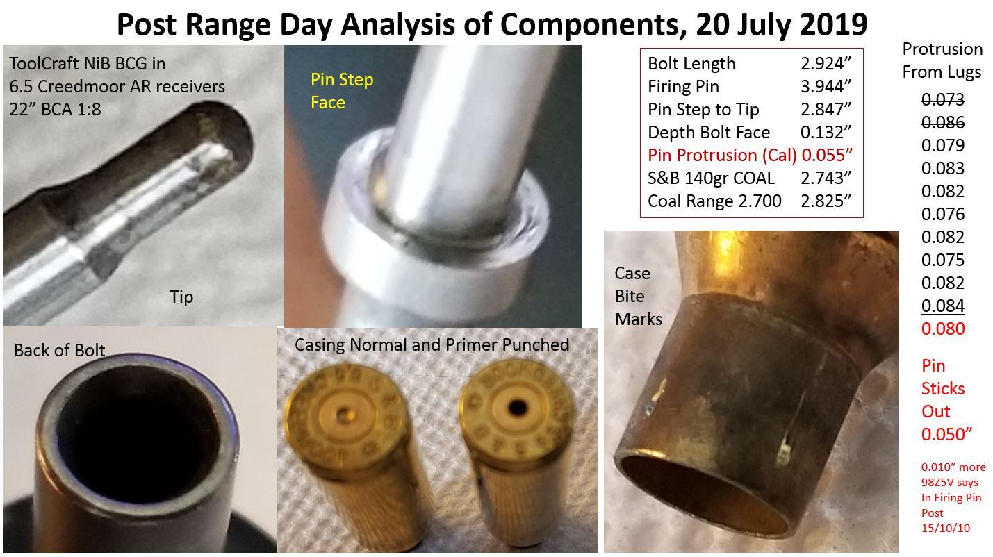

  17. Not IMHO, tested and verified, its NO BS, Facts jack. Granted the error margin is smaller for the ELD but if you shoot Hornady white tail the SP tips which obturate at 7KPSI. the accuracy is around 7 MOA instead of sub MOA. QED Questions yes, yes. So if the muzzle velocity and resultant change in pressure is not that sensitive to that small of an altitude change then what is causing the primer punch. Probably fired maybe 700 to 800 of these in various rifles with no problems until now.

  20. Oak Standard AR-10, rifle length. These things are usually fairly tight in the chrono. and you can see they are loaded right up there with those nice little volcano shape primer strikes. This happened at 1600' normally I am firing at 300'MSL think the pressure altitude was enough to juice them up. I might try some other ammo, but I hate using ELDs in this tip eater.
  21. Been using the recommended ToolCraft NiB BCG in my 22" 6.5 Creedmoor. Got about 120 S&B 140gr FMJ rounds, all same lot, thru it. Started punching the primers during firing, four times in last 8 rounds. What is happening? Measured the pin depth using recommended procedures and found the pin to protrude 0.050" the cited number in the archives for this BCG should be 0.040" so why is it screwing up now?
