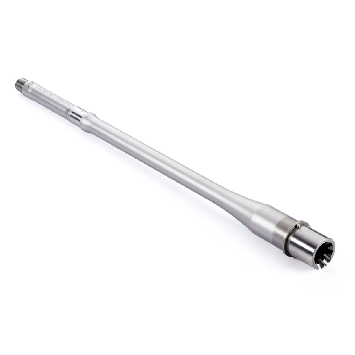

98Z5V Posted October 30, 2025 Report Share Posted October 30, 2025 4 hours ago, Yallqaeda said: Is there a vendor that has the Armalite barrels on the shelf? Not usually, for what you're looking for. I'll tell you now that we can overcome any gas system issues you have, though, so don't worry about gas system (gas tube) length. 4 hours ago, Yallqaeda said: Hey all, I’m looking for a 308 or 7mm-08 (would really prefer 7mm-08 but I’m not optimistic lol) 20”, lighter profile barrel that uses the Armalite gas system length. I have a a 7mm-08 Wilson Combat barreled gas gun, and it's awesome. It's been on the back burner as far as load development goes, with a bunch of other distance guns on my plate recently - but it shoots, and I've shot it. Wilson Combat is my go-to source for premium barrels in weird calibers. Here's the barrel I have from them: https://wilsoncombat.com/barrel-7mm-08-remington-tactical-hunter-18-round-stainless-glass-bead-1-9-5.html Don't get wrapped around the axle over the desire for a 20" &mm-08 over this 18" 7mm-08 barrel. It'll do everything you ever want it to do, and then some. Quote Link to comment Share on other sites More sharing options...

Yallqaeda Posted October 30, 2025 Author Report Share Posted October 30, 2025 (edited) 7 hours ago, 98Z5V said: Not usually, for what you're looking for. I'll tell you now that we can overcome any gas system issues you have, though, so don't worry about gas system (gas tube) length. I have a a 7mm-08 Wilson Combat barreled gas gun, and it's awesome. It's been on the back burner as far as load development goes, with a bunch of other distance guns on my plate recently - but it shoots, and I've shot it. Wilson Combat is my go-to source for premium barrels in weird calibers. Here's the barrel I have from them: https://wilsoncombat.com/barrel-7mm-08-remington-tactical-hunter-18-round-stainless-glass-bead-1-9-5.html Don't get wrapped around the axle over the desire for a 20" &mm-08 over this 18" 7mm-08 barrel. It'll do everything you ever want it to do, and then some. I’d be happy with 18” too, anything I can mount rifle length drop in handguards onto would be fine. if that barrel had the proper gas system length I’d have been all over it. Edited October 30, 2025 by Yallqaeda Quote Link to comment Share on other sites More sharing options...
