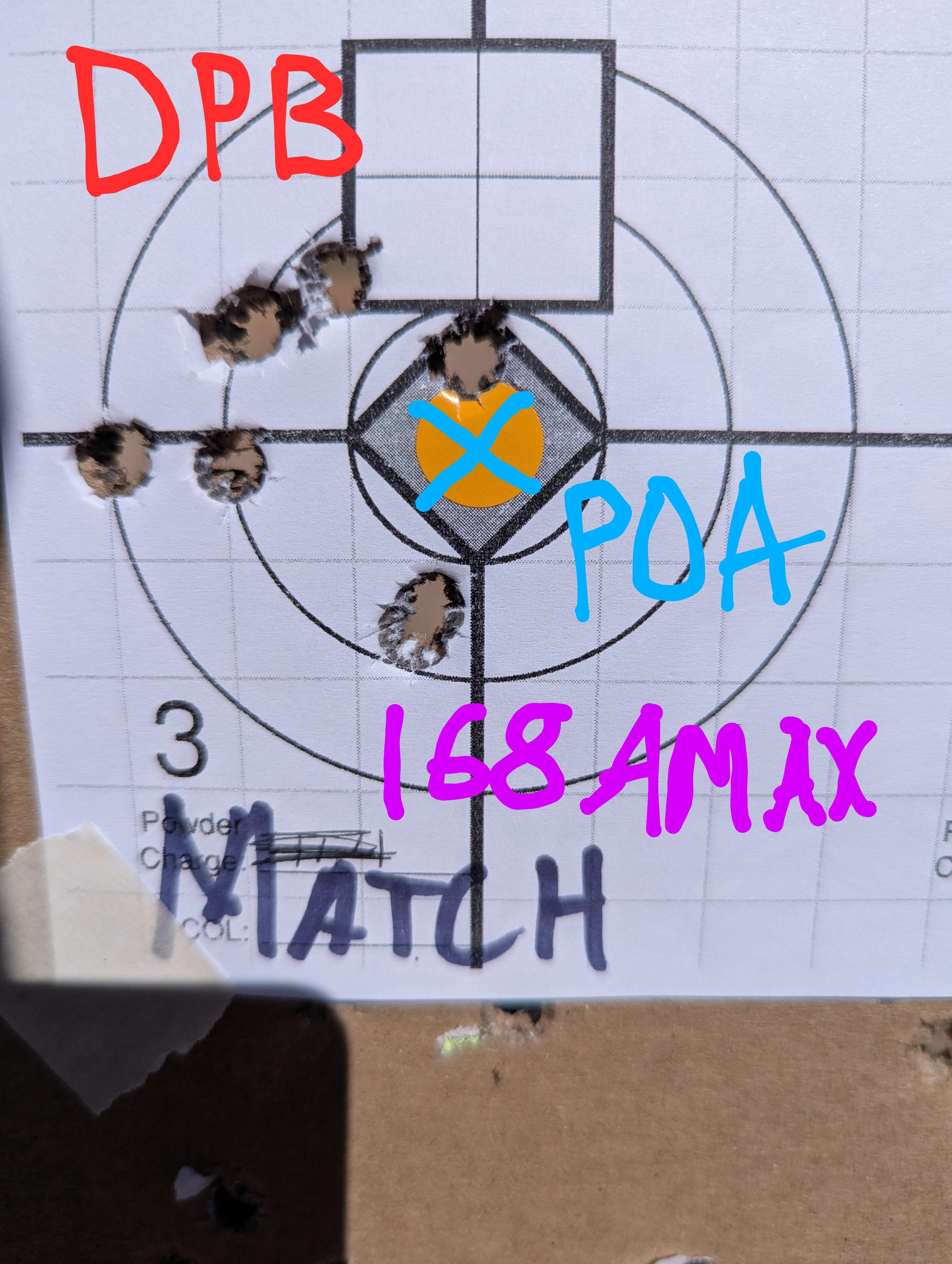

A couple years ago, I built 2x matching LR-308s; one for myself and one for my father as a family/legacy/hand-me-down whitetail hunting rifle pair. I had gone through 4 different Faxon barrels (Stainless Match and 4150) that wouldn't group at all (5-10 MOA), and then I switched to the Wilson Combat 18" Tactical Hunter. These barrels were starting to group, so I pressed on; I'm not going to discuss the incorrect gas tube length/gas port distance on these barrels. I was able to get the barrels cycling fine for me...
However, I've been chasing my tail the last couple of years trying to make a hunting handload for my father and myself that will consistently group. POIs would sometimes shift significantly mid-string, possibly pointing towards heat issues. However, I do most of my testing with a barrel chamber cooler. Grouping was never acceptable to my standards (3-shot consistent 1 MOA including cold bore). At first I thought it was my scope, so I sent it back to Primary Arms, who sent it back to me after testing stating the scope was fine. I have spent countless hours reloading and purchasing nearly every off-the-shelf 308 ammo for testing with zero consistent results. I even tried different bolts (cheap 308 bolt, HP Toolcraft, and RCA) with no change in results. Yes, I checked headspace before installing the barrels. I even re-installed them to confirm barrel nut torque and trued the uppers.

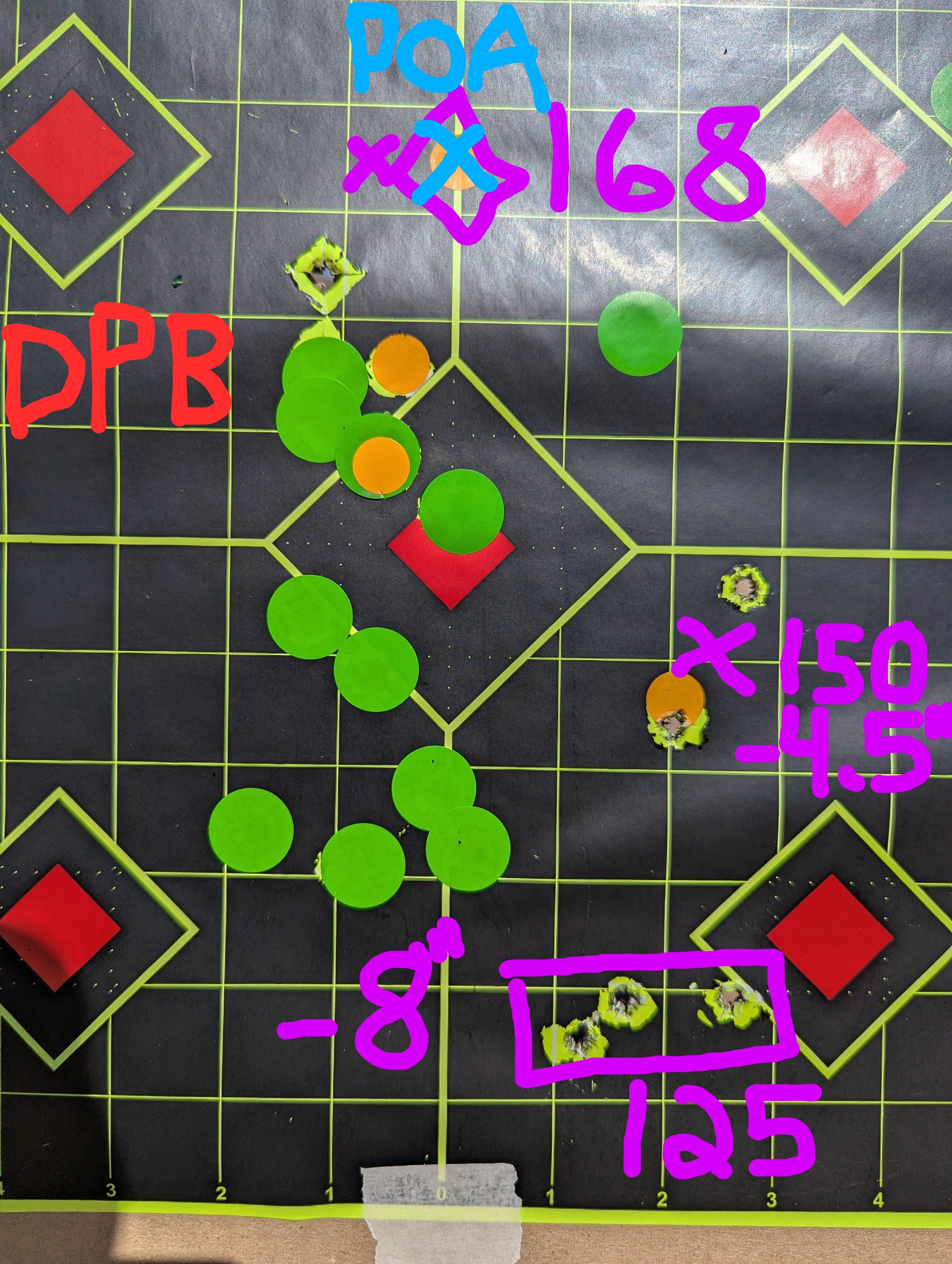

When I zeroed my scope for 168 grain ammo and then switch to 150 grain, my POI shifted 4.5 inches down and slightly right; when I switched to my 125 grain handloads, the POI is 8 inches down! I've never seen a shift this drastic with various bullet weights. (I do all my test without a suppressor). I know how to shoot with my stable setup, The Rock front rest and Protektor 13B rear bag; nothing on the handguard to catch the front bag. I shot 0.22moa 3-shot (100yd) with my handloads tuned for my father's cheap T/C Venture 223 yesterday, which is fairly normal.
DPB2.thumb.jpg.2ea5c652389d23cef472b7cb8a9883c4.jpgDPB1.thumb.jpg.fc17ade2d9e28f120c853ac399d78534.jpg

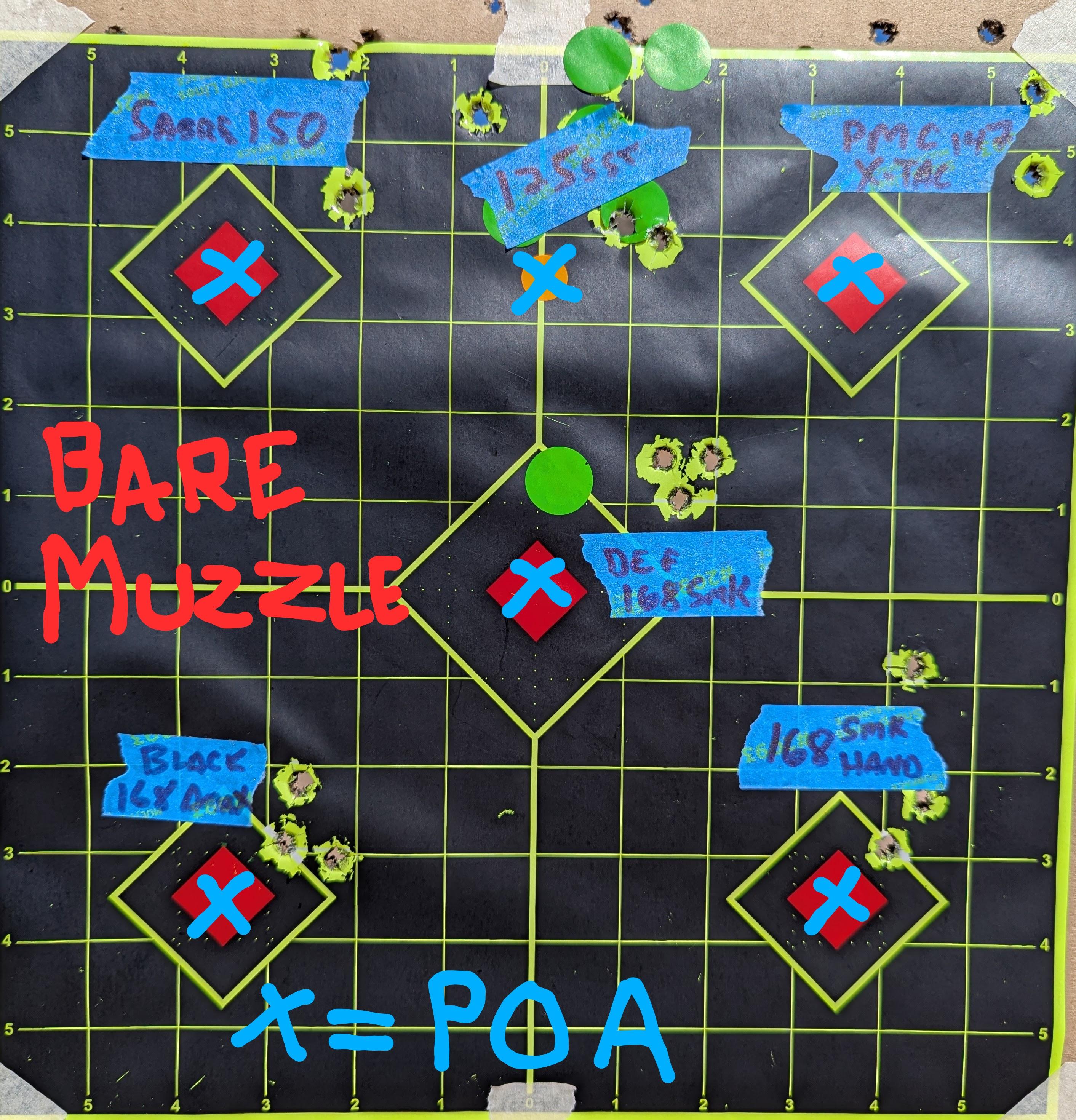

Then it hit me: I had a Rearden Atlas DPB installed by East Valley Tactical almost immediately after building the rifle to use with my suppressor. I figured maybe the harmonics were off or it was installed too tightly. So I removed the DPB and retested with a bare muzzle. The results were....shocking to say the least.  My 168 grain and 125 grain handloads were grouping sub-MOA, the factory/bulk 150 grain ammo not too shabby, and ALL POIs were 1-2 inches at 1:30.  The barrel didn't care what bullet was going downrange.

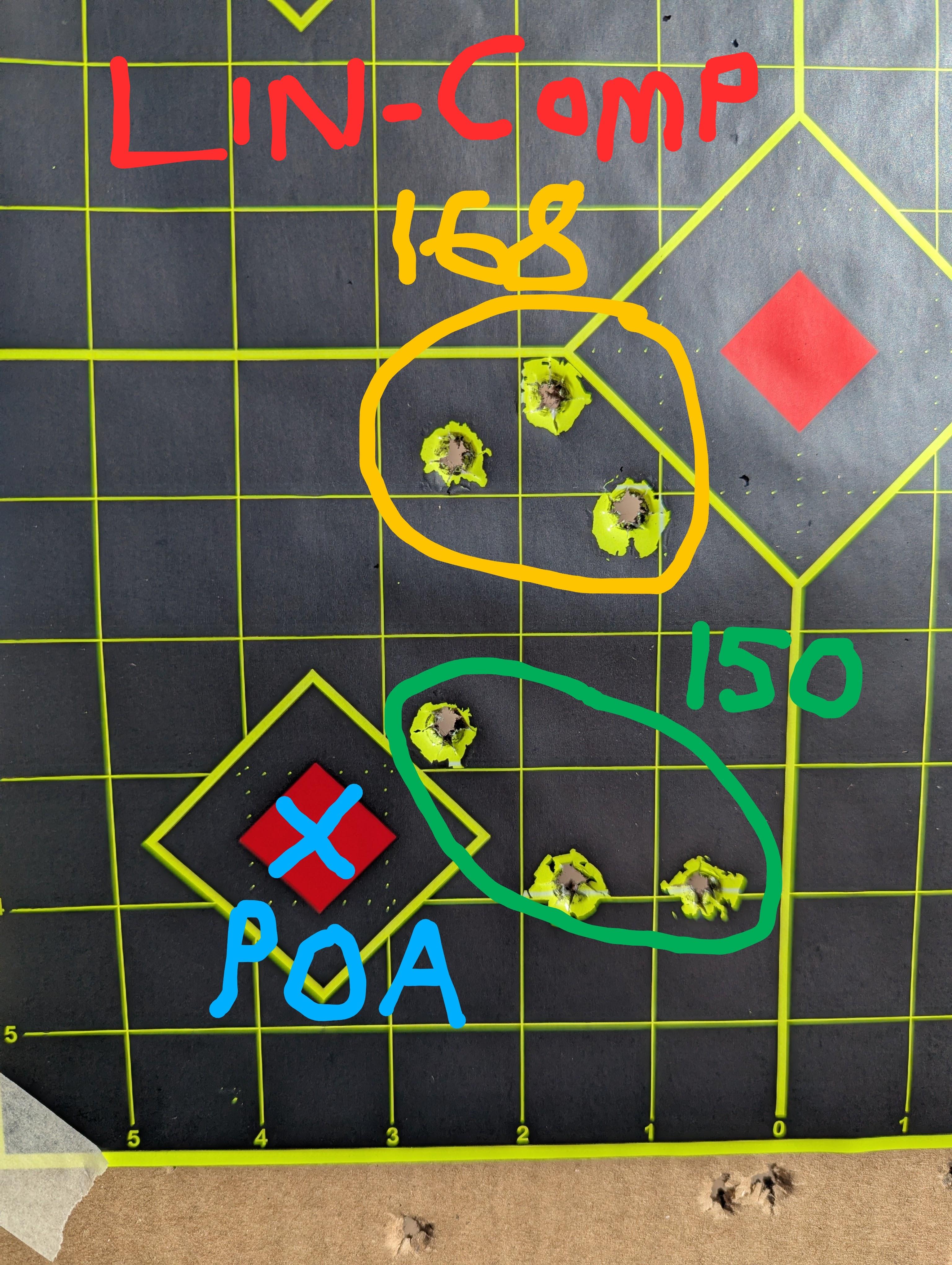

So then I installed a KVP Linear Comp at exactly 25 ft-lbs torque with a proper crush washer, as this was the setup my father is using. The 168 Black AMAX group opened up again and shifted further away, while the 150 grain shifted down. Not what I wanted to see, and I didn't waste any other ammo testing with the KVP comp.

It's the muzzle device.  I've tested guns out here in the desert, that don't group for shiit.  REMOVE the muzzle device, and suddenly, the gun shoots.
I had someone give me the muzzle device we took off, for finding the problem.  I threw it in the trashcan when I got home.
What's the barrel twist rate on the WC barrels you're shooting?  That was left out, above, and makes a difference, overall.
From what you've stated, so far, you get different results from different muzzle devices.  That's what I'm picking up here...

Yes.  It will prove the point that it was the muzzle device.
5 hours ago, Dewey Mack said:
Or do I contact WC for a barrel replacement since I can't use the threads on these barrels with consistent results (as if WC cares about that with their 1.5moa tolerance)?
That's not the problem - it grouped, bare barrel. It's not the WC barrel, obviously, since it grouped.  The only two muzzle devices you've tried resulted in shiit accuracy, and you shot it bare and it worked...  That tells everything, right there...
