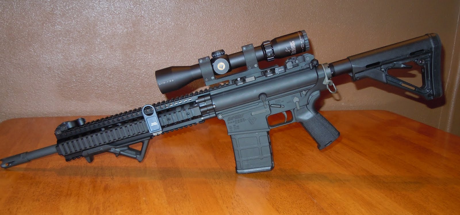

SICARIO Posted January 11, 2011 Report Share Posted January 11, 2011 Hey there, new to the forum, but not to AR's. Here is my DPMS 308 in it's latest configuration.Glad to see there's a forum dedicated to this awesome rifle.Additional pictures: http://northwestexpeditions.blogspot.com/p/ars.htmlMods:# Stock: Magpul CTR # Magpul ASAP Plate (for the MS2 Sling)# Grip: Magpul MIAD w/ Grip Wedge# Charging Handle: BCM Gunfighter Mod 4# Trigger: Geissele SSA# Pins: KNS Anti walk/rotate pins# Front/Rear Flip up sights: Troy# Scope: Burris XTR 1.5-6x40 (w/ Hunter Turrets)# Mount: Larue Tactical LT-104# Magazine: PMAG 7.62# Rail: Daniel Defense 7.62 12.0 (now a 9.0 rail)# Barrel: DPMS AP4 (reprofiled by ADCO for reduced weight)# Forward Grip: Magpul AFG# Forward Sling Mount: Daniel Defense# Flash Hider: DPMS Panther (soon to be Vortex)Will be installing a Kaiser barrel shortlyAh, and of course, can't forget to show success pictures: Quote Link to comment Share on other sites More sharing options...
TacBlade Posted January 11, 2011 Report Share Posted January 11, 2011 That looks Great!!! Welcome!!! Quote Link to comment Share on other sites More sharing options...
Matt.Cross Posted January 11, 2011 Report Share Posted January 11, 2011 That's a sweet rig alright, it's always that LT quick-detach scope mount that catches my eye first though. You just can't beat 'em. Quote Link to comment Share on other sites More sharing options...

SICARIO Posted January 11, 2011 Author Report Share Posted January 11, 2011 The Larue LT-104 works really well. It sits a little higher than the lt-158 (1.5" vs 1.44") but it doesn't have the 10MOA built into it.I talked with Larue about which would be a better choice for the 308, here's what they said: "Depending on how far you are shooting, the 10 moa will make a difference.If you want to be able to dial adjustments out past 600 yards up to 1000yards, you will need the 10 moa base. If you know you will never dialadjustments beyond 600 yards, then you'll be fine with the LT104. Bothmounts will clear the Troy sight"I figured since I wouldn't be making adjustments (I've got the 7.62 ballistics reticle on the scope), the lt-104 would be perfect, and it's the same mount I have on my AR. Quote Link to comment Share on other sites More sharing options...
