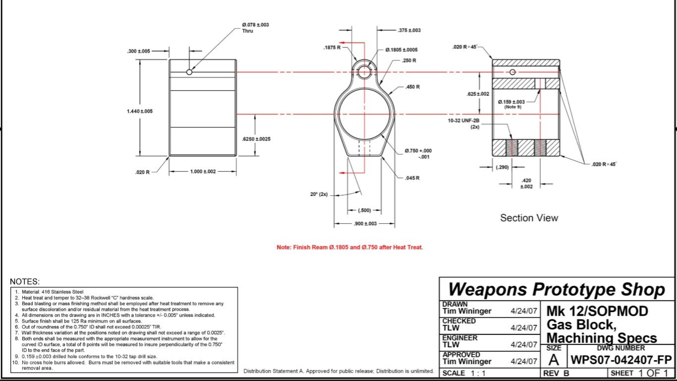

archangel2003 Posted February 8, 2016 Author Report Share Posted February 8, 2016 I assume they are compressed as they are too big?Can you send them in a PM? Quote Link to comment Share on other sites More sharing options...
mrmackc Posted February 8, 2016 Report Share Posted February 8, 2016 You really can't increase the resolution of the pictures of a posted image, you can increase the size with a photo editing app but the pixels will just be enlarged and the resolution will suffer. Maybe you can write the information down and do a Gogle search and find the original web site and get an original downloaded to your desktop and then do some editing. Quote Link to comment Share on other sites More sharing options...
Robocop1051 Posted February 8, 2016 Report Share Posted February 8, 2016 those are almost thumbnail size pics. I'm sure there's larger ones out there. Quote Link to comment Share on other sites More sharing options...
mrmackc Posted February 8, 2016 Report Share Posted February 8, 2016 ....Also it depends on how you post the image on the forum from your computer, tablet or mobile phone. I think if you have a fullsize drawing it could be scanned and emailed as an attachment file. Quote Link to comment Share on other sites More sharing options...
archangel2003 Posted February 8, 2016 Author Report Share Posted February 8, 2016 When I Google weapons prototype shop I get cartoons and games. Quote Link to comment Share on other sites More sharing options...
archangel2003 Posted February 8, 2016 Author Report Share Posted February 8, 2016 Here it is in full size. http://i1239.photobucket.com/albums/ff502/augeekim/augeekim006/CRANE_GB_DRAWING_zps81582e3b.jpg~original Quote Link to comment Share on other sites More sharing options...
mrmackc Posted February 8, 2016 Report Share Posted February 8, 2016 My anti malware blocked the original site for the drawing, not photobucket. Quote Link to comment Share on other sites More sharing options...
MikedaddyH Posted February 8, 2016 Report Share Posted February 8, 2016 My original was fine but that is the only way I can post it. I have many(a whole lot) that will not post to this site ! Quote Link to comment Share on other sites More sharing options...
archangel2003 Posted February 9, 2016 Author Report Share Posted February 9, 2016 Here it is in full size. http://i1239.photobucket.com/albums/ff502/augeekim/augeekim006/CRANE_GB_DRAWING_zps81582e3b.jpg~originalI found someone who has it full sized here.I think I'll start saving these to my photobucket account. Quote Link to comment Share on other sites More sharing options...
