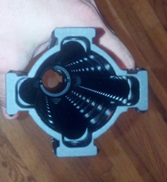

Robocop1051 Posted September 21, 2012 Report Share Posted September 21, 2012 @usspfnorman:I have a simple remedy for that gap. It will only cost $5-$15. Hell, you might already have the part in your gear box and didn't realize it....Round Handguard CapI still think the flip sight is a good idea! <thumbsup>Re: the LMT vs "Anyone with a mono upper" issueThere was no lawsuit. LMT just got the patent for their mono upper before anyone else. Mega cancelled their line so as not to compete in court at a later date. Plenty of other companies still make mono uppers. The largest being Colt. I doubt we'll be seeing LMT lawyers trying to stare down 200 years of Colt history in a courtroom. Canceling the Mono upper was a publicity stunt. Now everyone feels bad for the small guy and hates on the evil corporation. It was a very smart business decision on Mega's behalf. Now when they release their new product (which I'm sure was already in the works) they won't be competing against their own product. Quote Link to comment Share on other sites More sharing options...

usspfnorman Posted September 21, 2012 Author Report Share Posted September 21, 2012 The only thing I dont know about is how the end cap will look because of the way the rails are hollowed out so it makes kind of a plus sign instead of just a circle. Quote Link to comment Share on other sites More sharing options...

BrokenCedars Posted October 19, 2012 Report Share Posted October 19, 2012 I had this exact same problem when I did my MA-TEN mono build last fall. I did what Robocop1051 suggested, I just put on a round handguard cap, and it seemed to cover the gap quite nicely. I could try to take a pic later looking down the rail, so you could see what it looks like. The handguard cap outisde diameter is just a shade bigger that the inside diameter of the rail so it looks pretty good actually. I know I'm late answering but the cap does work. Here's some links to my rifle.http://www.ar15.com/forums/t_3_121/517963_MEGA_MA_TEN_Picture_Thread.html&page=6#i5278126http://www.ar15.com/forums/t_3_121/517963_MEGA_MA_TEN_Picture_Thread.html&page=9#i5636829 Quote Link to comment Share on other sites More sharing options...
