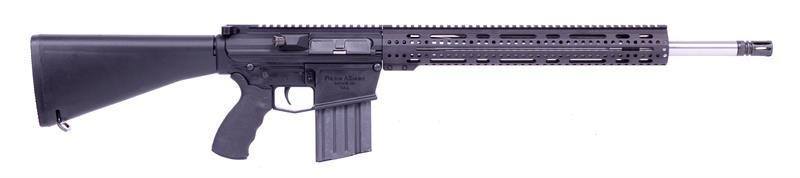

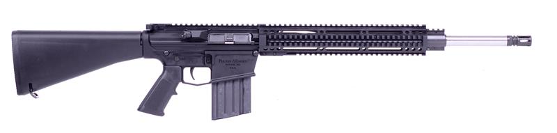

98Z5V Posted August 4, 2018 Report Share Posted August 4, 2018 (edited) 1 hour ago, JKN said: My preference would be piece by piece unless I can save money by starting from a complete rifle. I have a start on a prospective parts list with a few parts missing or questionable. List those parts, if you will, please. We can collectively go over it. Right now, with the A1 stock requirement - no manufacturer can fulfill your need. Nobody puts anything out anymore with an A1. Ah, I forgot one. Fulton Armory. They make almost exactly what you're looking for, and it's already got a good 2-stage trigger, non-adjustable, set to 4.5 lbs. Pick the M110 model if you want a full quad rail, or pick the Guardian model if you only want a continuous top pic rail. Match barrel with hybrid chamber in both, and that's a damn, damn fine barrel from Fulton Armory. You cannot piece something together like this for the $1500-ish they're asking for it. Check 'em: http://www.fulton-armory.com/fariflecal556mmupruniversalprecisionrifle-3-4-2-1-1-2-1-2-2-1-4-2-5-5.aspx http://www.fulton-armory.com/fariflecal556mmupruniversalprecisionrifle-3-4-2-1-1-2-1-2-2-1-4-2-5-2-1.aspx *** That $1500-ish price I stated is because they're both on sale right now, for the exact same price... Lesson 65b - you snooze, you lose. Edited August 4, 2018 by 98Z5V Quote Link to comment Share on other sites More sharing options...
