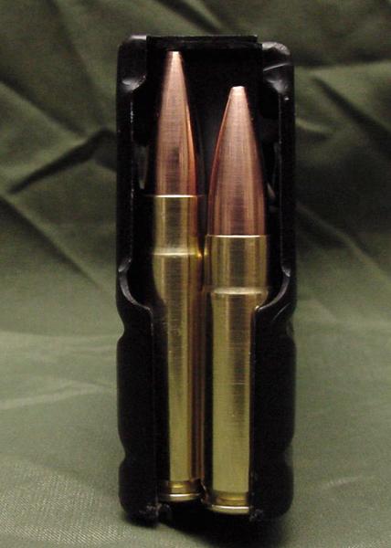

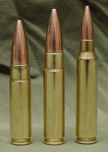

I may be wrong, but what I understand about this .300 Blackout round is it's a combination of the best things about a .30 Cal bullet from a 5.56 case.
Not sure on this, but I think the .300 Whisper is a 7.62 x 33 case (not sure on that case length).
The traditional 7.62 x 39 is the Russian round -and the actual diameter of that .30 Cal bullet is .311, not a .308 like we are used to using as a ".30 Cal bullet."
The 7.62 x 39 USA round is a traditional .30 Cal round, in .308.  Case is an upsized .5.56 case with a 39mm length.
There is a 7.62 x 40 out there, as a 5.56 gun wildcat round.
The Blackout round is a 7.62 x 35 case (upsized 5.56 case) and used a .308 bullet.  Suppposedly, this case length is the magic - you can still load .308 bullets to 5.56 mag length, and it maximizes what you can load for a powder charge.  It doesn't have the case taper of a 7.62 x 39 round, so it feeds fine from USGI mags (and varients).
