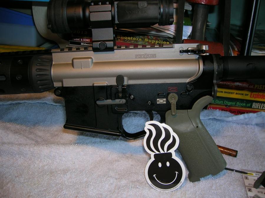

survivalshop Posted April 19, 2014 Report Posted April 19, 2014 (edited) I have a POF upper that is NIB ,but lower is not & a NIB charging handle also , but has a std Phosphate BCG . If your bolt isn't NIB , you can have it coated , but I would re-check head space because they can get a little tight with any coating , should be fine though. Shadow Ops Weaponry has NIB coated BCG's also . I have one now in my 16" 308AR & its seems to easier to wipe down then the DPMS Chrome one that was in before. If you want the full effect of the NIB coating , any part that can cause friction ,upon any part , would be coated & that would include the inside of the receiver extension & buffer . Edited April 19, 2014 by survivalshop
