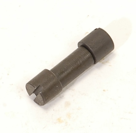

bobk538447 Posted June 23, 2017 Report Share Posted June 23, 2017 (edited) If anyone is wanting to know how to mate the larger hole DPMS upper with the small hole AR lower take down pins on the POF receiver, the solution looks like it can be solved with a couple of "Colt Receiver Adapter Offset Bushing". For the younger guys Colt AR-15s use to have two different size pivot pins. If you look how the upper mates with the lower you can see that the holes appear slightly offset. I found some online for $3.50 a piece which is pretty cheap. When I get hem in I will let everyone know how well they work. Hopefully, this will help the guys who bought stripped POF lowers. Edited June 23, 2017 by bobk538447 grammer Quote Link to comment Share on other sites More sharing options...

98Z5V Posted June 24, 2017 Report Share Posted June 24, 2017 4 hours ago, bobk538447 said: If anyone is wanting to know how to mate the larger hole DPMS upper with the small hole AR lower take down pins on the POF receiver, the solution looks like it can be solved with a couple of "Colt Receiver Adapter Offset Bushing". For the younger guys Colt AR-15s use to have two different size pivot pins. I hope they work, because that's AR15 shiit, right there. Those bushings and adapters work for the AR15 pin sizes of 0.154" (small pin) and 0.169" (Colt large pin, with a bore of 0.170" that they go into). I don't think that's gonna work on large frame ARs, because the pins sizes are already larger than that. Also, Colt did that to confirm that no "unauthorized" uppers and lowers were mated together, as a ban-move. That's the only reason they made the large-pin receivers, and they were the only company to do it. The Colt large pin receivers were made between 1990 and 2009. Quote Link to comment Share on other sites More sharing options...

bobk538447 Posted July 8, 2018 Author Report Share Posted July 8, 2018 My project has been sitting for awhile between work and other things. The colt receiver adapter bushings were too big for the DMPS upper receiver holes. I didn't want to mess up the lower receiver and plan on getting a different upper receiver later on anyways.. I took the plunge and drilled the front upper receiver hole out with a 5/16" drill bit half way from both sided. The bushing slide in nicely. The upper receiver is tight to the lower receiver with no slop. Quote Link to comment Share on other sites More sharing options...
