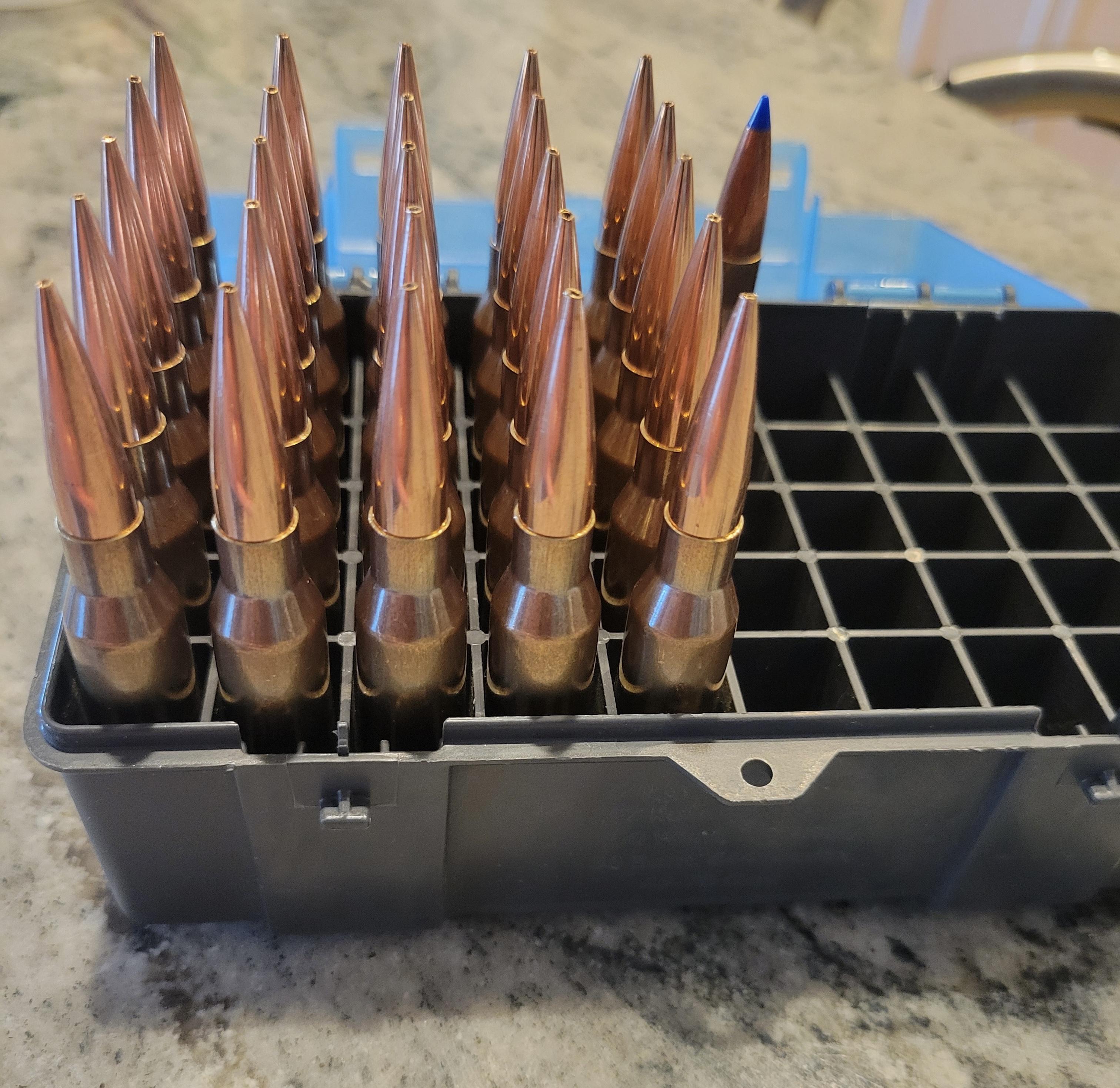

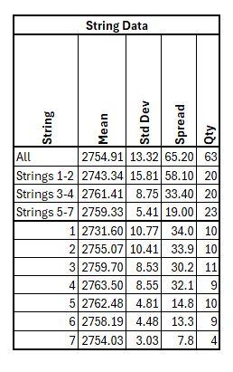

BigNate Posted July 5 Author Report Share Posted July 5 (edited) Well - loaded up 25 rounds for the ladder. I’m a nerd so I started at the recommended starting load and increased by one grain until I got closer to where I think the real work will start. I modeled it in GRT and built out loads that take me through what GRT thinks will produce max pressure loads (about 60,800PSI). Hoping to shoot in the AM. We’ll see if, and if - then what, i need to tear down… These are the Berger 300gr OTM Hybrid bullets, on Retumbo, with 215M primers in Lapua brass. I did nothing to the new brass other than prime them. I loaded to CBTO that should put the bullet 0.020 off the lands. This resulted in a COAL of about 3.8” so they’ll be getting single loaded. Interestingly, the magazine is stamped 3.80 but these are just a touch longer than will load in the magazine… The cartridge with the blue tip in the picture is a factory round that a buddy gave me a while ago when I was looking for a .338 bullet for something I was doing around the 8.6. I’m going to fire it and then thread the case to use with the Hornady OAL length gauge (as opposed to the unfired spec case that I used for the first pass). I didn’t want to sacrifice one of the new Lapua cases - and I’m guessing that for that purpose - it’ll be better than the unfired case. If that’s wrong - let me know. Interestingly - when I look closely at the bullet tips in the picture, they look mangled… I can’t see that much of it on the bullets themselves unless I put on a magnifying lens. I’m not worried about it for load ladder testing - but now I’m reading up on how this gets managed - for future efforts. Edited July 5 by BigNate Quote Link to comment Share on other sites More sharing options...
sketch Posted July 6 Report Share Posted July 6 That is weird the tips do look deformed in the pic? Maybe they are factory 2nds? Quote Link to comment Share on other sites More sharing options...
98Z5V Posted July 6 Report Share Posted July 6 Depends on the seating die... Quote Link to comment Share on other sites More sharing options...
BigNate Posted July 7 Author Report Share Posted July 7 On 7/5/2025 at 10:21 PM, sketch said: That is weird the tips do look deformed in the pic? Maybe they are factory 2nds? I noticed that as well. They are Berger 300s from Midway - not listed as 2nds. I'll take a few bullets out of the box and take pictures of them before being loaded. On 7/5/2025 at 11:41 PM, 98Z5V said: Depends on the seating die... The only precision die I could find that was not backordered was a Hornady set. I picked up the seating stem for the 338 300gr ATip bullets which I understood should work for the 300gr Bergers. I found this thread this morning - https://www.longrangehunting.com/threads/berger-vld-seating-stems.298097/ I'll pull the stem tonight and look at how the bullet sits in the stem. For these first rounds I'm not super worried about it - as "most" of what I'm worried about with these is MV and pressure testing. Quote Link to comment Share on other sites More sharing options...
Magwa Posted July 23 Report Share Posted July 23 So how goes the battle I too have found that some of my tips seem crooked or slightly mangled but it seems NOT to make a difference... i guess I could buy a bullet pointer.. Quote Link to comment Share on other sites More sharing options...

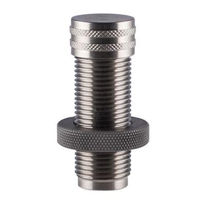

BigNate Posted July 25 Author Report Share Posted July 25 (edited) On 7/23/2025 at 6:42 AM, Magwa said: So how goes the battle I too have found that some of my tips seem crooked or slightly mangled but it seems NOT to make a difference... i guess I could buy a bullet pointer.. I bought the Frankford Arsenal Universal seating set that I've seen lots of positive stuff about relative to VLD bullets in 338 LM stuff... It's still in the box - but will get set up and tried out this weekend. FWIW - the seating stem I used for the first batch is the one that Hornady sells for their 300gr A-Tip match bullets. I guess the Bergers must get fat just a bit later. Edited July 25 by BigNate Quote Link to comment Share on other sites More sharing options...

BigNate Posted August 7 Author Report Share Posted August 7 On 6/25/2025 at 5:49 AM, Magwa said: don't forget about your neck sizing mandrel it is one of the most important steps, setting neck tension, for me this was the single most improvement to lowSD and ES. As I have mentioned before I do Not use the decapping pin and ball that comes on the sizing die.. I take them out and use a large decapping die so my case neck does not get continually stretch back and forth. and after you fire the new cases you will have to bump your shoulder on the sizing die approx.2 thousands for the cases there is a ton of hands on work in this game but it is worth every step. @Magwa Do you mind telling me which die and mandrel you use? I've found Wilson, Short Action Customs, K&M Precision, Cortina, RCBS, and others - and it looks like the systems are proprietary and once I pick one, I'm going to be buying from them for a while. I hadn't worried about this part to this point because I've been loading new brass - but the day is coming soon... so I need to get something bought. Quote Link to comment Share on other sites More sharing options...
Magwa Posted August 8 Report Share Posted August 8 16 hours ago, BigNate said: @Magwa Do you mind telling me which die and mandrel you use? I've found Wilson, Short Action Customs, K&M Precision, Cortina, RCBS, and others - and it looks like the systems are proprietary and once I pick one, I'm going to be buying from them for a while. I hadn't worried about this part to this point because I've been loading new brass - but the day is coming soon... so I need to get something bought. I use a Wilson neck sizing mandrel and then i have bought a mandrel for all the calibers i reload for and don't forget to use dry graphite on the inside of the case mouth before using the mandrel just appy a very small amount with a q tip dipped in the graphite then shake out the excess and apply. Quote Link to comment Share on other sites More sharing options...
BigNate Posted August 8 Author Report Share Posted August 8 35 minutes ago, Magwa said: I use a Wilson neck sizing mandrel and then i have bought a mandrel for all the calibers i reload for and don't forget to use dry graphite on the inside of the case mouth before using the mandrel just appy a very small amount with a q tip dipped in the graphite then shake out the excess and apply. This guy - right? https://lewilson.com/wilson-expanding-mandrel-die?srsltid=AfmBOoqt6NdvYY1S0dw5XyO4T_v4gMitjrqlVFp-k2RqnfS1jjJTMm2Q Quote Link to comment Share on other sites More sharing options...
Magwa Posted August 9 Report Share Posted August 9 my bad I said wilson I just looked it is Sinclair so it could be like this one or you could get the Cortina one it is the same as the one i use, the mandrels for the sinclair are like the same as Cortina ones I do not know anything about the wilson but I am sure they all do the same thing... Quote Link to comment Share on other sites More sharing options...
BigNate Posted Wednesday at 07:06 PM Author Report Share Posted Wednesday at 07:06 PM (edited) On 8/9/2025 at 6:16 AM, Magwa said: my bad I said wilson I just looked it is Sinclair so it could be like this one or you could get the Cortina one it is the same as the one i use, the mandrels for the sinclair are like the same as Cortina ones I do not know anything about the wilson but I am sure they all do the same thing... Thanks @Magwa Ironically - Wilson was going to take too long and my local reloader supply shop had one (I think Sinclair - looks pretty much like that) so I picked one up. So - did the following: 1) Cleaned cases, deprimed, cleaned inside of neck with a nylon brush 2) Lubed case with my standard case lube, bumped shoulder and used a bushing that would resize the neck to give about 0.003" neck tension 3) Cleaned cases to remove case lube 4) Lubed inside case neck with graphite 5) Resized the neck with an expander mandrel give 0.002" neck tension 6) Relube the neck and seat bullets to 0.020 from the lands (didn't have time to do the seating depth ladder - so I crossed my fingers and went with 0.020) I got 63 of them through the gun before I ran out of time. These were rounds 51 through 114 through the gun. I was shooting strings of about 10 shots at about 60-90 second splits before letting the barrel cool off for a bit. Early in the day it was cold out and it warmed up substantially later in the day - this accounts for the change in velocity after string 1. What surprised me was the narrowing of the SD and ES. The change from string 1 and 2 to 3 and 4 was not anything I can tie to any change in what I was doing. The change from string 4 to 5 and beyond is at least in part a function of me changing my practice in that I had been inconsistent in when I chambered the round - sometimes chambering the round immediately then getting on target and settling in. This resulted in some situations in which the round spent more time sucking heat out of the chamber and heating up the powder. This changed to "lay the round on top of the magazine, settle in behind the gun, get on target, send the bolt home, and begin trigger pressure. I'm guessing that this accounted for the significant improvement in SD and ES seen at string 5 and later. I'm grasping at straws for what caused the improvement between string 2 and 3-4. One of the other shooters suggested that this could simply be a function of the barrel coming into its own and getting properly fouled - but? Thoughts? Regardless - if I'm able to consistently produce single digit SDs, particularly if I'm able to keep those numbers down around 5fps, I'm pretty happy. Edited Wednesday at 07:19 PM by BigNate Quote Link to comment Share on other sites More sharing options...
