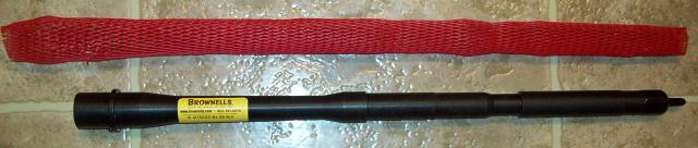

imschur Posted October 20, 2012 Report Posted October 20, 2012 In addition to the 308 AR barrels I listed elsewhere they also have 300 Blackout barrels. Brownells is including a tech sheet from the manufacturer
imschur Posted October 20, 2012 Author Report Posted October 20, 2012 now that's funny. I hope it's made as well as it appears in the images.
98Z5V Posted October 20, 2012 Report Posted October 20, 2012 We shall find out, brother. Soon.This is going to be one expensive build. It's been in my head for a long time now.
98Z5V Posted October 28, 2012 Report Posted October 28, 2012 The barrel arrived a few days ago, but I've been too busy here to get pics and post them. I blame Greg - he's "time consuming..." <laughs> <lmao>I like the "Reservoir Tip" they use as a thread protector - nice touch. <thumbsup>This is one very nice barrel - gas port diameter is 0.098", for informational purposes.
