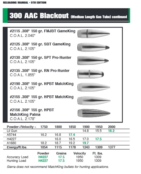

98Z5V Posted March 13, 2014 Report Share Posted March 13, 2014 Don't like what I saw from them on the H110 and 300BLK with 150gr projectiles. I'm shooting 16.5 grains of H110, and they're saying the maximum is 16.2 grains. Need to load up some at the lesser charge and see how they do. <dontknow> Quote Link to comment Share on other sites More sharing options...
shibiwan Posted March 13, 2014 Report Share Posted March 13, 2014 (edited) Looks high. Been studying the loads before I put together some subsonics. Hornady manual for 300 AAC 150/155gr using H110 fps load (gr) 1500 12.3 1600 13.5 1700 14.7 1800 15.9 (max) Nosler loads for 300 AAC 140gr using H110 fps load (gr) density 1786 14.0 88% 1800 15.0 94% 1977 16.0 (max) 100% Edited March 13, 2014 by shibiwan Quote Link to comment Share on other sites More sharing options...

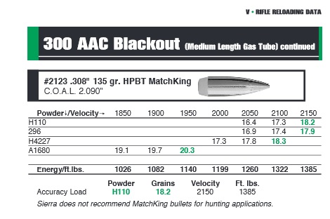

98Z5V Posted March 13, 2014 Report Share Posted March 13, 2014 Sierra's data is different again, from that ^^^. Sierra doesn't list H110 for the 150s, they stop at the 135s with it. They run the LilGun in both though. Quote Link to comment Share on other sites More sharing options...
shibiwan Posted March 13, 2014 Report Share Posted March 13, 2014 (edited) Yep... I have the sierra data too. Wonder why they skip the H110. Well only way to find out is to start messing around. I got 2 lbs of AA1680 and another 2 lbs of AA5744. That should load up a ton of 300 BLK. LilGun is "one step" slower than H110 on the burn rate charts and the load on the hornady manual goes up to 17.0gr (max) @ 1900 fps Edited March 13, 2014 by shibiwan Quote Link to comment Share on other sites More sharing options...
