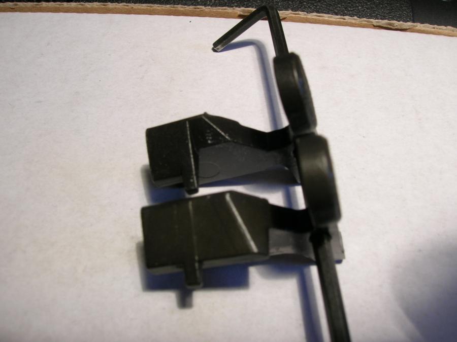

survivalshop Posted January 14, 2015 Report Share Posted January 14, 2015 Do you have a 308 specific Bolt Catch ? The Magazine's follower is what pushes up the Bolt Catch to stop or hold the bolt . If you remove the Magazine , it may not hold the BCG if an AR 15 Catch was used. Need 308 Buffer & spring , as has been said . The difference . Quote Link to comment Share on other sites More sharing options...
392heminut Posted January 14, 2015 Report Share Posted January 14, 2015 I don't think the bolt catch is his problem, it was working fine before he changed the buffer and charging handle. My money is on the buffer being an AR-15 buffer and the bolt catch is now catching on the front edge of the bolt carrier instead of the front of the bolt. Quote Link to comment Share on other sites More sharing options...
survivalshop Posted January 14, 2015 Report Share Posted January 14, 2015 (edited) I don't think the bolt catch is his problem, it was working fine before he changed the buffer and charging handle. My money is on the buffer being an AR-15 buffer and the bolt catch is now catching on the front edge of the bolt carrier instead of the front of the bolt. You could be right , that is the wrong Buffer , but when I see std Bolt catch , makes me wonder . It doesn't say if he built this rifle or was a factory built . Even if Factory built , you never know . The AR 15 Bolt Catch in a 308 format will also drop the BCG in the same manner as he is describing , even with the correct Buffer & spring . <dontknow> Edited January 14, 2015 by survivalshop Quote Link to comment Share on other sites More sharing options...

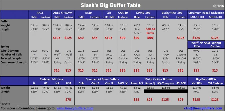

survivalshop Posted January 14, 2015 Report Share Posted January 14, 2015 (edited) This may help you in the future , from Heavy Buffers web sight . Edited January 14, 2015 by survivalshop Quote Link to comment Share on other sites More sharing options...
WD40Dawson Posted January 14, 2015 Author Report Share Posted January 14, 2015 That makes sense! The Spikes heavy buffer i bought was about an inch and a half longer than the buffer that came out of my Ar10. Quote Link to comment Share on other sites More sharing options...
