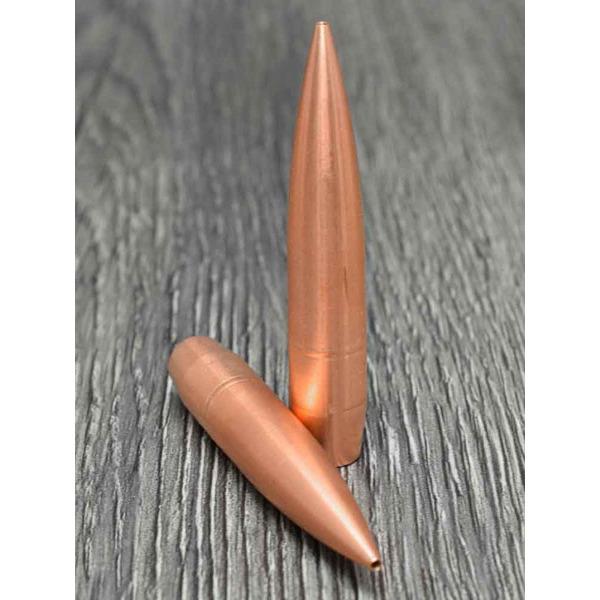

98Z5V Posted May 5, 2025 Author Report Share Posted May 5, 2025 Well shiit, look at this. 340gr Cutting Edge projos in .358... https://www.grafs.com/retail/catalog/product/productId/98463 Quote Link to comment Share on other sites More sharing options...

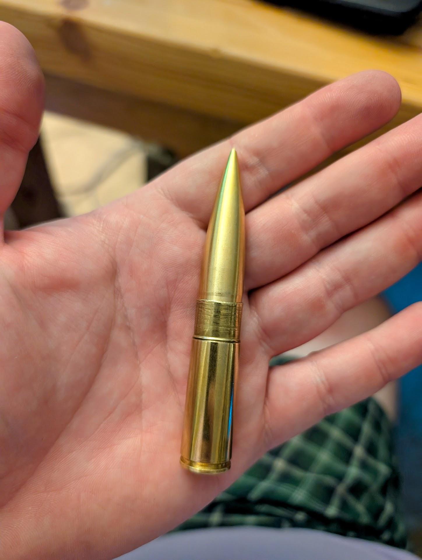

BigNate Posted June 20, 2025 Report Share Posted June 20, 2025 (edited) On 5/4/2025 at 8:02 PM, 98Z5V said: 500 Blackout is alive, and runs. We have the gun down here in AZ, with 2 barrels. Load development has been going on for years. We need a chamber redesign to go further. It shoot 911 grain projectiles, subsonic, past 1k yards. This post is not a joke... 510 Whisper with 800gr Lapua Bullex-N (not mine - sadly - pic from a guy in one of the 8.6 groups I'm part of)... Edited June 20, 2025 by BigNate Quote Link to comment Share on other sites More sharing options...
