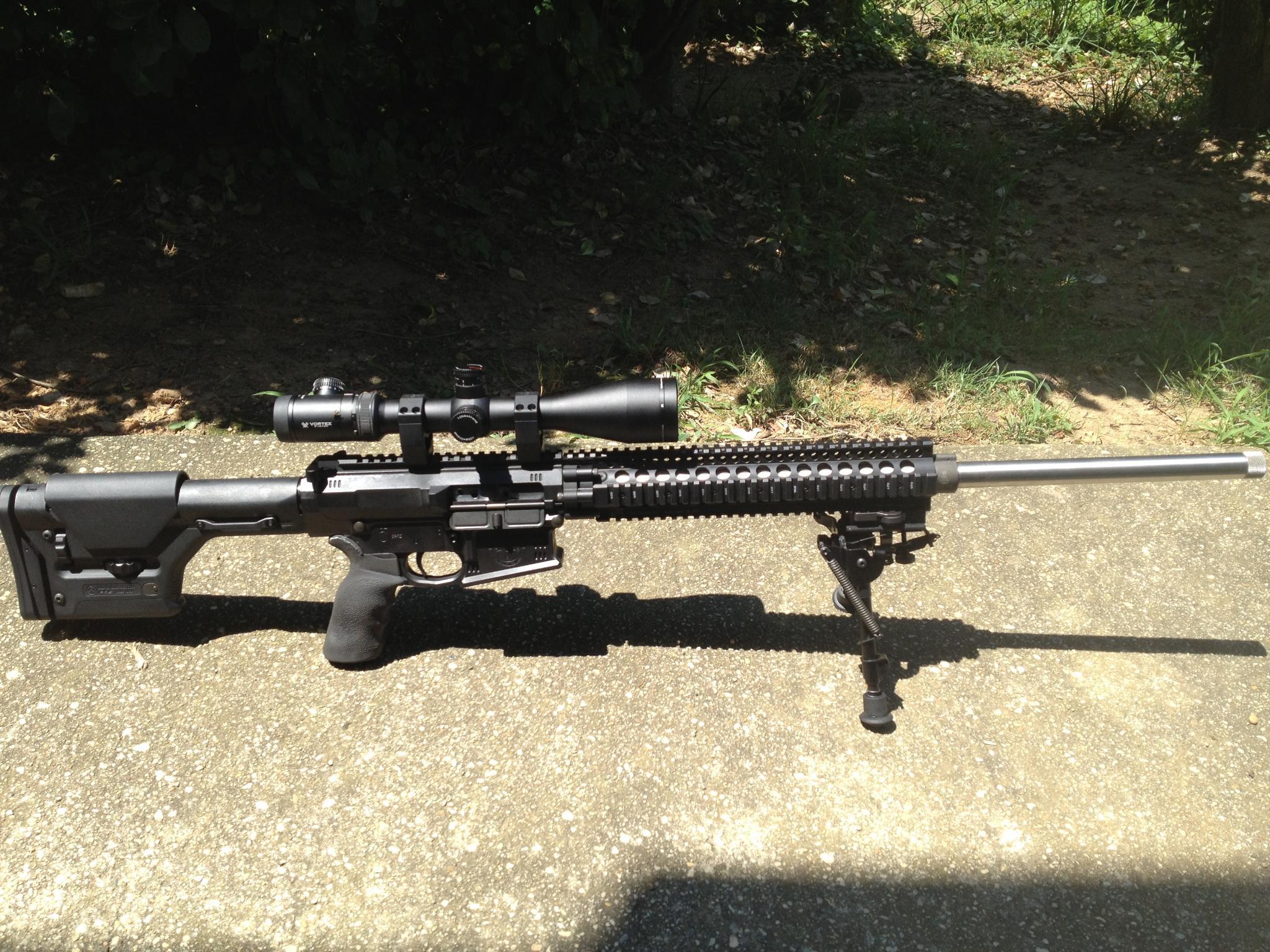

EdMP3006 Posted July 21 Report Posted July 21 Hey fellas, I've finally gotten to the point where I'm actually going to start loading...(finally, after years) and the last piece of the puzzle is which powder to finally decide on. I've got 1k primed Lake City, pulled but never fired brass cases and Hornady 178gr ELD-X pills......I was leaning towards either StaBALL Match or Varget, but would really like to hear if anyone has used a similar mix of load components... Main purpose of the rifle with mainly be comps and maybe some hunting with it, unless I decide to build something on the smaller platform... Included older pic of the build, currently doesn't have an optic on it, trying to decide between the 2 that I have...

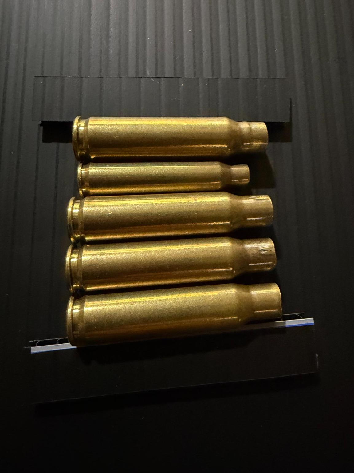

EdMP3006 Posted Friday at 04:28 PM Author Report Posted Friday at 04:28 PM Just finished measuring the entire bag of 1k rounds of brass and only had 5 cull pieces, one was a definite and the others had issues... Just scored the Garmin Xero C1 chrono on sale for $100 off too....
