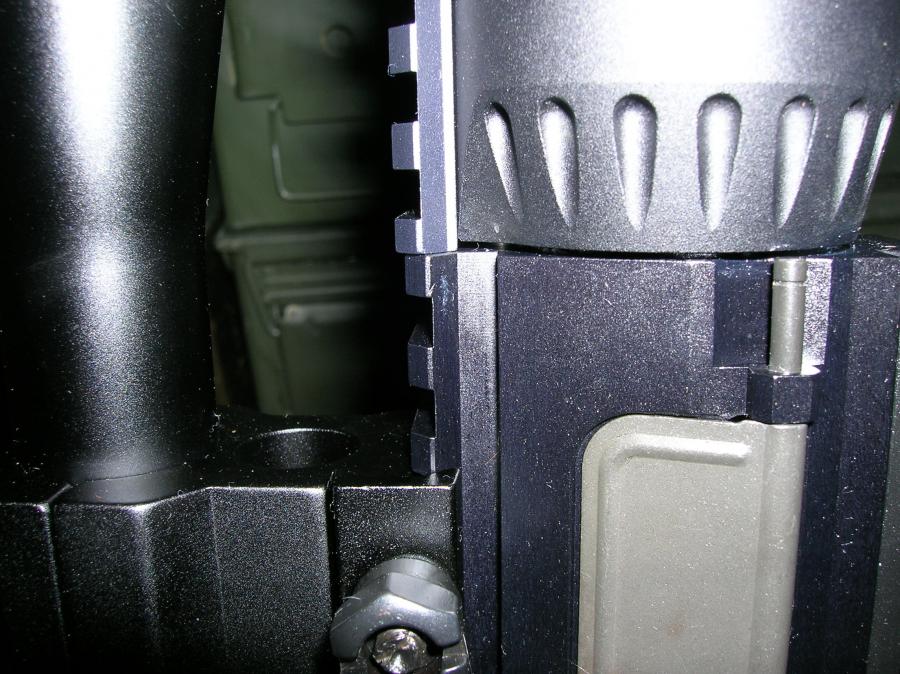

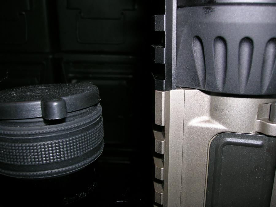

rmart Posted February 12, 2014 Report Share Posted February 12, 2014 I have a brand new upper for my DPMS 308 AR. (yay me) It's a DPMS upper receiver (low profile) with a DEZ national match 18" barrel, ICE Arms BCG, JP Enterprises modular handguard, and Troy muzzle brake. All in all it's a very nice package but I find a problem... The handguard by JP Enterprises allows for the addition of a rail on top for sights and accessories. I purchased said rail and attempted to install it on the handguard only to find that it sits about 1/16" higher than the rail on the upper receiver. What is wrong with DPMS that they make their uppers with a proprietary dimension, and what's up with JP Enterprises that after what, five years? they don't make a compatible rail and handguard for the DPMS uppers? Whether or not DPMS is the best .308 AR out there, they're certainly the most common and one would think they'd have an option to fit the DPMS uppers. Grrr... Well, rant over; what can I do to fix this problem other than spend $500 on a different upper receiver and installation, or tossing my now $400 handguard setup and putting something else on? I looked at possibly sanding that approximately 1/16" of an inch off the bottom of the rail but the underside is curved to match the handguard, and the mounting slots would disappear if I did so. Am I really up the creek here? R Quote Link to comment Share on other sites More sharing options...
shibiwan Posted February 12, 2014 Report Share Posted February 12, 2014 You found out the hard way that there are two DPMS 308 upper profiles. The newer low profile uppers were designed so that the rail height would be the same as an AR15, which makes more aftermarket bits exchange a little easier. Every other manufacturer making 308 uppers have stuck to the "high profile" design. Honestly, I think they messed it up... to make matters worse there's the new DPMS GII pattern (this makes it pattern #3) to add to the confusion. Quote Link to comment Share on other sites More sharing options...

rmart Posted February 13, 2014 Author Report Share Posted February 13, 2014 (edited) All right, here's an option... I was speaking with Dave at JP and he suggested something interesting. I don't know where to find one, nor do I even know what you would call it but, an option to address my problem might be this: I'm envisioning something like a gas block with a rail on top, maybe 1 to 1.5" long. This would clamp over the barrel just forward of the handguard and just behind the flash hider. Not a gas block as I have one already, tucked inside the handguard but something like it. I wonder if a gas block could be employed in this manner... The barrel O.D. mics out at around .740 which would be around the fluted area. Just forward of the fluted area and just behind the flash hider is a slightly smaller area approximately 5/8" long. Does anyone have any ideas that might fill this need? Thanks, R Edit: I'm thinking adding a gas block forward of the handguard might be my only real option. I'll then have to get a gas block height front sight. I'm partial to Midwest Industries sights. Anyone have a suggested part number for the appropriate gas block for the low profile upper? Edited February 13, 2014 by rmart Quote Link to comment Share on other sites More sharing options...
shibiwan Posted February 14, 2014 Report Share Posted February 14, 2014 How about a railed gas block like this? If you're using the lo-pro DPMS receiver, any AR15-spec railed gas block should work. Sounds like your barrel has a 0.75" gas block journal. I have this on the beater: Or you something like this: Strongly recommend the steel or stainless steel setscrew styles, avoid the clamped on ones. Quote Link to comment Share on other sites More sharing options...
