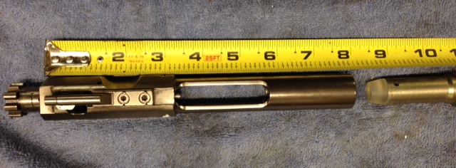

ironmonster Posted April 10, 2015 Author Report Share Posted April 10, 2015 (edited) You can clearly see the difference in the 5.56 Tubbs spring and the .308 Tubbs spring Spacer I machined How far the carrier goes in with the spacer in place If you look really close you can see the buffer retainer pin does not come in contact with the buffer when the upper is mostly closed Edited April 10, 2015 by ironmonster Quote Link to comment Share on other sites More sharing options...

Toolndie7 Posted April 10, 2015 Report Share Posted April 10, 2015 (edited) Ironmonster, any chance you can get that tube in one more turn? That's a 16 threads per inch thread size if I remember right, if that's the case you would be crashing by 1/16" maybe you could measure your dent in the receiver and see if it's about that depth? I'm just trying to think simple. Edited April 10, 2015 by Toolndie7 Quote Link to comment Share on other sites More sharing options...
ironmonster Posted April 10, 2015 Author Report Share Posted April 10, 2015 I can't see how that would matter as it is already hitting the buffer tube in the fire control area, the operating length won't change even if the tube is turned in one revolution Quote Link to comment Share on other sites More sharing options...

washguy Posted April 10, 2015 Report Share Posted April 10, 2015 (edited) Iron so lets start from the obvious here are pics of my carrier and then the opening diameter from inside the buffer tube at the mouth and then the carrier shoulder which prolly is causing the damage you there on the measurements with yours? the easiest way is to put a plain ol buffer tube on with a car308 buffer and a car308 spring ....if that doesnt work....you got bigger probs :) Wash Edited April 10, 2015 by washguy Quote Link to comment Share on other sites More sharing options...
ironmonster Posted April 10, 2015 Author Report Share Posted April 10, 2015 Well, the O.D. Of the carrier does not matter as long as the I.D. Of the buffer tube is sufficent that there is clearance, it does. The cross section of the sectional change in the carrier does not matter because no matter what size it is it's still not going in the buffer tube. The only measurements that I could see are relevant is from the rear of the carrier to the sectional change in the carrier, the depth of the buffer tube, the compressed thickness of the buffer spring and lenght of the buffer itself Quote Link to comment Share on other sites More sharing options...

washguy Posted April 10, 2015 Report Share Posted April 10, 2015 (edited) On 4/10/2015 at 5:51 PM, ironmonster said: Well, the O.D. Of the carrier does not matter as long as the I.D. Of the buffer tube is sufficent that there is clearance, it does. The cross section of the sectional change in the carrier does not matter because no matter what size it is it's still not going in the buffer tube. The only measurements that I could see are relevant is from the rear of the carrier to the sectional change in the carrier, the depth of the buffer tube, the compressed thickness of the buffer spring and lenght of the buffer itself Exactly ....the carrier is going too far back and the shoulder is smacking it....spend 30 bucks on a buffer tube/spring to get it going...and if that doesnt work you got lower problemos...I love Tubbs have some of them...but then again all my $hit works from the get go :) Wash Edited April 10, 2015 by washguy Quote Link to comment Share on other sites More sharing options...
ironmonster Posted April 10, 2015 Author Report Share Posted April 10, 2015 Other than changing out the Tubbs spring changing the rest of it would have no effect, the only way the spring could have any effect is if it's collapsed hight was thicker thus limiting the carrier movement but that would just mean everything was collapsing to a dead stop, still a crash and not the intent of the system(is it?) I can't imagine the goal is to collapse the spring 100% so the carrier crashes to a dead stop at the end of the stroke. I need a heavier buffer, a stronger spring or less gas, the spacer I put in the buffer tube makes it impossible for the carrier to contact the buffer tube boss. The other thing is this buffer tube is not coming out, ever. After the damage done to the end it's going to damage the receiver and probably destroy the tube as well. Since it will work as it is and they both may be junk if I try and tear them apart it seems smart to just deal with it as is. Quote Link to comment Share on other sites More sharing options...
