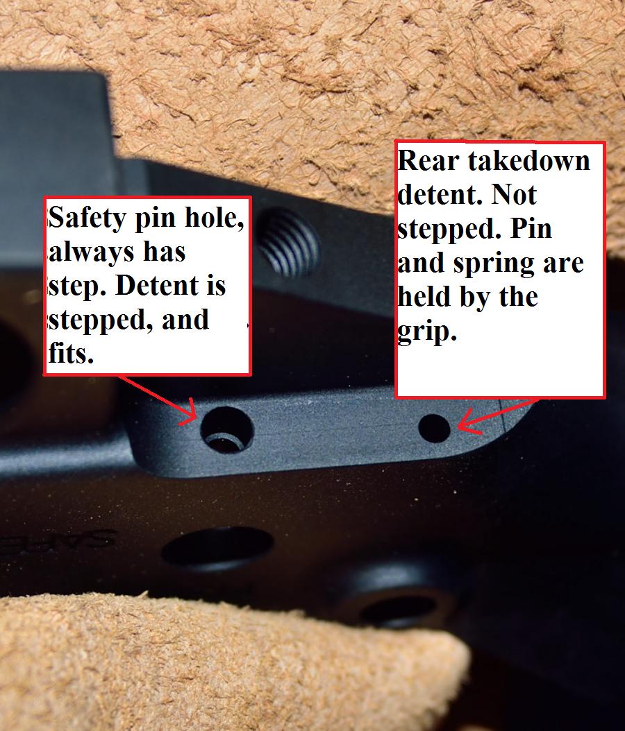

taffrail Posted June 19, 2015 Report Share Posted June 19, 2015 Received my Matrix upper/lower combo from Chris Riedeman today. Found some surprises. Possibly not for you. 1. Under the rear take down pin is what appears to be a captive detent. 2. The two holes under where the grip goes are not the same size. At least not at the surface. .Appears to be about 1/8th" and then steps down. 3. If someone will tell me how, I will ad pictures. Quote Link to comment Share on other sites More sharing options...

taffrail Posted June 20, 2015 Report Share Posted June 20, 2015 (edited) Ok. Pictures. Maybe..... Yep. Thanks to survivalshop. A true gentleman. Update. This captive detent is centered on the rear take down pin upper flange or whatever you call the thing with the hole in it and be nice for goodness sake. We are out of our teens....yes? ??? Edited June 20, 2015 by taffrail Quote Link to comment Share on other sites More sharing options...

AngelDeVille Posted June 20, 2015 Report Share Posted June 20, 2015 He did mention some upgrades in the future, that must be it. Quote Link to comment Share on other sites More sharing options...
ChaseFan9 Posted June 20, 2015 Author Report Share Posted June 20, 2015 I was wondering when they were gonna move that schit. That solves one issue, anyways. Hey taff, he sent you a lpk, too, right? What does the bolt catch look like? Can you post some pics? BTW, seems like that captive detent in the fcg pocket keeps tension on the rear takedown pin, but it definitely keeps the fit between the receivers tight and play to a minimum. Quote Link to comment Share on other sites More sharing options...
taffrail Posted June 20, 2015 Report Share Posted June 20, 2015 Thanks Dews. One more thing. I have a takedown pin detent hole from the grip and from the rear. I either get to use both or likely get to pick. Depending on what comes in my LPK, I think I'll pick the rear. Time will tell. Quote Link to comment Share on other sites More sharing options...
98Z5V Posted June 21, 2015 Report Share Posted June 21, 2015 Go from the grip area for that, or you'll have to cut a section of coathanger, piano wire, etc., in order to use that rear entry, and make up the space... Someone mentioned a coathanger earlier - that would have to be a small wire diameter damn coathanger... Quote Link to comment Share on other sites More sharing options...
ChaseFan9 Posted June 21, 2015 Author Report Share Posted June 21, 2015 The only one I had that was small enough was just skinny enough to slide in with zero play. That being said, I second going up through the grip, that way you'll have proper tension on the detent spring. Quote Link to comment Share on other sites More sharing options...
