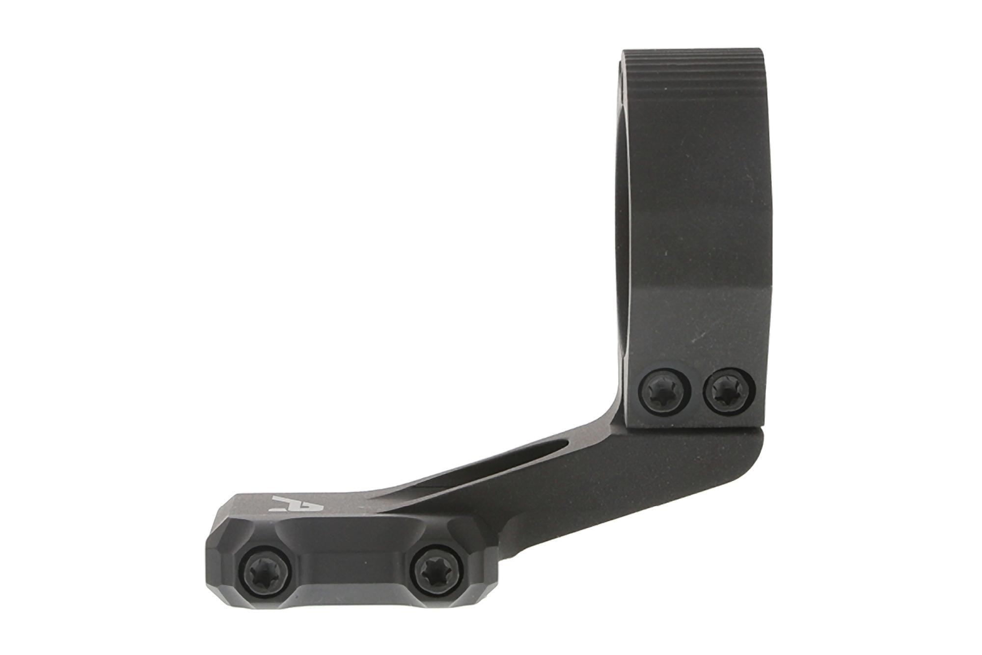

98Z5V Posted June 18, 2017 Author Report Share Posted June 18, 2017 (edited) The re-release of the original Primary Arms red dot - it's a direct clone of the Aimpoint Comp M2. They just updated it and released it again. http://www.primaryarms.com/pa30mmrd-ad It's in an Aimpoint QRP mount, but I'll end up mounting it in the Aero Precision 30mm red dot mount. Edited June 18, 2017 by 98Z5V Quote Link to comment Share on other sites More sharing options...
