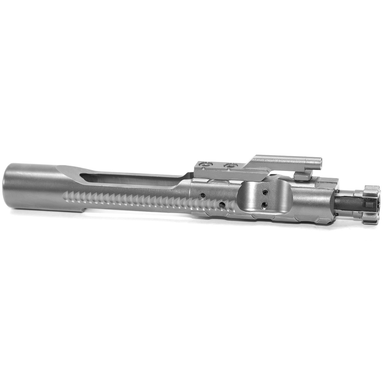

98Z5V Posted December 8, 2017 Report Posted December 8, 2017 (edited) On 12/7/2017 at 3:27 AM, mineralman55 said: like what? Right off the bat, I think of the DS Arms "Sand Cut" BCG. I picked up one of those not long ago, and it's pretty damn nice. I can see how their "sand cuts" would actually help, and give the BCG room to clear out debris - but you'd have to be in a shooting environment where you'd get that "debris" in there to see the real benefit. https://www.dsarms.com/p-16061-dsa-ar15-m16-cut-ntfe-coated-sand-cut-enhanced-bolt-carrier-group.aspx Second, is the wave of 5.56 BCG with flat sides - reduces friction with the upper, because it's not a round BCG in a round upper channel. I first saw these from ARES Armor (the Reduced Friction BCG) back when, and I have several of them. They're DAMN nice BCGs. They're still out there, by different manufacturers now. Edited December 8, 2017 by 98Z5V

Bryan Hoover Posted December 9, 2017 Report Posted December 9, 2017 Anyone have experience with this one?
