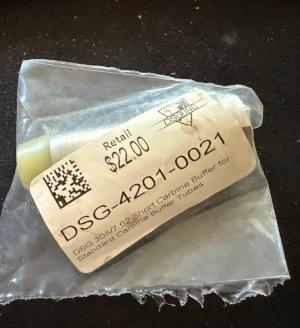

willbird Posted June 28, 2025 Report Share Posted June 28, 2025 (edited) I also have this 3.6oz buffer NIW and thought about giving it a try with the BCA BCG. The BCA BCG and my Toolcraft BCG that runs and locks back on empty both weigh the same. Edited June 28, 2025 by willbird Quote Link to comment Share on other sites More sharing options...
98Z5V Posted June 28, 2025 Report Share Posted June 28, 2025 9 hours ago, willbird said: I also have this 3.6oz buffer NIW and thought about giving it a try with the BCA BCG. The BCA BCG and my Toolcraft BCG that runs and locks back on empty both weigh the same. Damn, I miss that company. I wish DSG was still around. That's a great buffer, Bill. Stainless body, and filled with 2 steel weights. You can change those weights out for tungsten weights, and make that buffer 5+ ounces, easy peasy. It's a roll-pin punch away. I've only used one of those buffer bodies, as a test, in my first .260 Rem gun, but I've recommended it many times - when DSG was around. I ran it just to prove the short recoil system. 2 tungstens in it made it 5.15oz, and it functions that gun just fine. Quote Link to comment Share on other sites More sharing options...
willbird Posted June 29, 2025 Report Share Posted June 29, 2025 5 hours ago, 98Z5V said: Damn, I miss that company. I wish DSG was still around. That's a great buffer, Bill. Stainless body, and filled with 2 steel weights. You can change those weights out for tungsten weights, and make that buffer 5+ ounces, easy peasy. It's a roll-pin punch away. I've only used one of those buffer bodies, as a test, in my first .260 Rem gun, but I've recommended it many times - when DSG was around. I ran it just to prove the short recoil system. 2 tungstens in it made it 5.15oz, and it functions that gun just fine. I think I have one that I tungstened up, but thinking to try it in this case as is and see if bolt locks back with the BCA BCG, run some rounds that way to let it break in a bit. Quote Link to comment Share on other sites More sharing options...
