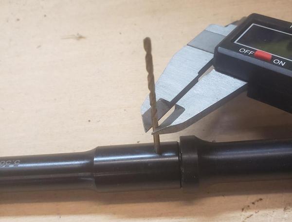

shooterrex Posted August 4, 2025 Report Share Posted August 4, 2025 If you do a search here for Daytona Tactical you will find problems with their products. Read the waterboarding thread and get us the measurements we need to help you. You didn't need to build it to measure things. What spring did you use with the buffer you bought from Clint? Off the top of my head. 1 soak your bolt carrier group in Mobile One motor oil. 2 Get a set of numbered drill bits and remove the gas block and tell us what size the gas port is. Quote Link to comment Share on other sites More sharing options...

98Z5V Posted August 5, 2025 Report Share Posted August 5, 2025 (edited) 7 hours ago, Jephthah said: Aloha, I have a .308 Buffer Spring (11 1/16'') and a CAR-10XH Buffer weight (6.61 oz.) from Clint for my 7'' Buffer tube. Thanks I will look into measuring next... That will be a legit Recoil System. The focus will need to be on the Gas System, the barrel specs= gas block journal diameter, gas port diameter in your barrel, plus the gas tube length. Edited August 5, 2025 by 98Z5V Quote Link to comment Share on other sites More sharing options...

shooterrex Posted August 6, 2025 Report Share Posted August 6, 2025 What probably happens is the heavier bullets are in the barrel just a fraction of a second longer. Allowing the amount of gas going back to the bolt carrier group to be enough. Letting the rifle cycle. Amazon has Numbered drill bit sets. Also get a caliper to measure the drill bits. Remove the gas block. Which drill bit just fits? Which drill bit is just a fraction to large? That tells you about the size of your gas port. Use the shank of the drill bit not the pointed end to measure. How many rounds do you have through this rifle? The bolt carrier group may not be broken in yet. Did you soak the BCG in Mobile One overnight? Quote Link to comment Share on other sites More sharing options...
Jeff300 Posted August 6, 2025 Report Share Posted August 6, 2025 this is what @shooterrex mentions to do with the drill bit, it is also in the link @98Z5V sent you waterboarding. That link has a ton of great info in it. Quote Link to comment Share on other sites More sharing options...
98Z5V Posted August 7, 2025 Report Share Posted August 7, 2025 22 hours ago, Jephthah said: I do not have the wherewithal to successfully undertake the gas port system evaluation and R+R . 9 hours ago, Jeff300 said: this is what @shooterrex mentions to do with the drill bit, it is also in the link @98Z5V sent you waterboarding. That link has a ton of great info in it. `Correct. This thread explains all about it, and it's why I recommended you read it in the first place. If you're a good carpenter - measuring isn't new to you. For this, you just need different tools. Harbor Freight digital calipers and drill bit are perfectly fine, to get to the conclusion. Here's why all this shiit really matters: You've just been given a plethora of information - I suggest you read it. It explains all of what's has been discussed. ALL of it. Quote Link to comment Share on other sites More sharing options...
