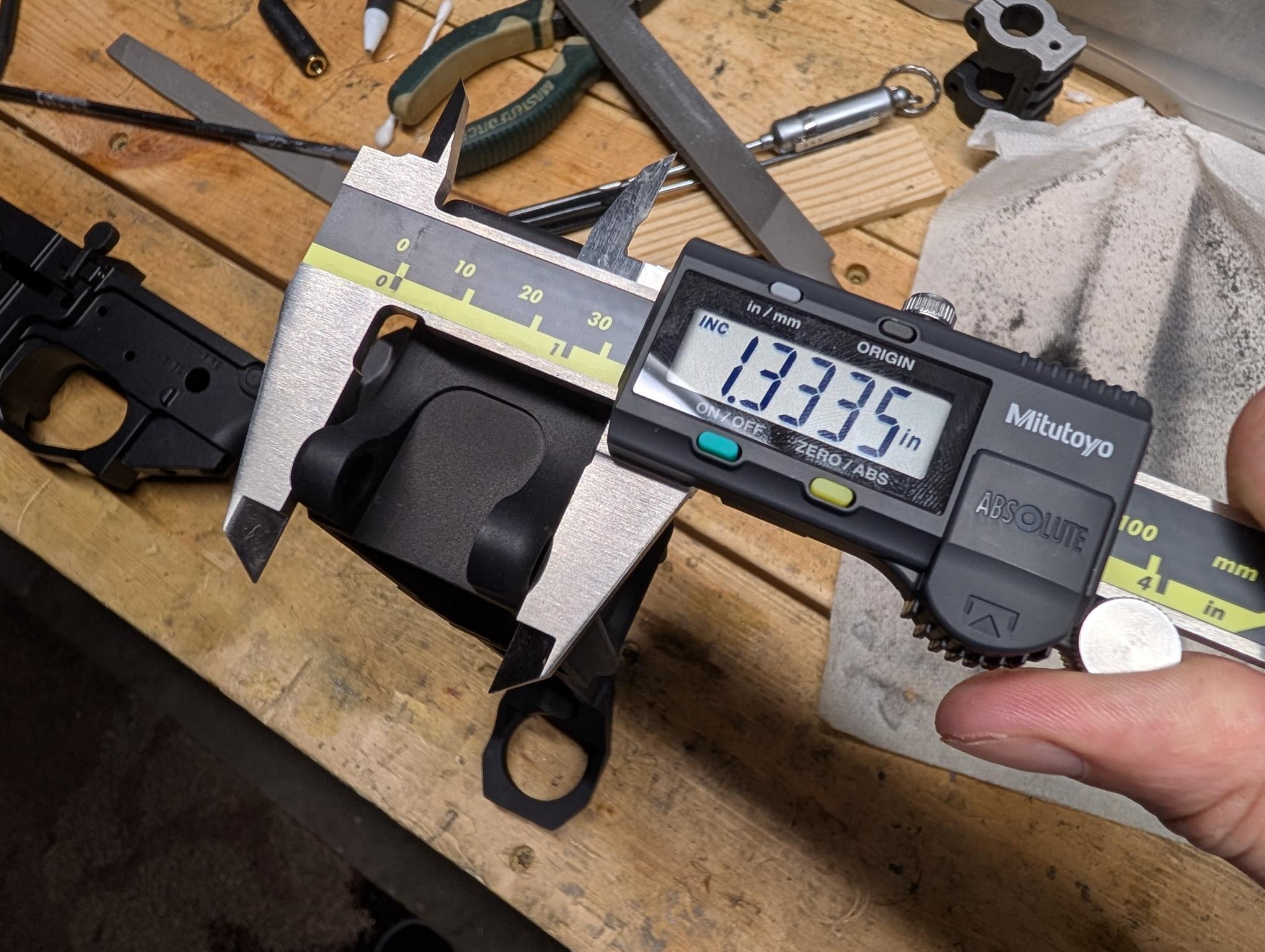

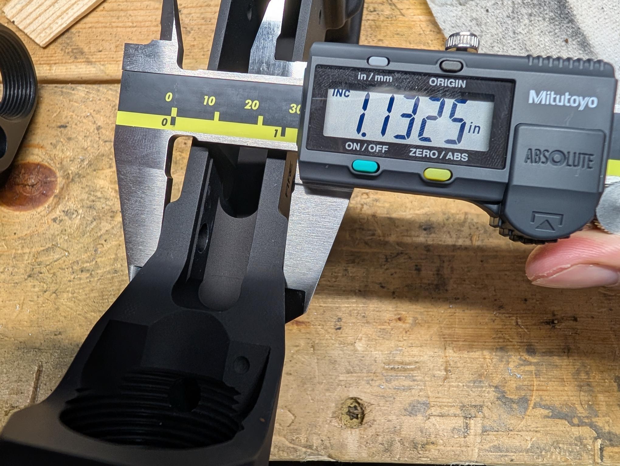

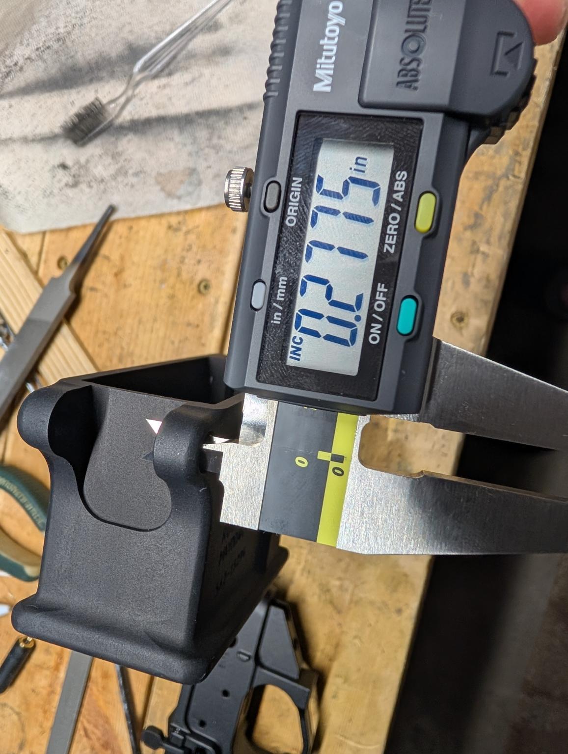

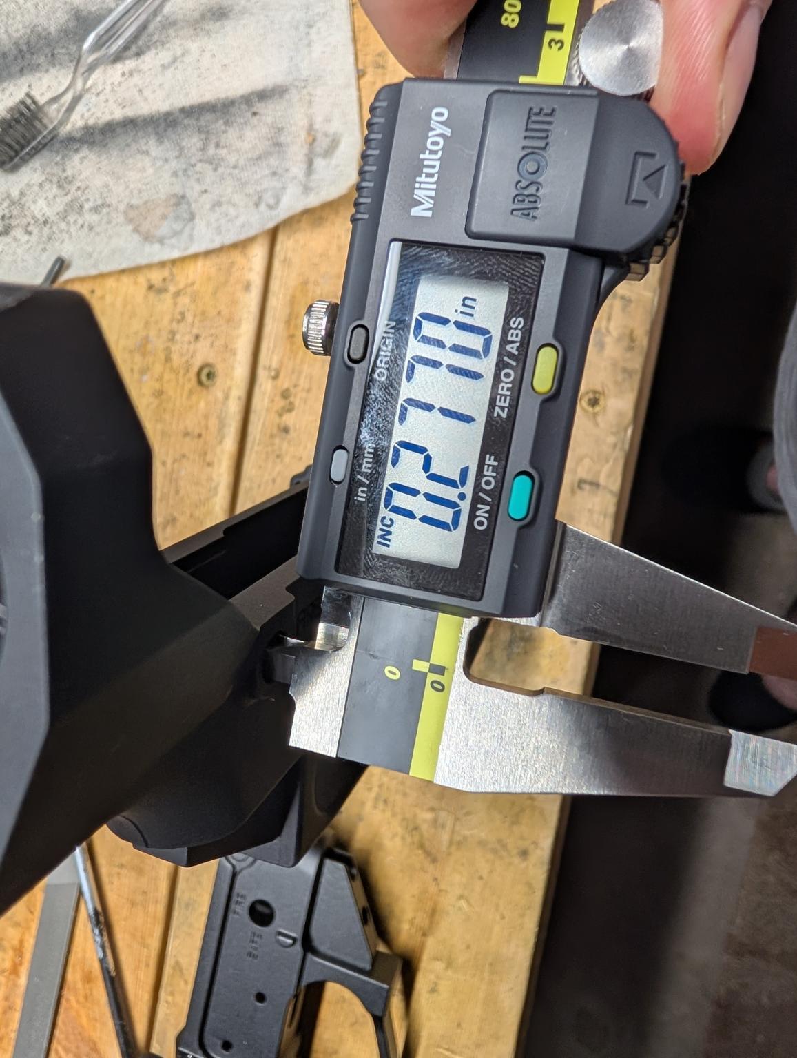

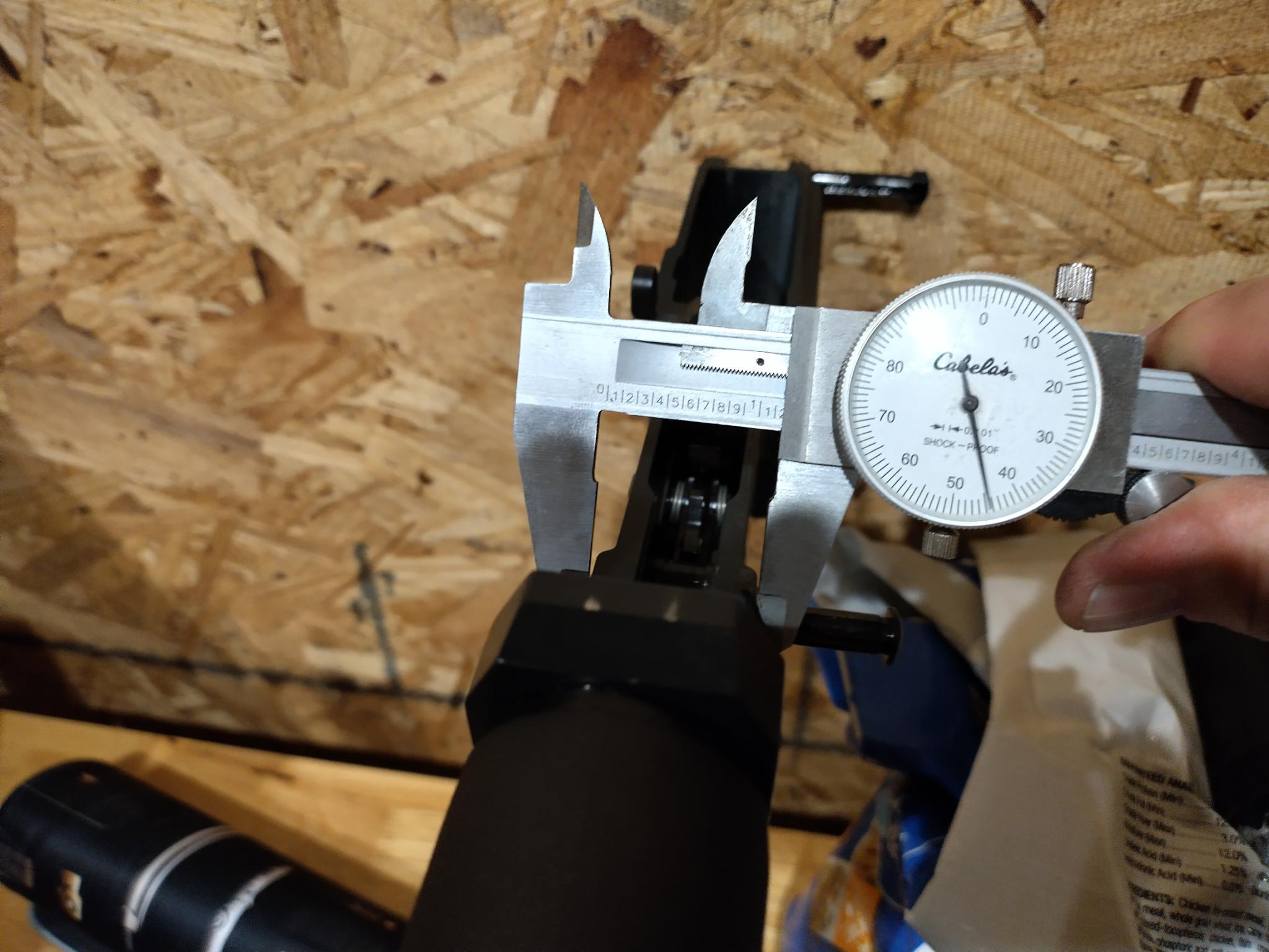

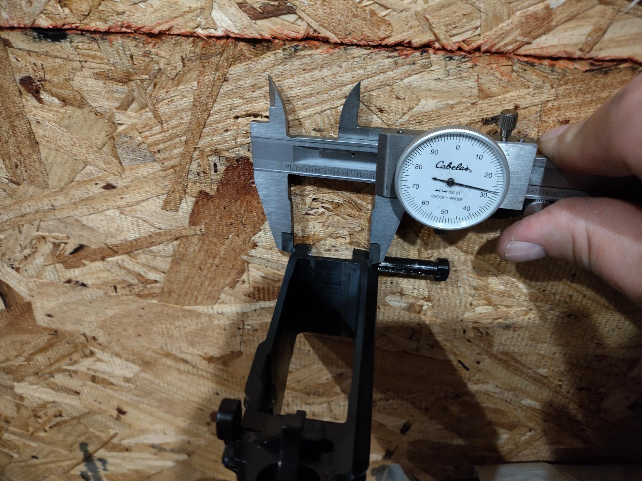

Got some measurements in. Won't be able to take a pin gauge to the holes to confirm the caliper measurement until next week, but I'm pretty confident in these measurements.
  • Takedown/pivot pin hole: .2770/.2775
  • Receiver width at the pivot pin hole: 1.3335
  • Receiver width at takedown pin hole: 1.1325

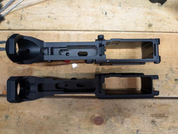

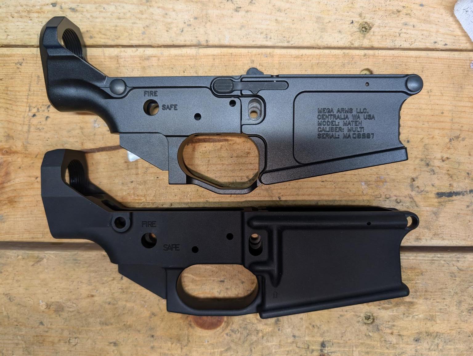

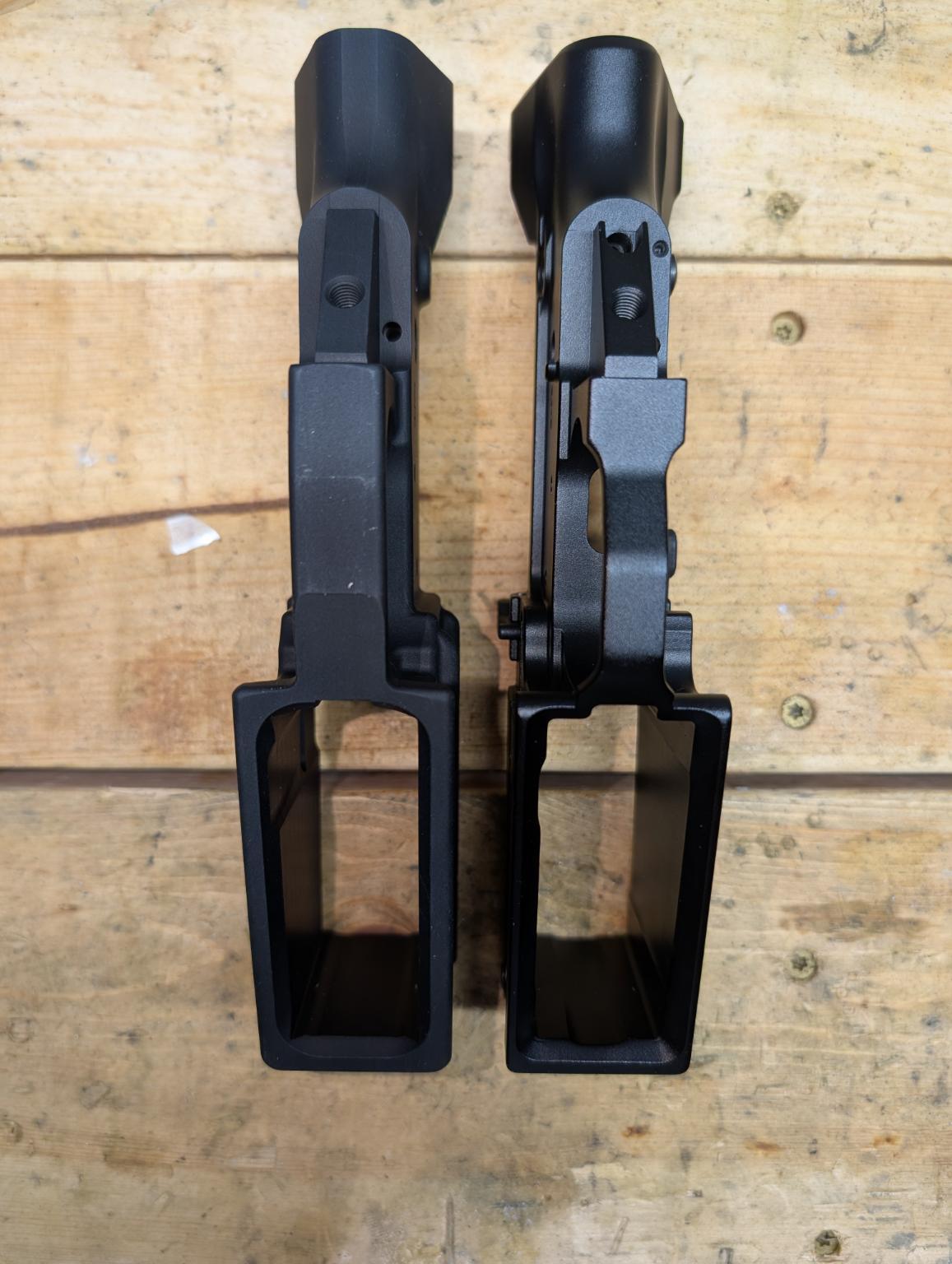

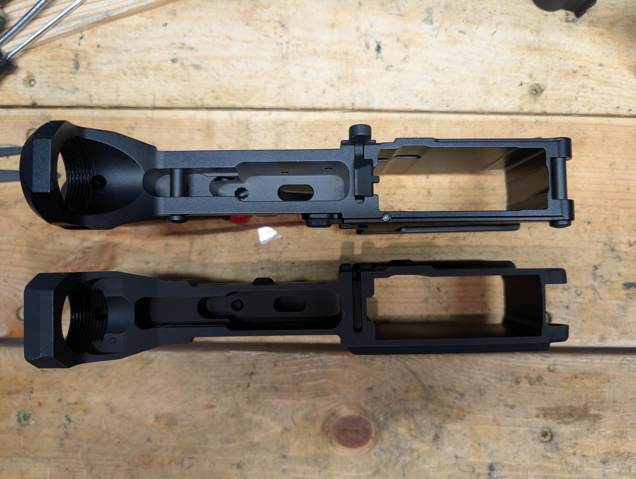

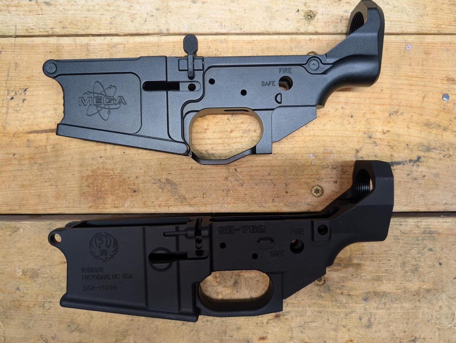

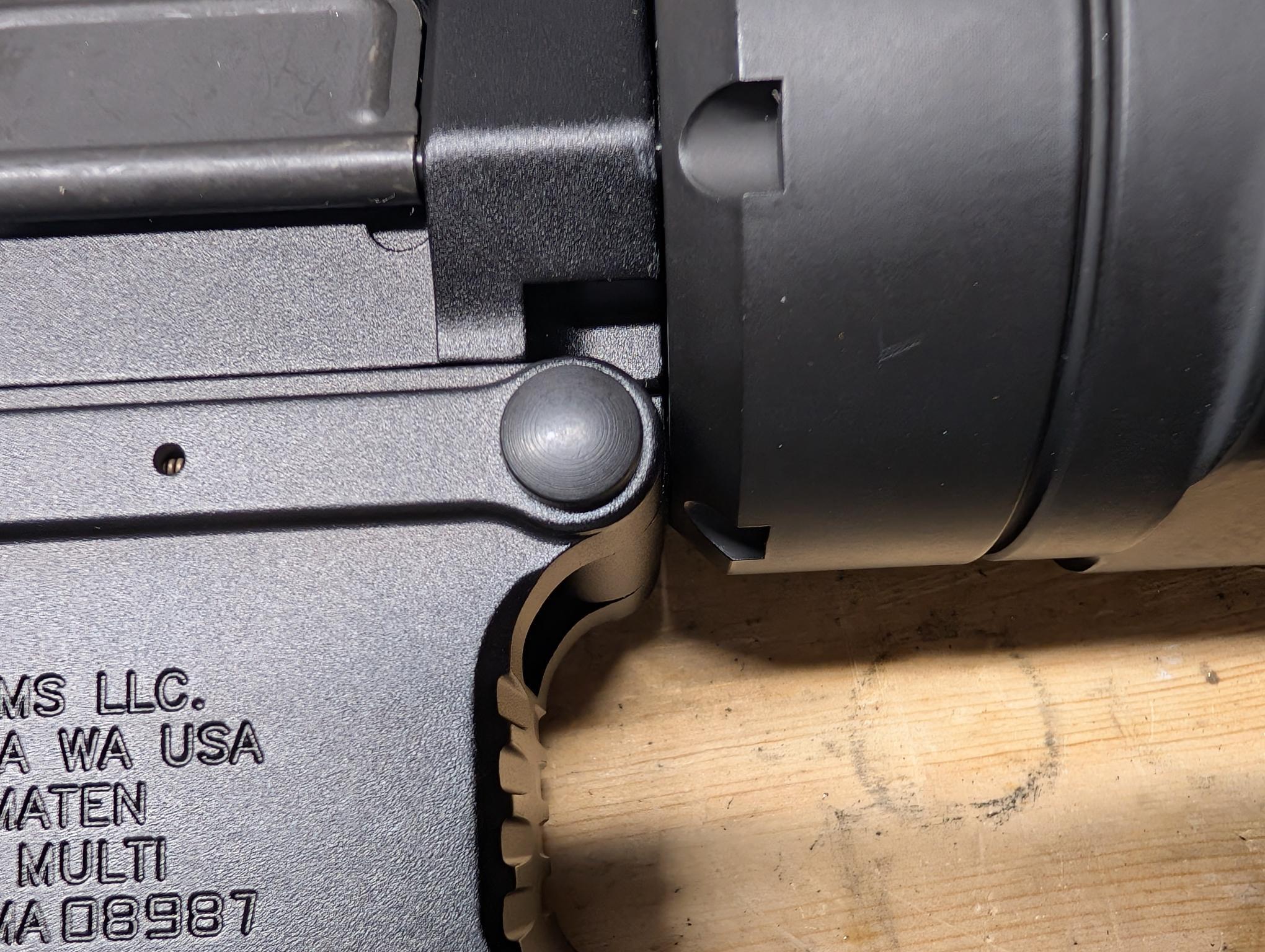

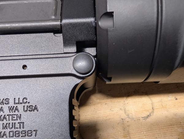

For s&gs and comparison's sake I took some pics of it next to my Mega lower:
From the information I have that points to an Armalite pattern lower parts kit... which Armalite doesn't sell direct anymore.
Any guidance on where to find one, at least the pins, is most appreciated.
I have BAD Enhanced pins in my Aero M5 7mm-08 gun.  The diameter works for what you listed, but the Aero M5 receiver has difference widths across the hole.
Pivot pin area width on the M5 = 1.550"
Takedown area width on the M5 is 1.0335"

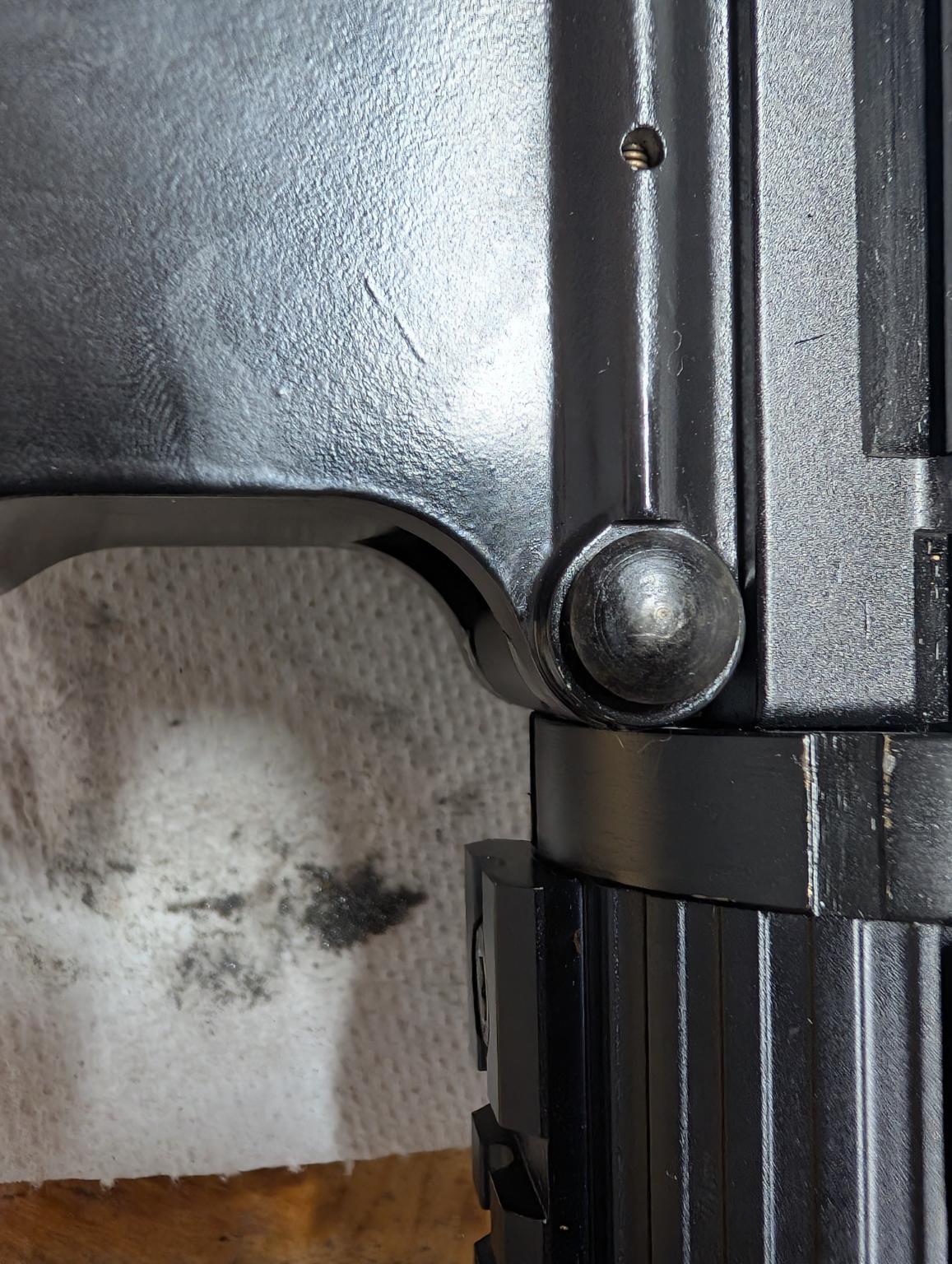

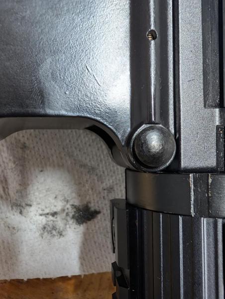

I wouldn't mind protrusion, but on closer inspection the Ruger pivot pin is flattened on one side of the head just like the Armalite pins, so I don't think the BAD pins would fit regardless. I think between Numrich and EGP I should be able to piece together a mostly correct small parts kit.
Just to confirm, I got my pin gauges from the shop and both receivers measured at a snug .277.
All pivot pins have the flat on them, including the BAD pins.  It's a mandatory part of the design. A pivot pin that had a fully round head wouldn't work on any AR.
I should be able to get away with using a DPMS barrel in the DB10 upper even with Armalite threads as long as I also use a DPMS bolt that headspaces properly.
This is correct.  For proof of that concept, I have an Aero M5 receiver set and rail that was intentionally built with an Armalite AR-10 barrel, AR-10 BCG, and AR-10 Carbine recoil system. Runs like a Singer sewing machine. Almost all of my Large Frame ARs run the AR-10 Carbine recoil system, FWIW.
Almost every DPMS parts kit I've used has fully round headed pivot pins- CMMG and LUTH-AR parts kits, and the pins that come with MATEN receivers all use fully round headed pivot pins. The Panther LR-308 that I used to own had a fully round headed pivot pin. The stock photos for the BAD pins on their website also show fully round headed pivot pins, so I'm not sure where you get that statement.
Yep, you're right.  I just checked all 12 Large Frames that I've built, and they're all round pivot pin heads.  I'm thinking about AR15 parts without checking Large Frames, apparently.  That's a fukked up thing for Ruger to do.
If it was me, with that receiver, I'd cut the pin.
Gonna be a tough hunt  Good luck.

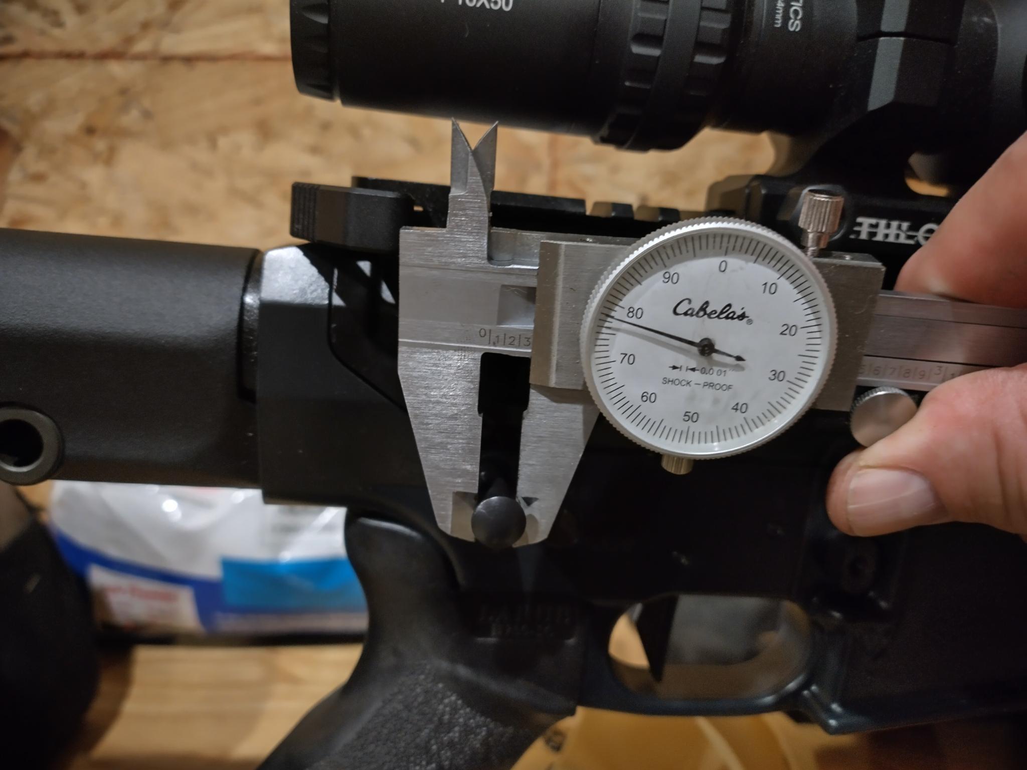

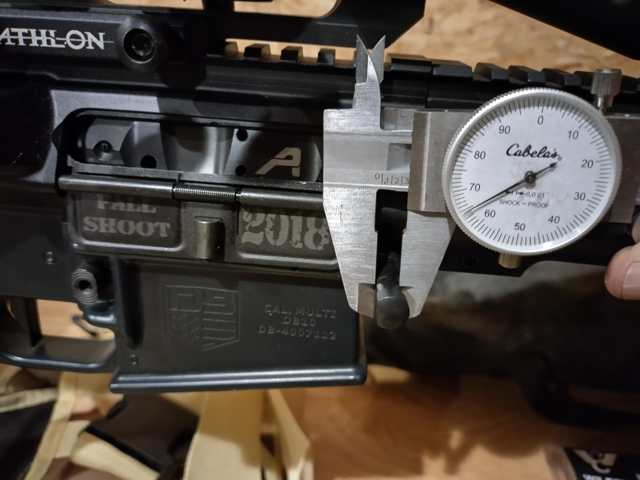

This is Diamondback pin information
Pivot pin diameter...0.264
With a $2000 dust cover in the picture. @JBMatt 🤑
Takedown pin diameter...0.277
Receiver width at pivot pin... 1.327
Receiver width at takedown pin...1.144
