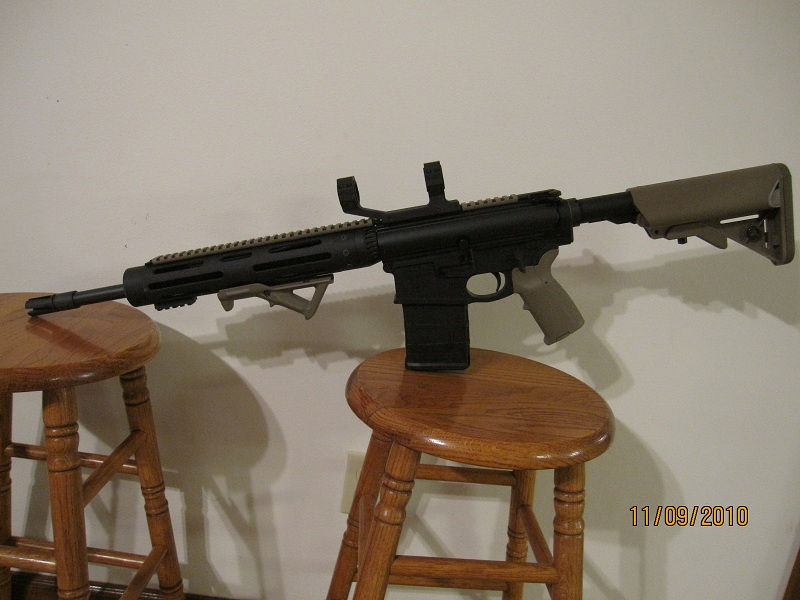

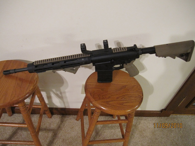

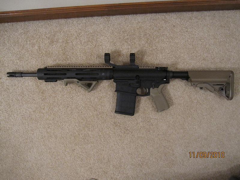

TacBlade Posted November 10, 2010 Report Share Posted November 10, 2010 I just finished this up. Got my scope mount today and only need to get a scope to finish it up. Had a few problems with extracting, but it all cleared up after 40 rounds. I just pointed it down range to test fire for function. I could list out all I have on it, but I will just let you ask questions if you want to. The inside has a JP Bolt and Carrrier and a buffer and spring from HeavyBuffers.com. Have a good one!!! Sorry about the terrible pics, but I am working on getting a setup for the proper lighting to take some better ones. <thumbsup> Quote Link to comment Share on other sites More sharing options...

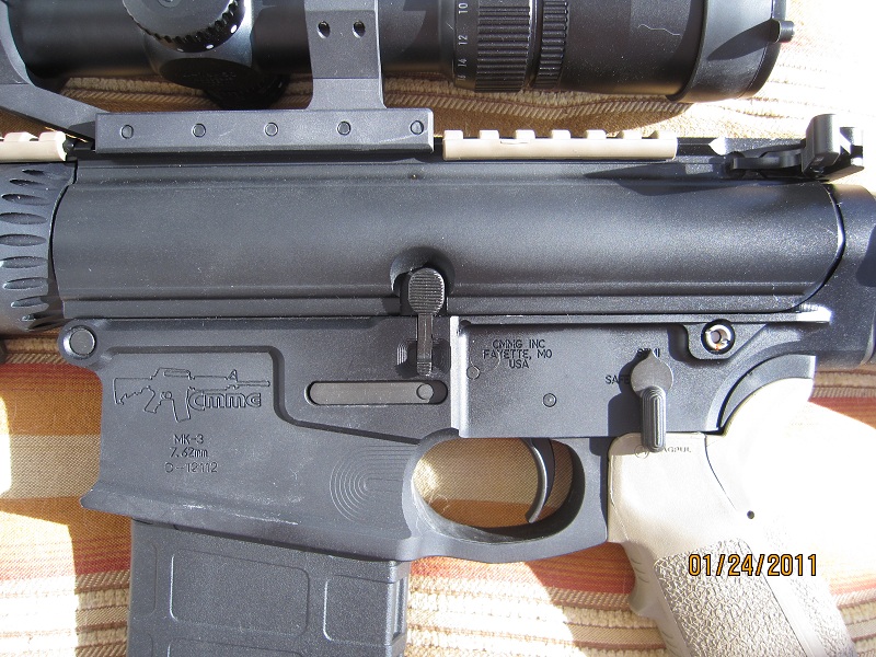

L8model Posted January 24, 2011 Report Share Posted January 24, 2011 TacBlade - Could I talk you into taking a couple close-up pictures of the upper & lower assembly? I've got a CMMG MK-3 lower & I was hoping to see how it looks with the DPMS upper, as I'm thinking of going that direction with mine. ;)Also, I've got a DPMS .308 LR parts kit... Will everything in that kit work on my CMMG lower, does anybody know?Thanks! Quote Link to comment Share on other sites More sharing options...
TacBlade Posted January 24, 2011 Author Report Share Posted January 24, 2011 I used the DPMS parts kit in mine and everything work good!!! There was some play between the upper and lower, so I used a JP tension pin to tighten it up and make it solid. Quote Link to comment Share on other sites More sharing options...

L8model Posted January 25, 2011 Report Share Posted January 25, 2011 Quote I used the DPMS parts kit in mine and everything work good!!! There was some play between the upper and lower, so I used a JP tension pin to tighten it up and make it solid.Perfect!!! That was EXACTLY what I was looking to see. I may need to order one of the JP tension pins when I decide to order an upper...Thanks! <thumbsup> Quote Link to comment Share on other sites More sharing options...
TacBlade Posted January 25, 2011 Author Report Share Posted January 25, 2011 The JP tension pin makes the feel of the rifle a whole lot better without that little bit of wobble. Quote Link to comment Share on other sites More sharing options...
