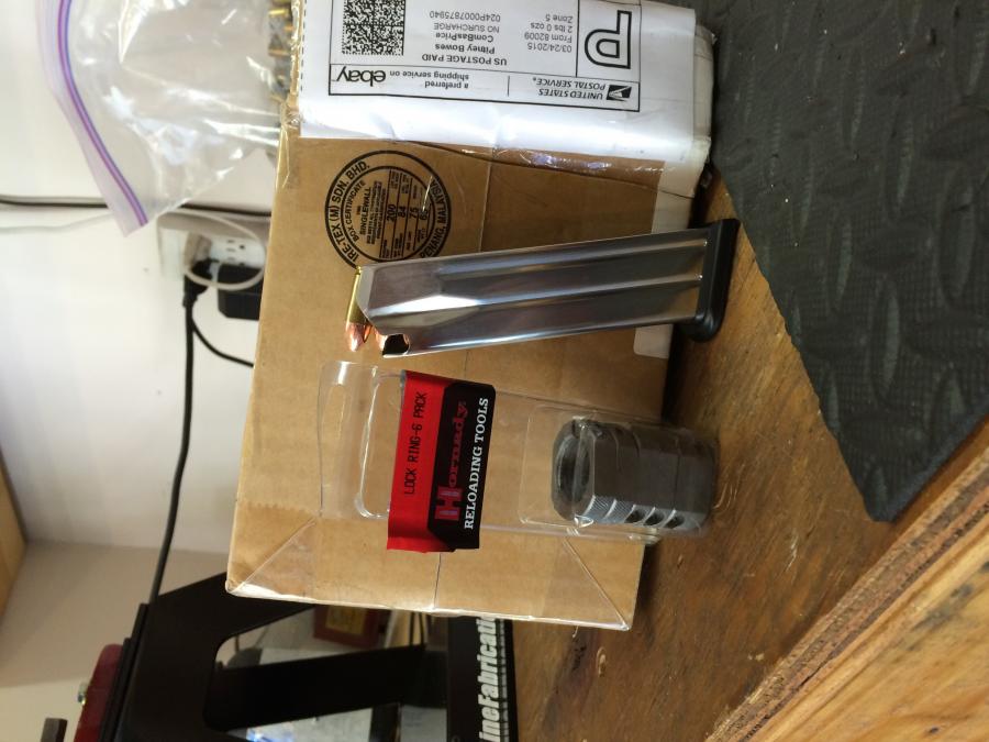

Bad Wolf Posted March 27, 2015 Author Report Share Posted March 27, 2015 So this is why such a small item and weight cost 10 bucks to ship. That is a XDM 9mm mag for reference. Quote Link to comment Share on other sites More sharing options...
392heminut Posted March 27, 2015 Report Share Posted March 27, 2015 Times are tough, gotta use whatever box you can find lying around! <lmao> Quote Link to comment Share on other sites More sharing options...
