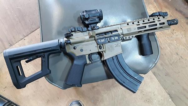

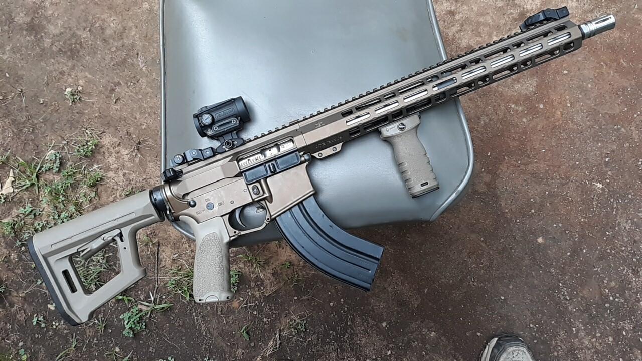

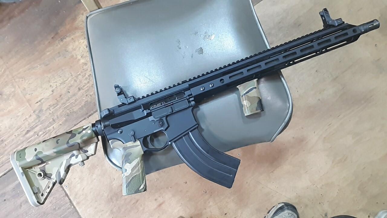

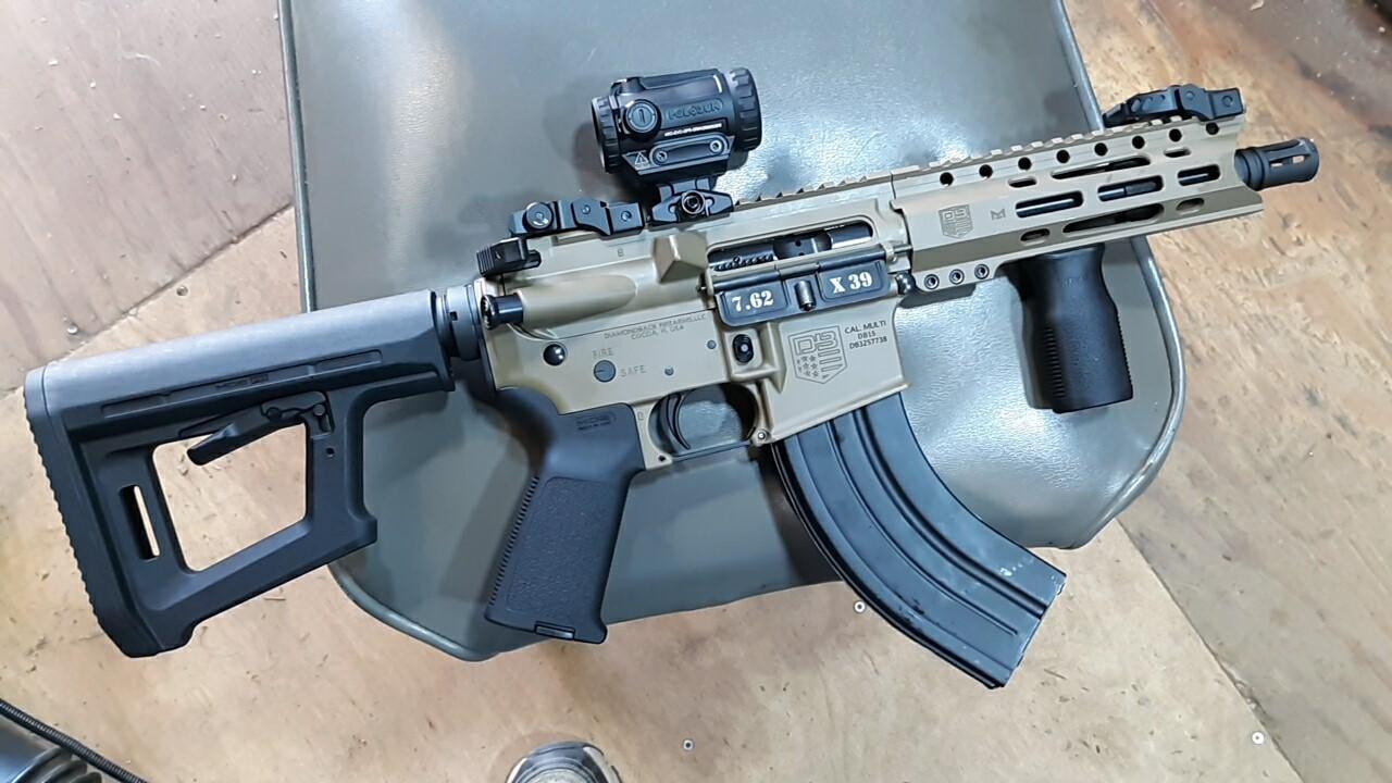

sketch Posted January 23, 2016 Report Share Posted January 23, 2016 (edited) My first was that good my buddy had to have one! Real cost 600$ with (2) mags. Areo loweraim 7.62x39 bcg nibradical 16" 1/9 twistmft stalkcheap hand polished lpk. Buyer will install mbuis or red dot. Test fire tomorrow ðBuilt in 12 days. Edited January 23, 2016 by sketch Shits x2 Quote Link to comment Share on other sites More sharing options...
NTXshooter Posted January 23, 2016 Report Share Posted January 23, 2016 Nice job. Let us know how it shoots. Quote Link to comment Share on other sites More sharing options...
unforgiven Posted January 23, 2016 Report Share Posted January 23, 2016 Very cool brother Roman,see how she runs. Quote Link to comment Share on other sites More sharing options...
Robocop1051 Posted January 24, 2016 Report Share Posted January 24, 2016 C-Products Defense.... You won't be upset with their performance! The 28 and the new 30 round mags are flawless. Quote Link to comment Share on other sites More sharing options...
sketch Posted January 24, 2016 Author Report Share Posted January 24, 2016 She ran supurb after i mentioned it might need some oil ?three random light primer strikes all refired , on target in 5 rnds with a 50$ reddot. Good day at the range!! Quote Link to comment Share on other sites More sharing options...
Robocop1051 Posted January 24, 2016 Report Share Posted January 24, 2016 I think I'm going to throw a Hyperfire trigger in my next x39 build. I hate getting light strikes. I already invested in a titanium x39 firing pin that's about .003 longer than a standard 5.56 pin. I'm trying to minimize Quote Link to comment Share on other sites More sharing options...
shepp Posted January 25, 2016 Report Share Posted January 25, 2016 I think I'm going to throw a Hyperfire trigger in my next x39 build. I hate getting light strikes. I already invested in a titanium x39 firing pin that's about .003 longer than a standard 5.56 pin. I'm trying to minimizethat's what's on the blue print for my build, pretty sure on the faxon page they reccomended it iirc. Quote Link to comment Share on other sites More sharing options...
shepp Posted January 25, 2016 Report Share Posted January 25, 2016 Faxon Technical Note on 7.62x39 Caliber Kit:The factory recommends a high-power hammer spring to use with the 7.62x39 kit. Many aftermarket "light" triggers will not reliably ignite 7.62x39 surplus ammunition. A spring is included and installed on XRS rifles ordered with the caliber. It is sold seperately for the upper or caliber kit only. Faxon offers a Wolff high power spring for sale. Faxon recommends HiperFire triggers with a special spring kit for an improved trigger pull. Contact HiperFire for details. Quote Link to comment Share on other sites More sharing options...
sketch Posted January 26, 2016 Author Report Share Posted January 26, 2016 I bought the bolt complete (x39) ill have to measure the pin! Thanks robo! Quote Link to comment Share on other sites More sharing options...
greggv Posted December 22, 2017 Report Share Posted December 22, 2017 I've quit buying special firing pins for these guns. I just use an AR firing pin, chuck it in the lathe, and cut .030 off the face that contacts the bolt. Use a tool with a small radius on the tip for this. Quote Link to comment Share on other sites More sharing options...
Robocop1051 Posted December 22, 2017 Report Share Posted December 22, 2017 1 hour ago, greggv said: I've quit buying special firing pins for these guns. I just use an AR firing pin, chuck it in the lathe, and cut .030 off the face that contacts the bolt. Use a tool with a small radius on the tip for this. You could just file the tail, at the end of the bolt, and get the same clearance. There are several companies that actually make their bolts with this modification already put in place. This way there’s no issue on needing a special firing pin Quote Link to comment Share on other sites More sharing options...
sketch Posted December 23, 2017 Author Report Share Posted December 23, 2017 shits this rifle has been rock solid since break in.. he put a better dot on top and is definetly 1moa at 100 !!! with steel ammo.? Quote Link to comment Share on other sites More sharing options...

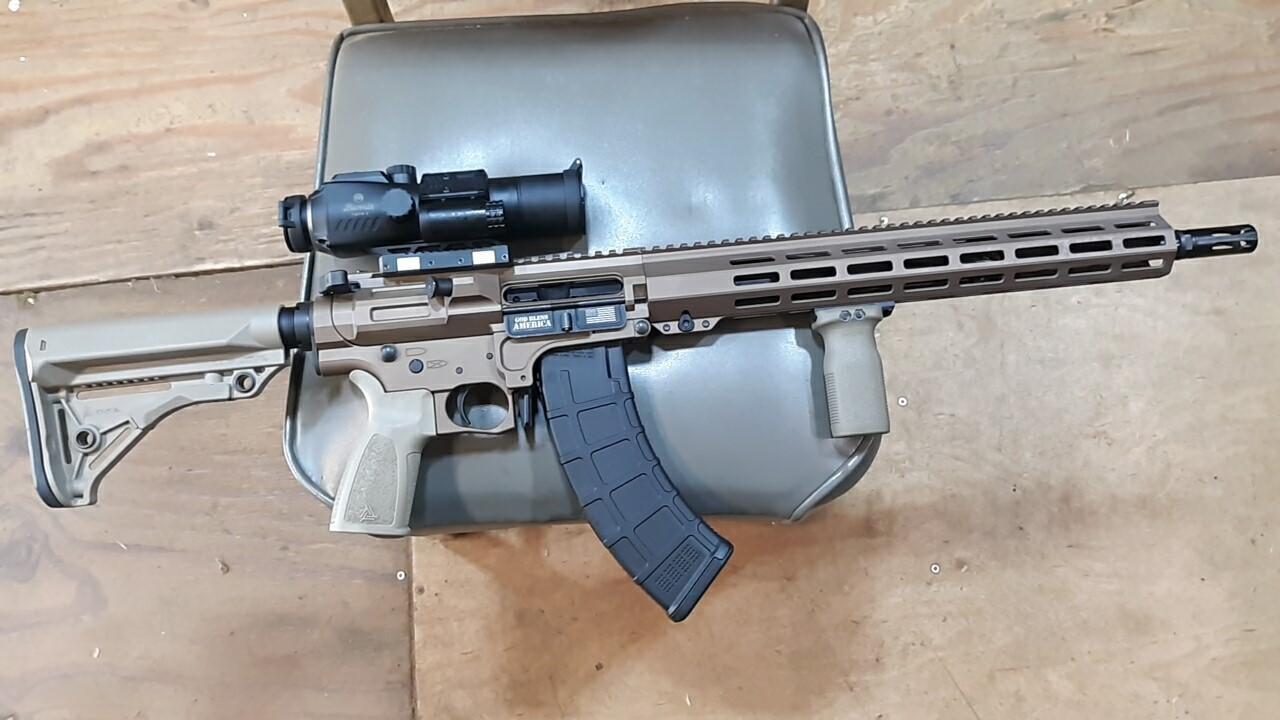

GoodByNAair Posted April 3, 2018 Report Share Posted April 3, 2018 PSA 18" Upper PSA lower Mill spec trigger Still up in the air on a optic. Quote Link to comment Share on other sites More sharing options...
GoodByNAair Posted April 3, 2018 Report Share Posted April 3, 2018 (edited) Editing time out. About 500 rounds out of it and only a few fail to feed. I think that's more mags than anything. Edited April 3, 2018 by GoodByNAair Quote Link to comment Share on other sites More sharing options...

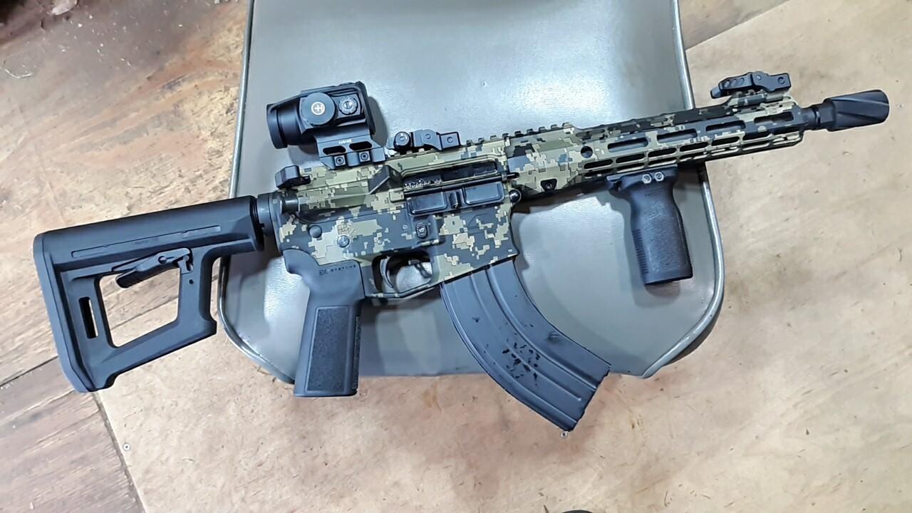

MikedaddyH Posted February 28, 2023 Report Share Posted February 28, 2023 Ice T guns Quote Link to comment Share on other sites More sharing options...
