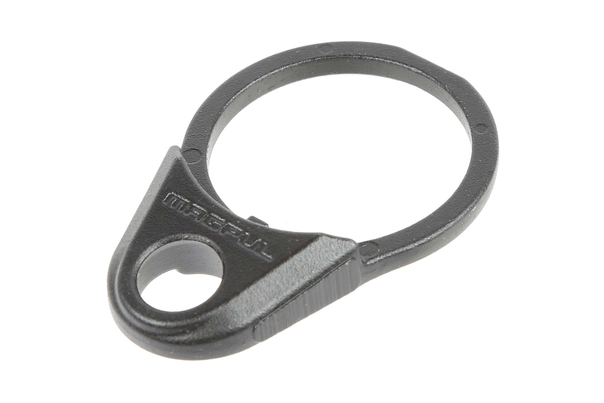

98Z5V Posted January 21, 2019 Report Share Posted January 21, 2019 2 minutes ago, 98Z5V said: Where did you buy this part from? Reason I asked - you got fucked. Here's what the MagPul QD End Plate looks like: What you're showing certainly doesn't look like that... I'm just sayin'... Quote Link to comment Share on other sites More sharing options...

98Z5V Posted January 21, 2019 Report Share Posted January 21, 2019 (edited) 4 minutes ago, chainsaw said: i got it at sportsmans warehouse.dont remember the model,had a steel loop on it to clip the sling on MagPul doesn't make anything like that, man, in your pic. So it wasn't a MagPul part, for sure. With that pic you posted, I don't see any loops on it, either, from that steel body. MagPul DOES make an ASAP Plate, though - it's this: That is definitely NOT what you have, though... not from that pic you posted... Edited January 21, 2019 by 98Z5V Quote Link to comment Share on other sites More sharing options...
chainsaw Posted January 21, 2019 Author Report Share Posted January 21, 2019 4 minutes ago, 98Z5V said: MagPul doesn't make anything like that, man, in your pic. So it wasn't a MagPul part, for sure. With that pic you posted, I don't see any loops on it, either, from that steel body. MagPul DOES make an ASAP Plate, though - it's this: That is definitely NOT what you have, though... not from that pic you posted... the pic i posted is the factory plate,i am wanting to replace that with one to hook a sling to.the pic you posted here is the one i bought and it wont go on my rifle.that is why i thought maybe they werent compatible between ar15 and ar10 Quote Link to comment Share on other sites More sharing options...
jtallen83 Posted January 21, 2019 Report Share Posted January 21, 2019 2 minutes ago, chainsaw said: it wont go on my rifle. I am betting that is a Matrix receiver you have, they are billet receivers and leave some extra meat on them compared to most, those tabs that hang over the receiver on the Magpul loop end plates won't pass over on the Matrix. Quote Link to comment Share on other sites More sharing options...
98Z5V Posted January 21, 2019 Report Share Posted January 21, 2019 (edited) ...^^^^ this. And, the ASAP Plate was made for the AR15-sized lower receiver. If that's your end-goal, you need something like this -click it... https://dsgarms.com/dsg-4201-0029 Edited January 21, 2019 by 98Z5V Quote Link to comment Share on other sites More sharing options...
chainsaw Posted January 21, 2019 Author Report Share Posted January 21, 2019 1 hour ago, jtallen83 said: I am betting that is a Matrix receiver you have, they are billet receivers and leave some extra meat on them compared to most, those tabs that hang over the receiver on the Magpul loop end plates won't pass over on the Matrix. yes thank you,i do belive it is matrix.i didnt realize they were thicker.that explains why the one i bought did not fit. Quote Link to comment Share on other sites More sharing options...
