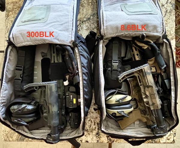

308USK Posted April 19, 2025 Author Report Posted April 19, 2025 Backpack SBRs...in a Vertx Gammut 3.0 backpack.
98Z5V Posted April 20, 2025 Report Posted April 20, 2025 Pete @308USK - MAD KUDOS on the pace counters, brother.
308USK Posted April 20, 2025 Author Report Posted April 20, 2025 On 4/19/2025 at 6:54 PM, Rsquared said: Outstanding. Thanks! :)
308USK Posted April 20, 2025 Author Report Posted April 20, 2025 On 4/19/2025 at 7:48 PM, 98Z5V said: Pete @308USK - MAD KUDOS on the pace counters, brother. Thanks! I've got 'em on my photography backpack as well, as I've spent years going deep into the backcountry and learned NOT to rely on electronics (esp. in winter months here in CO where batteries die quickly). Now that I have MY 300BLK SBR dialed in, it's time to work the 2nd upper I built for my youngest (same barrel / handguard, different gas block) and get it dialed in...he has submitted his eForm 1 (SBR) a couple weeks back (using pic of overall length measurement I provided).
