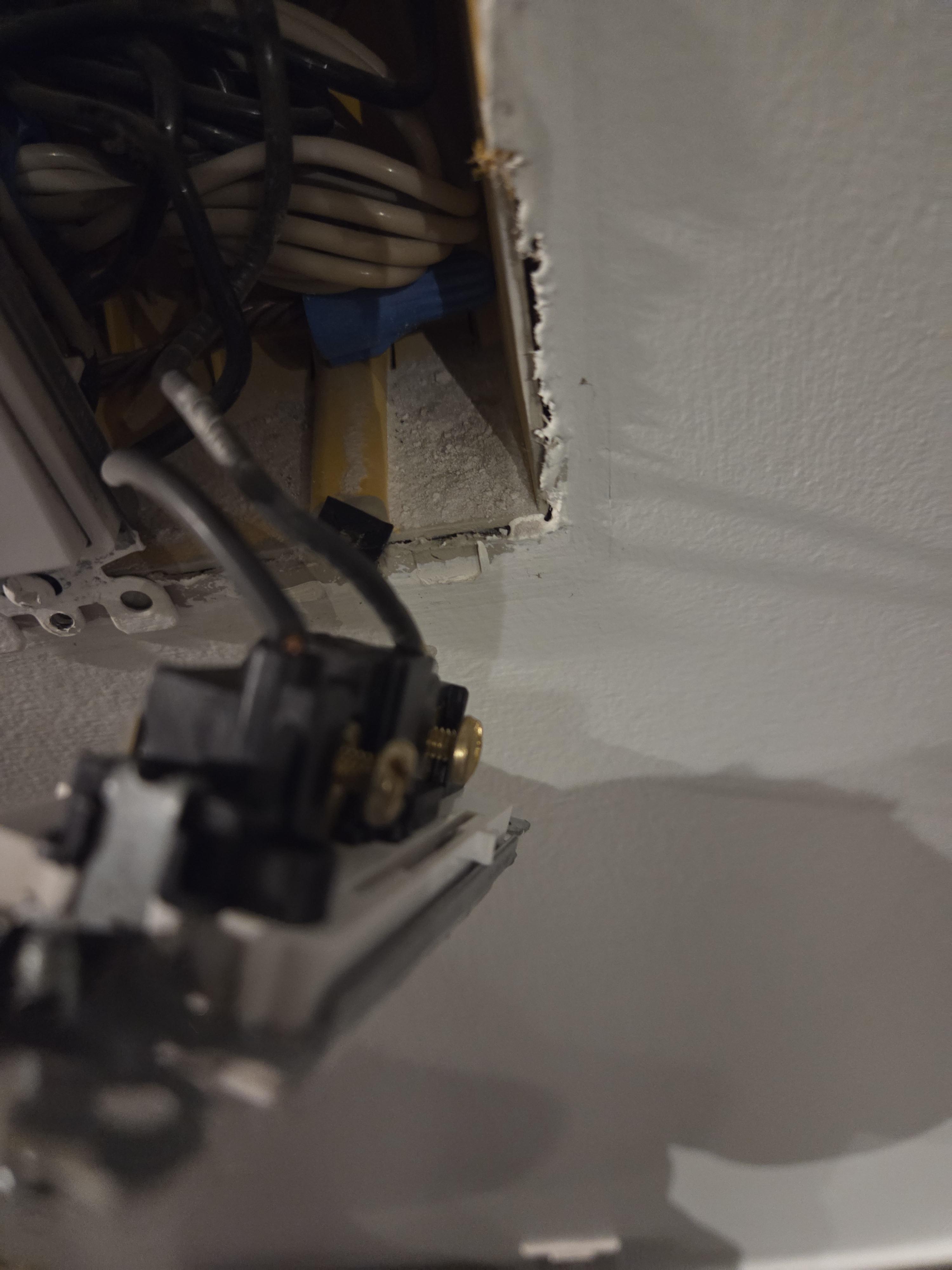

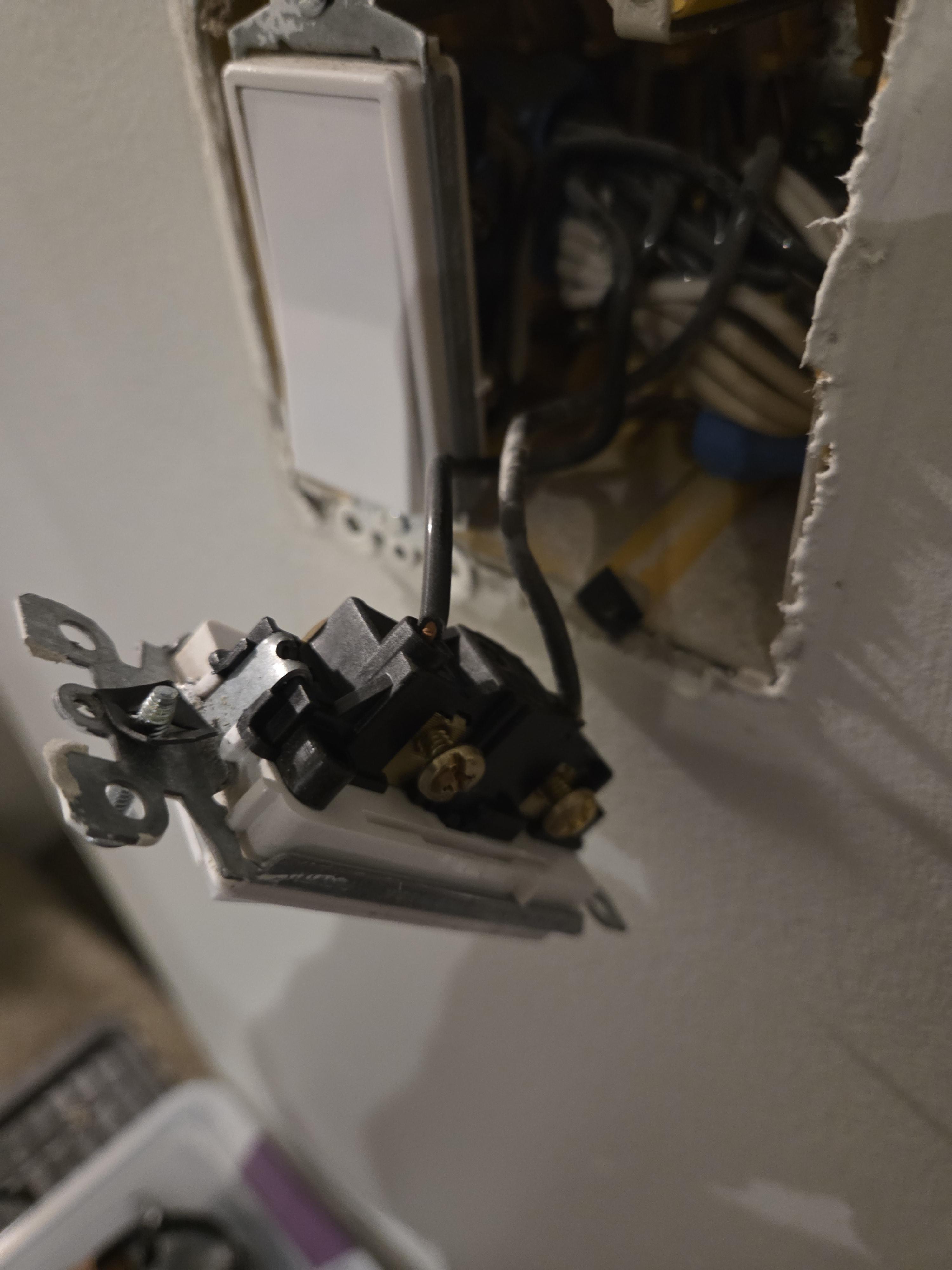

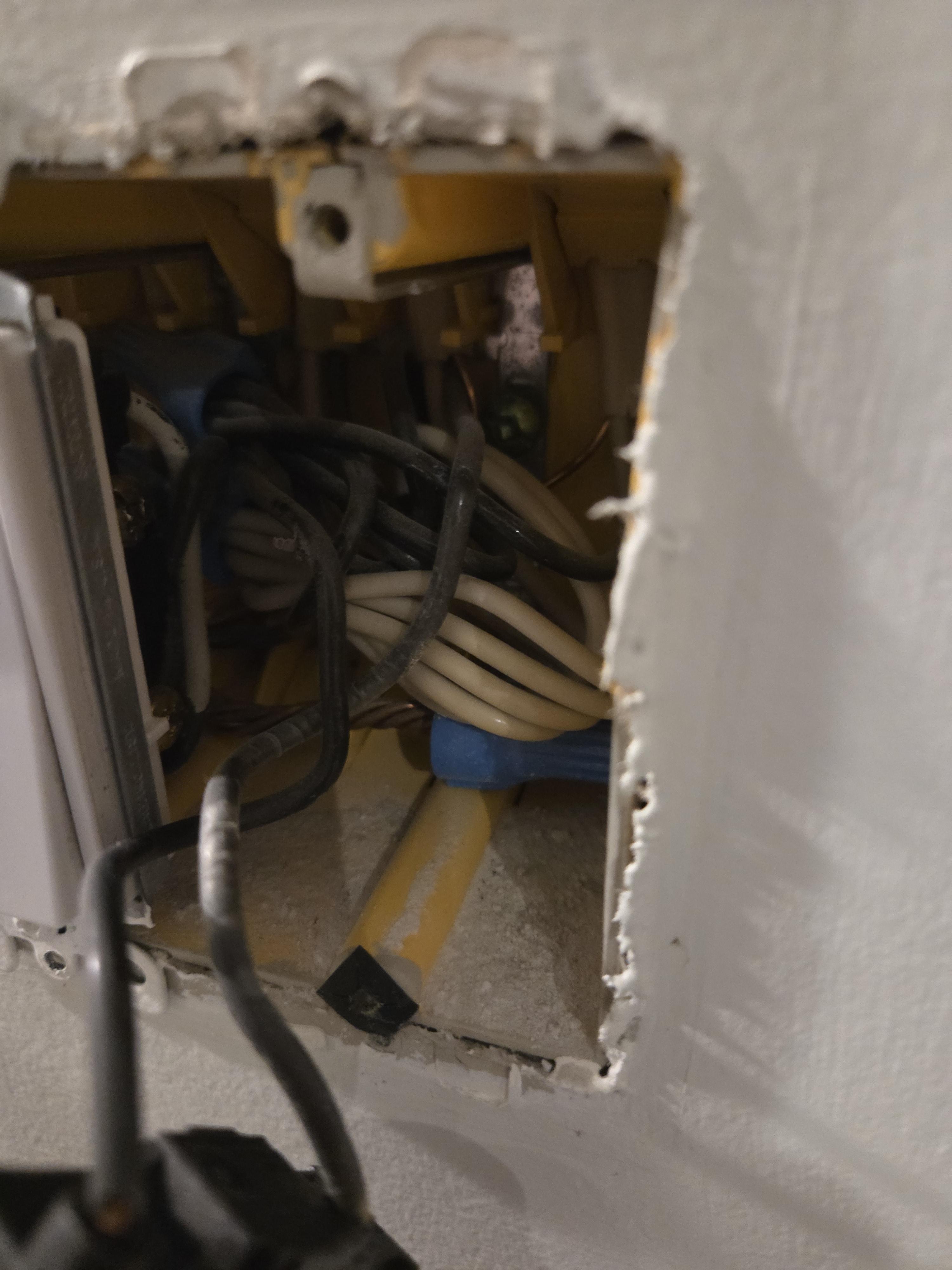

Cunuckgaucho Posted December 9, 2025 Report Share Posted December 9, 2025 Well I knew it was coming, did my first electrical update, installing timer switches for the bathroom. While not done unsafely, fast and sloppy and not a fan of back stabbed devices. What surprises me as sloppy as this was it must have been someone else doing the pannel as that's OK. Oh well as I paint, I can tackle the switches and outlets. Quote Link to comment Share on other sites More sharing options...

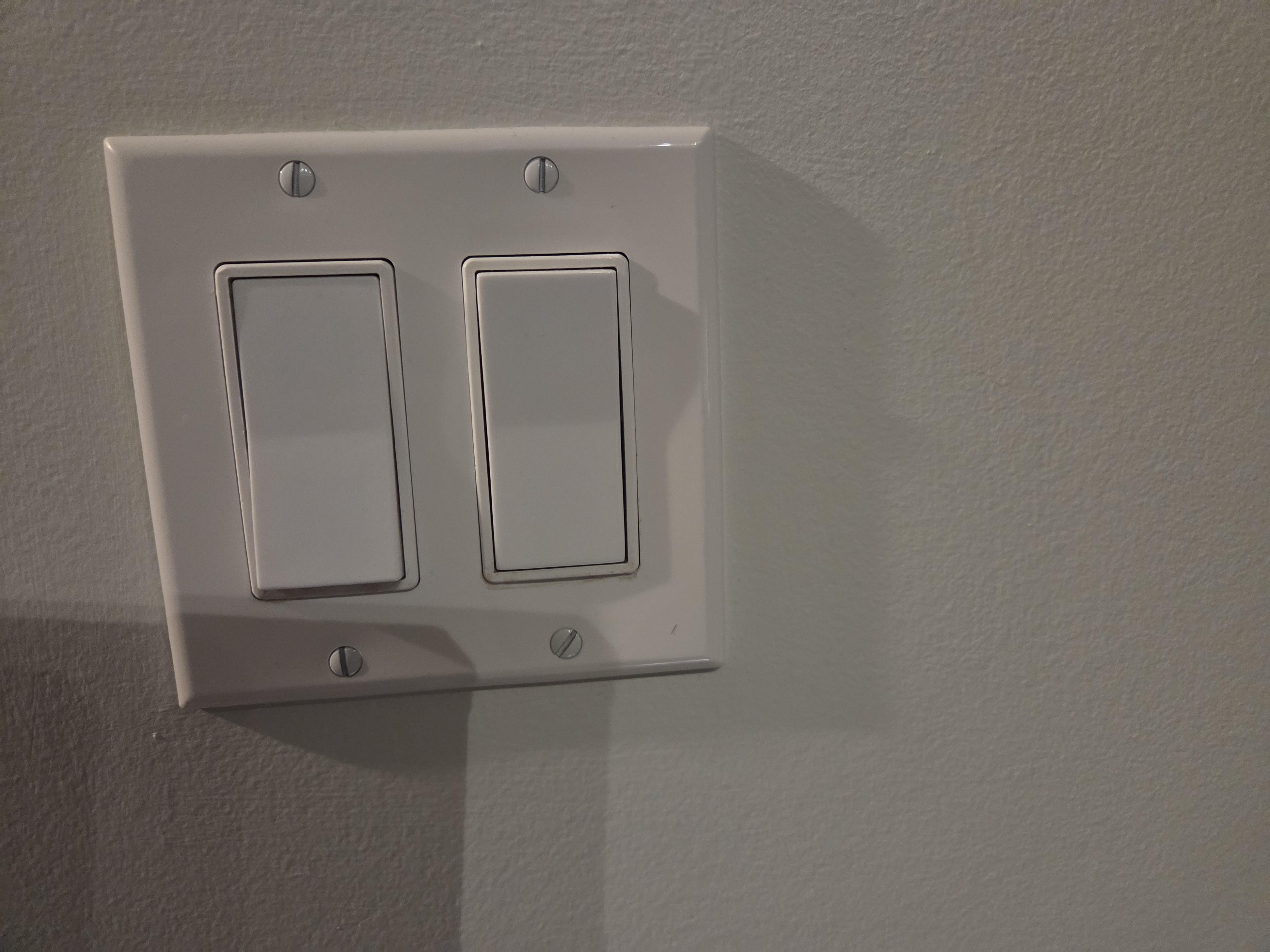

Cunuckgaucho Posted December 11, 2025 Author Report Share Posted December 11, 2025 Randomly picked a 2 gang Screws slots not all vertical. Wires back stabbed rather than using screws. Even though not being used the screws are not screwed down, especially in a multi device box. While it's good to have wire length, to much is almost as bad. Quote Link to comment Share on other sites More sharing options...
