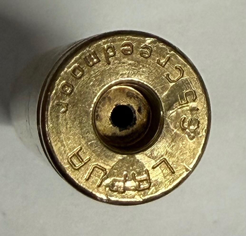

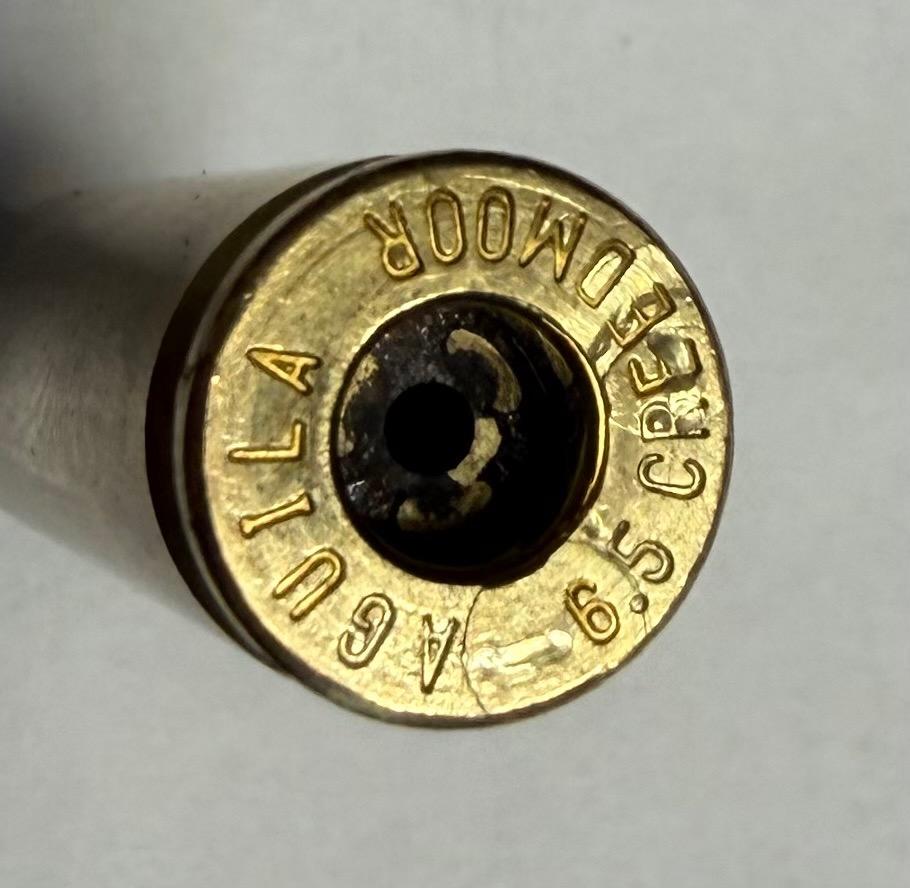

What is happening is that I am getting ejector swipe on 4 different brands of ammo and a scenario where the extracted round doesn’t eject but stays in the receiver and the bolt travels rearward enough to pick up a new round. If I single load a round the bolt locks on an empty mag but the empty round still stays in the receiver. This build has around 100rds through it so nothing should be worn out.IMG_4747.thumb.jpeg.4e4ffce0c37379e06cb9f46f600af266.jpeg
IMG_4740.thumb.jpeg.f4df82bf1a4073af37c87d862fc80f98.jpegIMG_4742.thumb.jpeg.7d2345a59e9aac1b0b5914570883b26d.jpegAmmo is S&B 140g, Aguila 129g, Hornady 140g and my reloads in the Lapua brass which has 42g of staball that puts its right in the middle of the reload book spec.
My unprofessional opinion is that the cases are still expanded while trying to extract and that’s why they aren’t exiting the upper, I doubt it is undergassed because the bolt goes rearward enough to pick up a new round or lock backnon an empty mag.

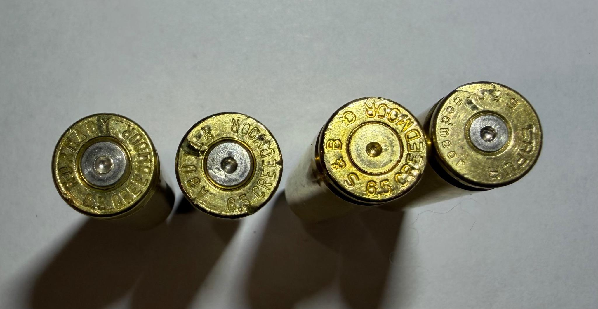

Does the pic of the brass directly follow the ammo listed, in order?  Like, left to right?  First ammo listed is the first piece of brass on the left, etc.
You have a dual ejector bolt, but only one swipe on the brass - and the swipes seen are big enough to catch your fingernail, where you'd have to file them off to reload them.
That 3rd piece of brass has no ejector marks on it at all, left to right, 3rd one.
The brass is randomized in the pic, I shot Aguila, S&B, Hornady then reloads in that order. There are 2 ejector marks on the cases but only one of the ejectors is showing up much more pronounced than the other one.
On the S&B case the marks are on the “cr” and “oo” in Creedmoor but it’s hard to tell from the picture, I can try to get better pictures for you if needed.  But I do not know why one ejector mark is showing up much more than the other one…

I took the best pictures I could of the case heads, the marks dont like to show up for the camera though. You can see the spots where both ejectors are making an imprint but one ejector is much more pronounced than the other one, why that is I have no idea. I also took a picture of the extractor indent on the case if that would help as well.
S&B had the least amount of swipe and I could not get that to focus at all on the camera.

The swipes do not look like rounded ejectors
That doesn't mean anything, because of springs.  Springs twist when the expand and contract, so they turn things, in motion.  Even if you very carefully lined up every round in the magazine, exactly the same, all the wording directly matching in the mag, same angle - the springs will twist 'em.  Where the marks are, compared to the words on the headstamp - not an indicator of anything.

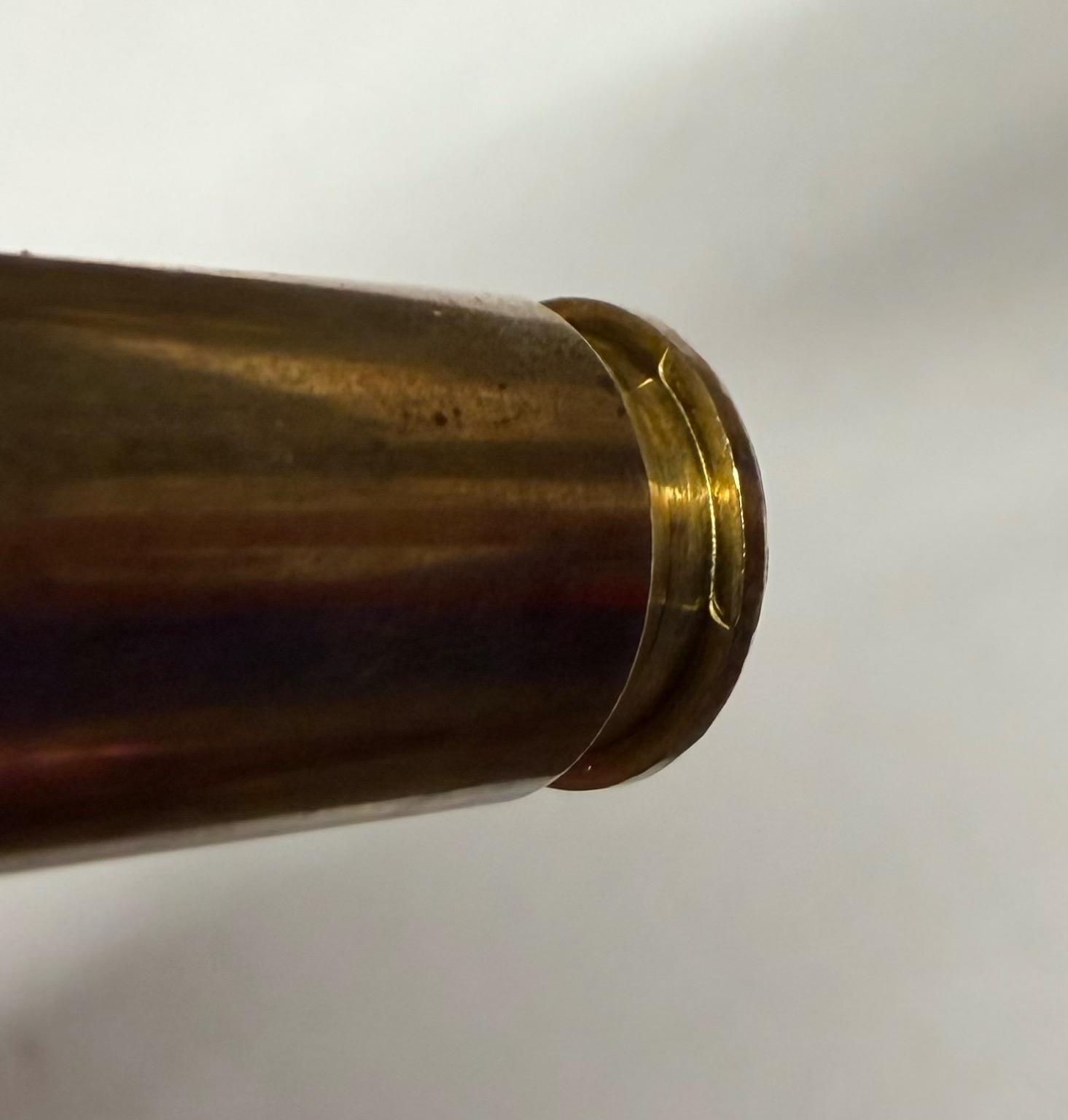

You have hot loads, plain and simple.  Maybe the ammo is hot - maybe the gun configuration isn't handling the pressure of the ammo you're using.  Something is causing that to be hot ammo in that specific gun.
That extractor mark on the rim - that's telling of a hot load. It was trying to rip that stuck brass out of the chamber.
So, if it's not the ammo causing this - it's the gun not being able to handle the ammunition.  Something is making all those loads look like hot loads - and it's not always ammo.
Have a chrono you can shoot these thing through?  That will give you some immediate answers, right there.

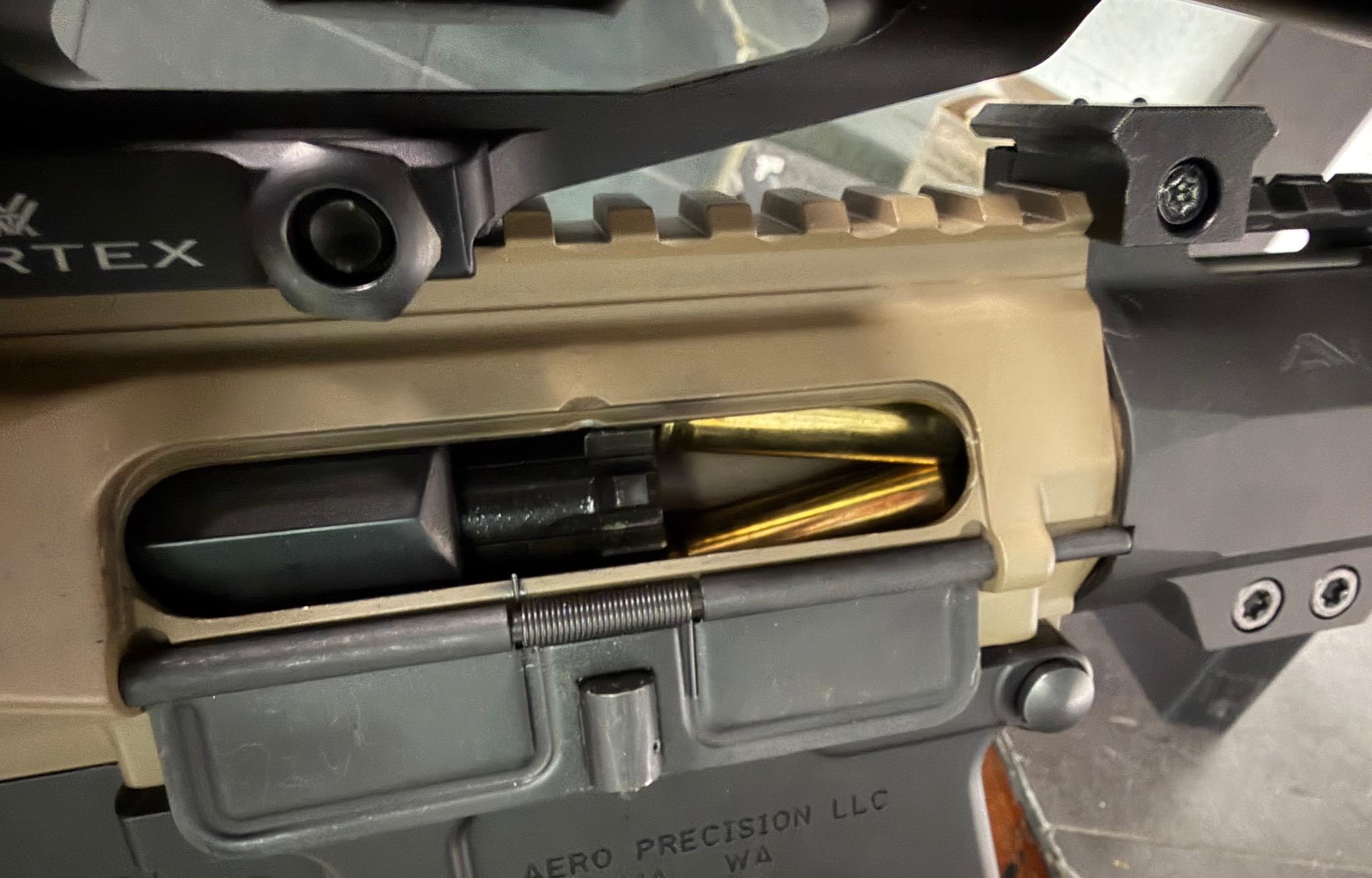

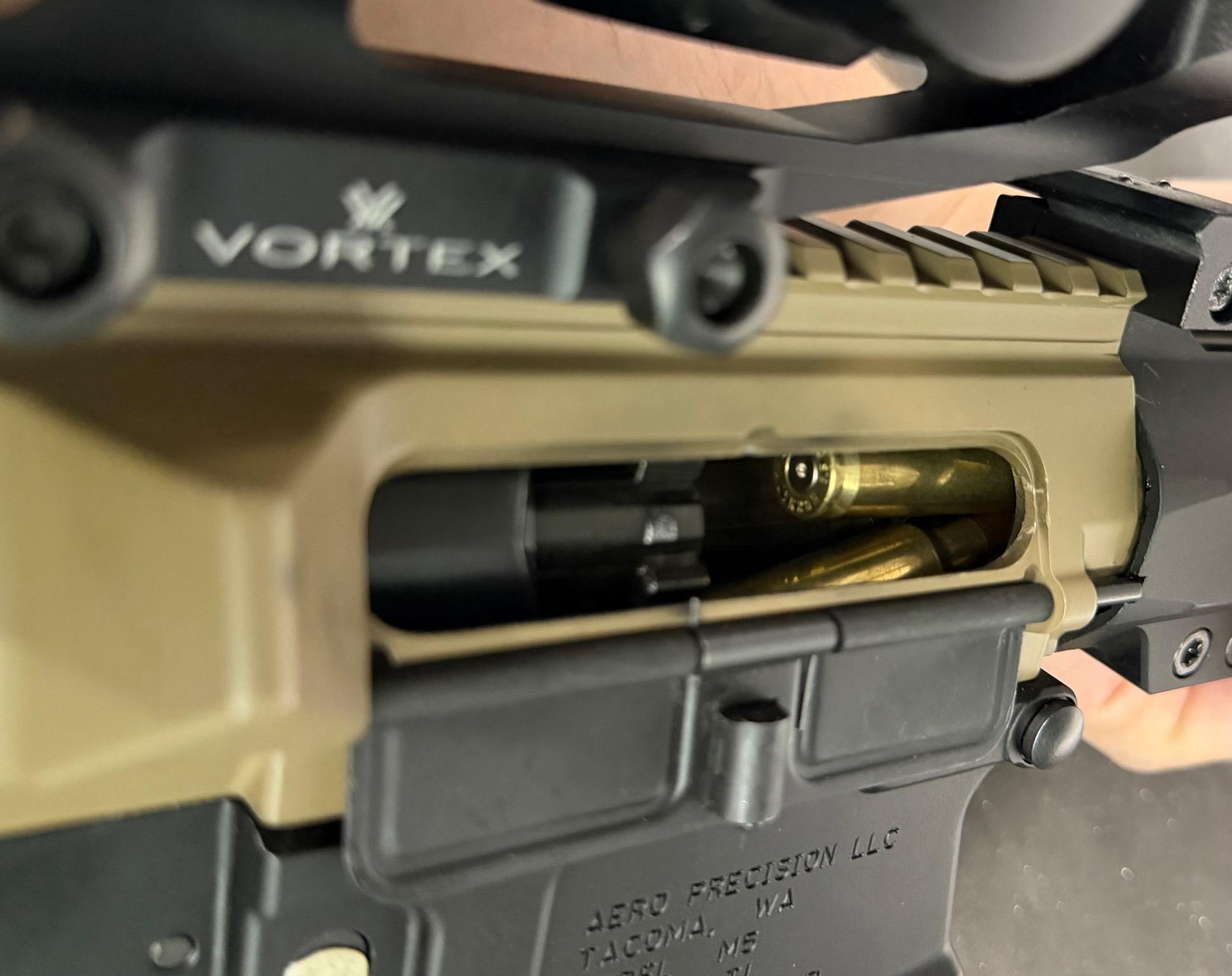

I just went back and looked at these two pics...
Exactly what's happening right there is this - that hot brass hasn't contracted enough yet, in the cycle of operation, and it's stuck to the chamber walls still.  That BCG is already beginning it's rearward movement, forcing the cam pin cutout in the BCG to rotate the cam pin - and turn the bolt.  While the brass is stuck to the chamber walls.  That's what causes ejector swipes.
Commonly, it's not enough recoil system.  Not the case with your gun setup.  Secondarily, it's not a bad gas system that isn't balanced to the proper recoil system.  I wouldn't suspect that at all with your BA barrel, and your statement on gas tube length, ending in the center of the cam pin cutout in the upper receiver.  Your gas tube length is good.  Only other thing in the gas system that can cause problems is the gas port diameter - but I wouldn't suspect that coming from BA, not in the least.  Too much gas port, and you're running hot, too much gas.  Not on my radar, from BA.
That leaves hot ammo.  It's the only other thing that's easy to test, without putting tools to your gun to check the gas port diameter.
