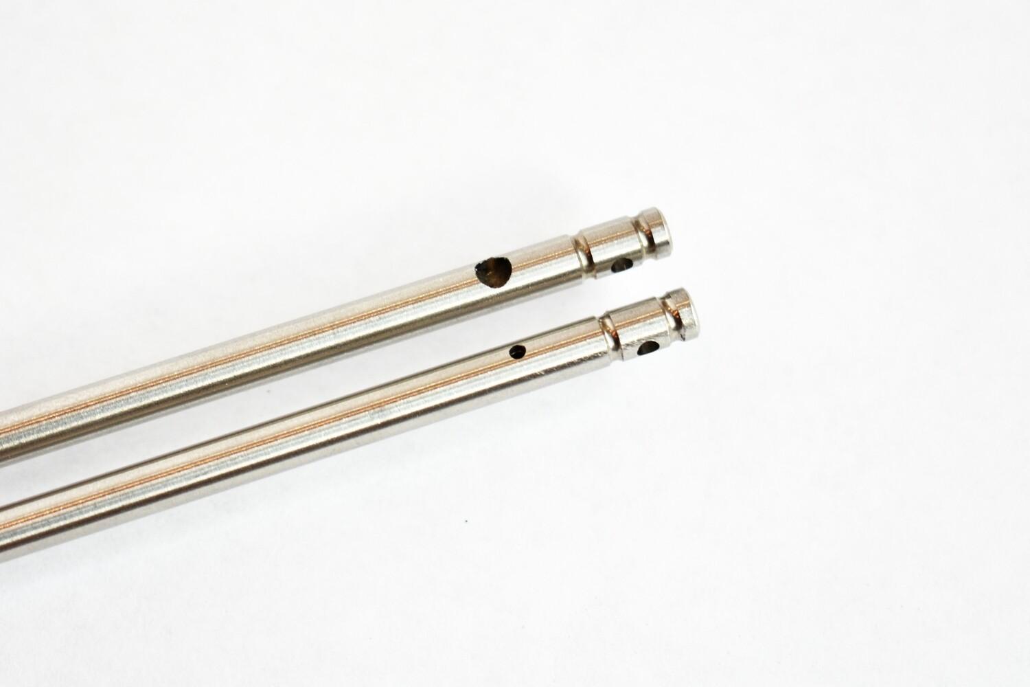

The gas port is too big, for that journal diameter.
An 0.080" port diameter would be just fine for a 0.750" gas block journal, but it's too much for the 0.875" journal, and the hole isn't gonna shrink.  You need an adjustable gas block, and choke that thing down a little. Not much, but it needs less gas.

That port has a diameter, and a length. Therefore, it has a volume. 0.625" gas block would have a thinner wall thickess, given the same caliber,  right?  In that, it would have a shorter length. A 0.936" gas block would have a greater wall thickess, and a longer length. That volume needs to stay relatively the same,  in order to have the same flow and pressure - because we're working with several fixed gas system lengths.

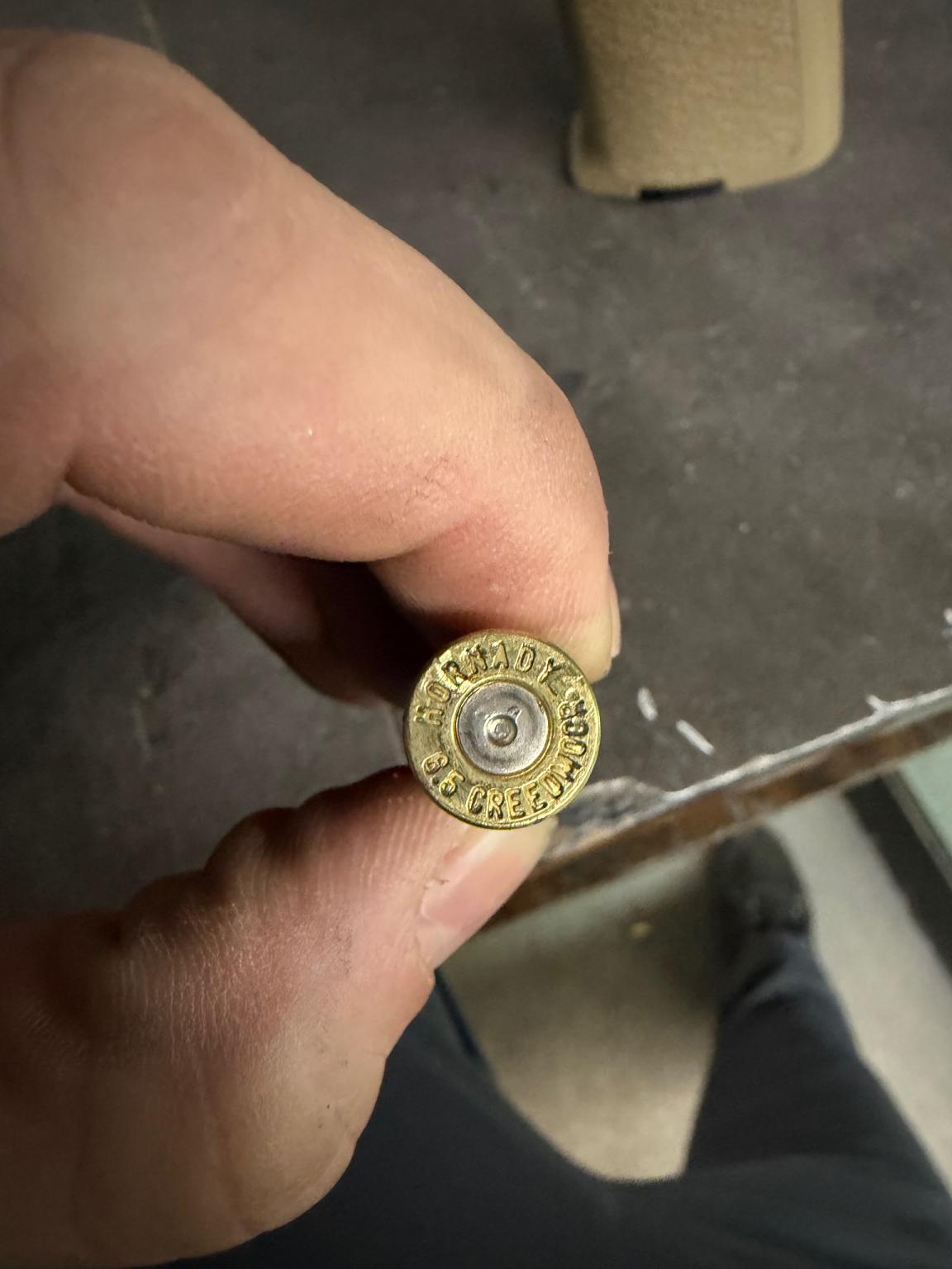

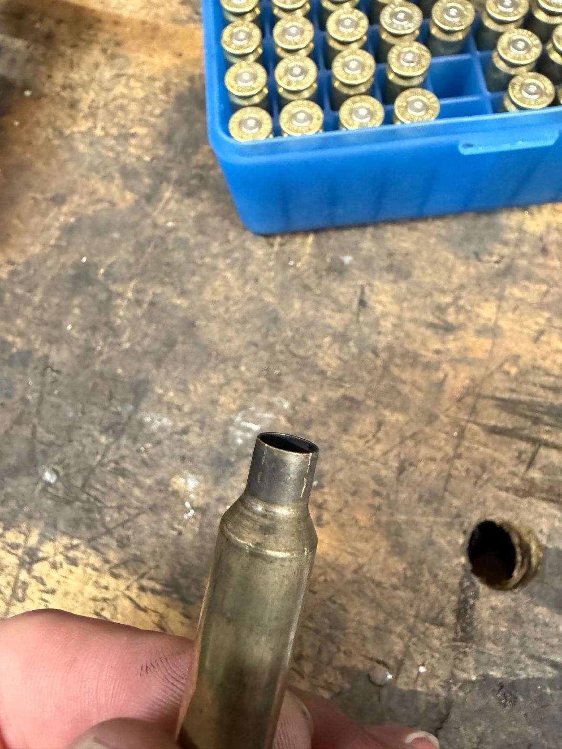

One thing that seems strange to me is I have these strange marks from the ejectors still. They aren't swipes from overpressure, and you can’t feel them, no extractor marks either so I will chalk it up to the brass. IMG_4826.thumb.jpeg.0a869aac310f393e1de8e8a38144f2dc.jpeg
Since I reload, my next task is to smooth the barrel extension since it is leaving nice gouges on my shoulder and necks.IMG_4848.thumb.jpeg.76dd873268f9dd279457affdad5d2f41.jpeg

Talk about impeccable timing! I just finally got the chance to test it today, I am having another issue but it's not due to the previous issues. I was going to make another thread but since you're here and have reloading experience ill pick your mind.
Rifle functions fine if the primers don't get pierced, once they blow the remains end up in the firing pin channel and locks up the bolt. I tried 2 brand new firing pins to rule out that issue but get the same results.
For rifle specs: recoil system is an armalite setup their spring, h3 buffer and 7-3/4 tube, Bcg is Kak high pressure with dual ejectors and smaller .068 firing pin, and barrel is a BA 20"6.5CM with rifle length gas tube, aero adjustable gas block and gastube in the middle of the cutout.
Load data is:
Lapua SRP twice reloaded using federal 205m primers, 40.2g H4350, 140g eldm's with a Lee factory crimp die.
FPS average is 2577 with an sd7 and es38 over 50 rounds so nothing close to hot. I had the same experience using cci400 primers and thought the thicker primer cups of the 205m would help but they didn't. I do have cci #41 primers I could try that are milspec, but already have a full brick of the 205m primers i planned to use just for this build. I built this gun with the intention of strictly reloading for it since I have a bunch of primers and 8lbs of H4350. At this point I wonder if I will have to change my load data and choose new bullets or something else because the pierced primers are starting to etch into my boltface and ruin my firing pin tips.

Yes, you have to, or you have a small diameter-tipped firing pin in a standard boltface firing pin hole - too much gap around the firing pin, that way.
@pnutty, the load looks good. try one test before you change primers - shoot the same loads that pierced primers already, and take one more click out of that gas block - take one click of gas out of it, reshoot the loads that pierced, see what happens.
If that still pierces primers in those same loads, change those loads over to the CCI 41 primers and retest a few.  A sample size that's large enough to either rule out pierced primers, or shot that it's still piercing primers with 41s in there.
You might pick up some speed with the change to 41s, so be ready to record that info - but it's not as important as finding out if you'll pierce 41s.
