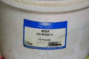

shibiwan Posted February 13, 2014 Report Share Posted February 13, 2014 (edited) Received the jewellers SS shot today. Misc cases (6.8, 9mm, some .380) BEFORE - initially tumbled with Raytech Dri Shine III (industrial walnut + rouge media .... notice the red residue) Let the tumbling begin (test dry tumble - no additives or fluids) Edited February 13, 2014 by shibiwan Quote Link to comment Share on other sites More sharing options...
