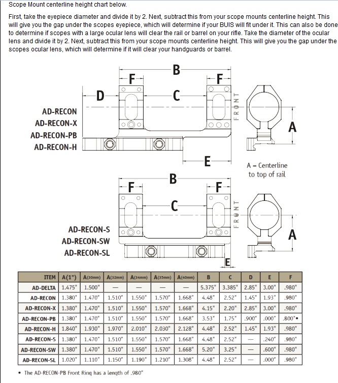

98Z5V Posted February 12, 2014 Report Share Posted February 12, 2014 (edited) Well, I'd hate to ignore all this advice from people who know way more about it than I do. I'll order some rings and see which I like better, or at least which give me more utility. Shibiwan was advocating Warne Maxima in High, .525" ring height. That would let the eye piece clear the rear sights? Or is that meant to be mounted in front of the rear sight? Folded of course. Warne measures differently - which is why this discussion is kinda important. You guys need to know where these measurements are to/taken from, in order to get the right-height stuff. ADM is different. Warne measures to the bottom of the scope tube mounting area, not scope centerline. ADM measures from mounting surface to scope centerline. Edited February 12, 2014 by 98Z5V Quote Link to comment Share on other sites More sharing options...
RAWTAZ Posted February 12, 2014 Report Share Posted February 12, 2014 98 is right, I just spent much of yesterday afternoon doing the math and comparing the numbers between Warne and Burris, Warne steel QD were on back order from my guy. .525 I think is not enough clearance for 30 mm tube and 50mm obj. Picked up some Warne Maxima QD in Extra High .625 locally to see what that looks like, if it is too much or too high will return and order the .525 Steel and wait. You have to review how each manufacture measures and do the math. Typical bolt gun has a taper in the barrel and the receiver is higher by a certain degree. I think my idea of being able to swap a $1,000.00 scope between the scout and the sr762 is going to be a PIA. Good Luck with your plan I will update on how mine works out. Taz Quote Link to comment Share on other sites More sharing options...
