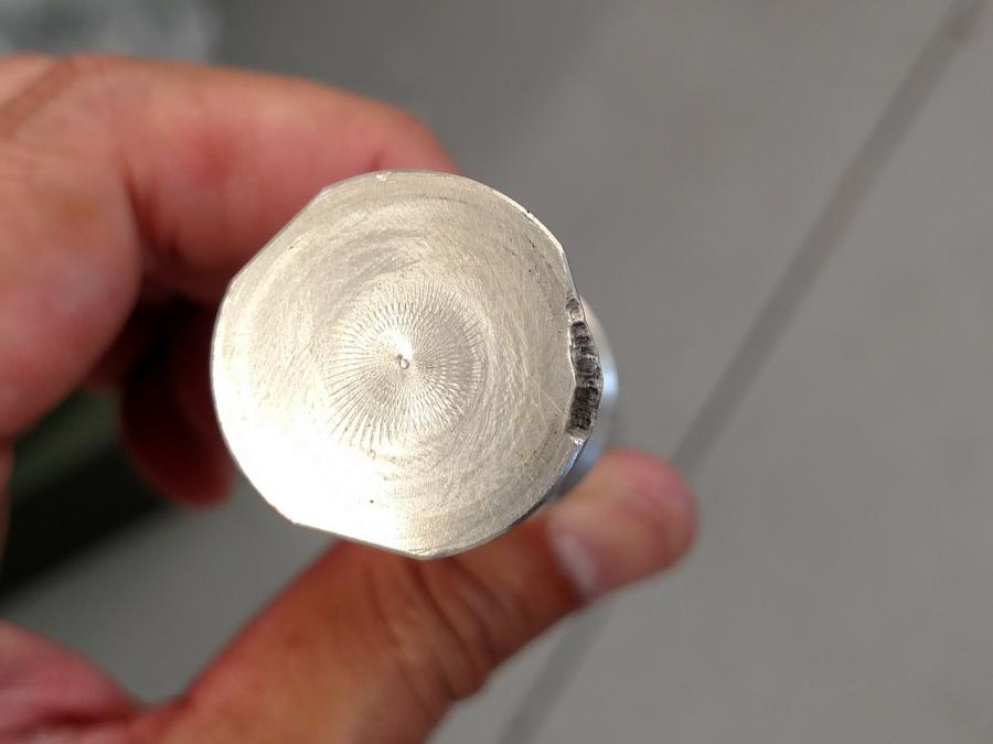

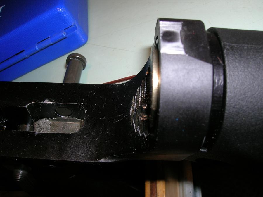

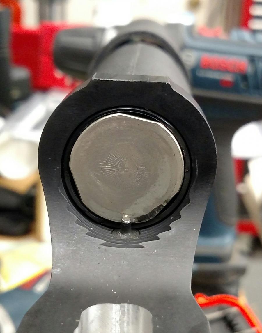

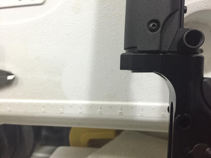

kazuaki Posted August 3, 2015 Author Report Share Posted August 3, 2015 OK, more info I just discovered. I'm fairly certain that Juggernaut drilled the buffer retainer hole too far rearward. If you look at the first picture, you can see the buffer sits perfectly flush with the lower. Shouldn't it stick out a little, so that the back of the BCG pushes on the buffer and takes tension off of the buffer retainer when closing the upper? In addition, you can see the damage to the buffer from slamming into the retainer while firing. Quote Link to comment Share on other sites More sharing options...
EasyEJL Posted August 3, 2015 Report Share Posted August 3, 2015 that part should only affect perceived recoil and not affect the forward motion of the bcg, although it is a problem. realistically, the "plus" is that if you every so often rotate the buffer it will end up pounding itself out so long as it doesn't break the retainer in the process :D other thing you can do is machine the ring around it to the depth of what is already pounded out and it should be fine Quote Link to comment Share on other sites More sharing options...

kazuaki Posted August 3, 2015 Author Report Share Posted August 3, 2015 survivalshop, the bcg does not touch the buffer at all when closing the upper. The buffer face is perfectly flush with the lower. I think it should be protruding a bit when resting on the retainer. I'm pretty sure they put the retainer hole in the wrong place (Juggernaut's doing, not mine). That being said, I'm not certain it is related to my original issue. Quote Link to comment Share on other sites More sharing options...

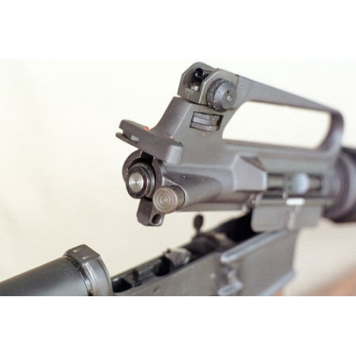

kazuaki Posted August 4, 2015 Author Report Share Posted August 4, 2015 When the BCG is in battery, the back of the BCG is flush with the rear of the upper receiver. I believe that is how it should be. Can somebody break open one of their LR308's and tell me if the face of the buffer protrudes from the lower when resting against the buffer retainer? Here's a picture of my BCG in the upper: Quote Link to comment Share on other sites More sharing options...

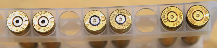

kazuaki Posted August 4, 2015 Author Report Share Posted August 4, 2015 Here's a picture of some of the primers. Left to right, Eagle Eye > FGMM > Perfecta. Notice the Eagle Eye has the hole in it. Also, some of the brass has a pretty noticeable scratch/smear mark from the ejector. Quote Link to comment Share on other sites More sharing options...

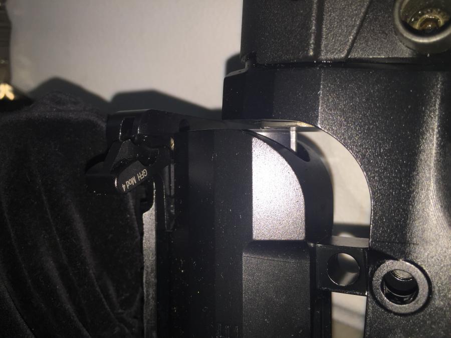

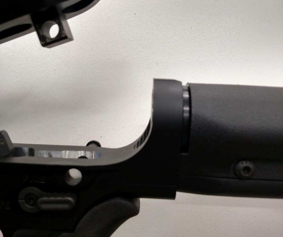

DNP Posted August 4, 2015 Report Share Posted August 4, 2015 Mine protrudes about a 1/16 at the top. And here they make contact on closing. Quote Link to comment Share on other sites More sharing options...
shepp Posted August 4, 2015 Report Share Posted August 4, 2015 (edited) Mine protrudes about a 1/16 at the top. image.jpg And here they make contact on closing. image.jpg Mine too Edited August 4, 2015 by shepp Quote Link to comment Share on other sites More sharing options...
DNP Posted August 4, 2015 Report Share Posted August 4, 2015 You're still talking about your 308, yeah? Quote Link to comment Share on other sites More sharing options...

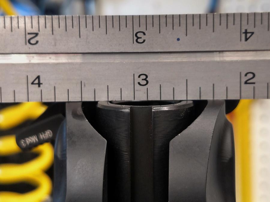

DNP Posted August 4, 2015 Report Share Posted August 4, 2015 Dumb question. Can you post a pic of your retainer? Looking into the tube holding the buffer. How does it sit against it? Quote Link to comment Share on other sites More sharing options...
kazuaki Posted August 4, 2015 Author Report Share Posted August 4, 2015 Is this what you mean? Quote Link to comment Share on other sites More sharing options...
DNP Posted August 4, 2015 Report Share Posted August 4, 2015 Yeah. Had to see it. It's like callin tech support and they ask if it's plugged in. I said it was stupid, but had to see it actually meeting up with the right section of the pin. We have exceeded my technical capabilities. I will watch closely as this goes on though. I remember the thread with the beat up buffer like that one -can't remember what the outcome was. Quote Link to comment Share on other sites More sharing options...
kazuaki Posted August 4, 2015 Author Report Share Posted August 4, 2015 I've looked at pictures of other 308 lower including those posted above and verified that the buffer should protrude a bit. So, the buffer retainer hole in my lower is out of spec. I sent Juggernaut pictures, but I can see the ones on their webpage even look like that. Funny thing is the buffer issue isn't even the issue that led me to start this thread. It's the pierced primer issue that is a bigger concern to me. I'll have to get back to the range and see if my bolt catch fix will resolve that. Quote Link to comment Share on other sites More sharing options...
survivalshop Posted August 4, 2015 Report Share Posted August 4, 2015 survivalshop, the bcg does not touch the buffer at all when closing the upper. The buffer face is perfectly flush with the lower. I think it should be protruding a bit when resting on the retainer. I'm pretty sure they put the retainer hole in the wrong place (Juggernaut's doing, not mine). That being said, I'm not certain it is related to my original issue. The primer piecing is probably the ammo , if its the only Brand doing it .You keep saying Eagle Eye , is it American Eagle ? Hard to tell with the 80% Lowers , There are no MilSpecs on a 308AR like an AR15/16/M4 , Manufacturers make their own up sometimes & can cause all kinds of problems . We have seen a lot of it here with 100% Receivers. Your Buffer hitting the Retainer is going to break it eventually . Does your BCG when locked in the Barrel extension , push the Buffer back into the Lower Receiver Extension when closing the Upper onto the Lower Receiver ? If it doesn't its not to spec's , As said, the Buffer should not touch the Retaining Pin when in operation , with the BCG in locked breach position , the BCG can not go any more forward , so if it can't go forward any more & when closing the Upper onto the Lower , the BCG pushes the Buffer a little off the Buffer Retainer , to keep it from hitting it when the action is cycling . The only time the Buffer should touch that Retaining Pin is when you disassemble or Shotgun the Receivers , its just to retain the Buffer upon disassembly . Has this rifle had the Head Space Checked ? Quote Link to comment Share on other sites More sharing options...
kazuaki Posted August 4, 2015 Author Report Share Posted August 4, 2015 Survivalshop, Eagle Eye Ammo: http://www.eagleeyeammo.com/308-win-175gr-hpbt/ Regarding the buffer, there is absolutely zero contact between the BCG and buffer when closing the rifle. Clearly, that is an issue. It seems we've narrowed that issue down to the lower not being correct. The buffer retainer hole is not to spec. I'm weighing my options on resolving that issue still. With regards to the pierced primers, I had one round of Federal Gold Medal Match that was pierced as well. Not sure what's up with that. Until yesterday, when I started searching for explanations to all this, I did not realize that a semi auto needed a slightly milder load than a bolt gun. I've read a few things stating that some Ammo might just be too hot a load for the semi auto. I don't exactly understand why or the details of that. I know JP states that their High Pressure bolt was created to address issues with hot loads in these guns. BTW, yes the headspace was checked with both a GO and NO-GO gauge before the trip to the range. Quote Link to comment Share on other sites More sharing options...
survivalshop Posted August 4, 2015 Report Share Posted August 4, 2015 Never heard of that brand of ammo , but I don't buy much ammo , I've been rolling my own for about forty years & pierced or blown out primers are usually the result of over pressure , be it the over loaded ammo or a Bad Chamber . Your firing pin protrusion is correct , so that eliminates that , so your down to Chamber or over loaded ammo . The 308AR's can shoot any Commercial or MilSpec ammo , I have tested a lot of different brands & configurations. Your Primers , except for the ones with the holes in them look OK , the ones with holes would not show over pressure , because the primer blew out before it could be flattened from over pressure . You say you checked Head Space with "No Go' & Go " Gages , check it with a "Field Gage also , just to be sure . Also make sure they are good gages, I have seen , even on this sight , that Chambers passed because of Bad gages , remove the Ejector to test , unless you have a newer set that has a depression in the Gage for the Ejector to fit in . Be it the Lower or Upper Receiver out of spec , you can still fix the Buffer pounding with that weight set , easy fix & inexpensive. This is a new 308AR build & the BCG just slightly pushes the Buffer away from the Retaining Pin. Quote Link to comment Share on other sites More sharing options...
