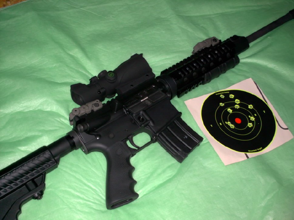

YWHIC Posted June 19, 2011 Report Share Posted June 19, 2011 Read some AR15's do and some don't like steel cased ammo..I thru caution to the wind and ordered 500 rounds of Wolf MC 223 FMJ ammo.. for the new DPMS 5.56 I ordered..after running a good 80 rounds of Federal AE 223 55gr FMJ with ZERO issues.. I tried the Wolf MC...HORRIBLE.. FTE's.. last one got STUCK in CHAMBER and I had to use a cleaning rod to get it out.. when I got it home..now when your sighting in a new red-dot/scope and something like this happens.. it tends to pis* on your parade.. <dontknow>anyway.. that was yesterday..I have sold the remaining Wolf already and recovered $92 for that..I then ordered some (400 rounds) more BRASS ammo.. $6.19/box.. PMC Xtac 193 55gr FMJ ammo..here is today's results..at 100 yards and 3 MOA red dot.. group measured 3 1/4" with 10 shots..and some CLAY bustin..all seems GTG now.. <thumbsup>as a side note it was suggested to TRY some Silver Bear maybe after say 300 rounds down the pipe to maybe loosen the cahmber up abit and get rifle to break-in some..Al Quote Link to comment Share on other sites More sharing options...
