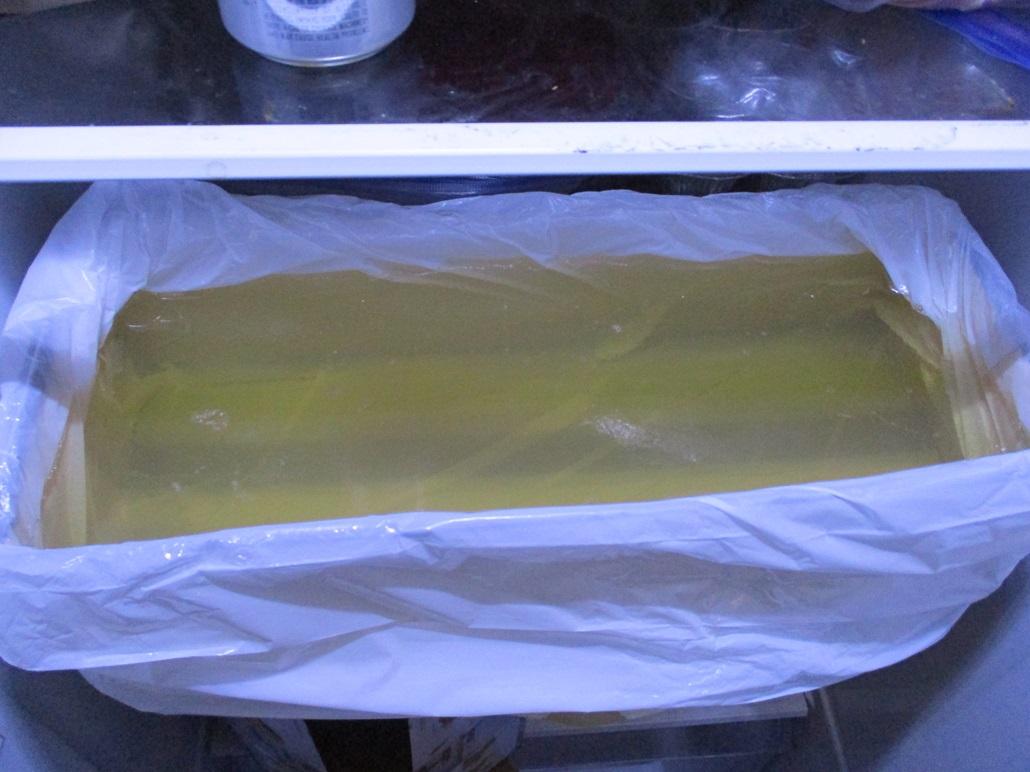

98Z5V Posted April 13, 2025 Report Share Posted April 13, 2025 Yep, fellas, we're about to get into Ballistic Gel Testing. I've always wanted to try it out, so it's getting figured out. First shots downrange in the next month-ish. I'll add to this as it gets going, but I'll discuss the research now, here - it's alot more complicated than it appears. I see why people drop the money to just buy a gel block, instead of making it at home. The most common size for a block is 16 x 6 x 6 inches. I found some suitable containers on Amazon to use as molds, and have two of them. That dimension holds 2 gallons of water. The prices for gel blocks is pretty crazy, anywhere from just under $100, to about $250, for that size block. Depends on what you find, and from where. There's a place called Clear Ballistics that has the FBI block for $90. It's gonna cost you about $40 to make one block. Obviously, 10% ballistics gel is 1 part gel mixture to 9 parts water, by weight. Water weighs 8lbs per gallon, so that's right at 130 ounces as a round number. Gotta have 13 ounces of gel powder to 117 ounces of water - per gallon. By weight, that comes up to 8.125 lbs. Good enough to mix. The 16 x 6 x 6 block molds will need 2 gallons of water. Knox gel, commonly used for this is about $20 per 16oz container, when you buy bulk. Found a 6 pack of that on Amazon for just under $120. You can't find 16oz containers in the grocery store... A ONE OUNCE little tiny box of this stuff will cost you about $3 at the grocery store... The 6-pack of 16oz containers = 96oz total / 13oz of gel mix per gallon = 7.38 gallons of this stuff I can mix up... almost 4 blocks of it, for just under $120... So, there's alot more to just making this and using it as Ballistic Gel than meets the eye. You measure everything out, heat the water to a certain degree, mix in the gel powder a certain way, stir it all in for a certain amount of time, pour it into your molds, then refrigerate it at a certain temp for a certain time... Yeah... I've seen times for refrigeration anywhere from 36~72 hours. THEN, when it's done, you need to KEEP it at 40* F until you're ready to use it / shoot it... According to FBI Protocol Testing, you shoot it from a distance of 10 feet from the muzzle. That's a tick more than 3 yards... Skin is tough, so the first 4" of penetration are supposed to equal the pressure of puncturing skin - and you ignore those first 4" when looking at the results, but trying to get a visualization of what the terminal ballistics are going to look like in real tissue... It's a pretty wild process. Here are a couple articles about it all: https://www.hornadyle.com/resources/fbi-test-protocol https://g9defense.com/blog/ballistic-gelatin-testing-5-things-to-understand-ballistic-gel-testing-a-comprehensive-guide/ It's coming... I promise you... and it's not going to be long from now... Quote Link to comment Share on other sites More sharing options...

98Z5V Posted April 29, 2025 Author Report Share Posted April 29, 2025 Alright! All the stuff is here, and I'm making 2 gel blocks tomorrow night, to use this coming weekend. 2 blocks, 16" x 6" x 6". Takes 4 gallons of water for that, and 52 ounces of the gel powder, to brew these up. Gonna be a fun weekend. I hope I can slow down the GoPro vid enough to make it decent videos... Quote Link to comment Share on other sites More sharing options...
98Z5V Posted May 2, 2025 Author Report Share Posted May 2, 2025 So, this process is WAY DIFFERENT than any online descriptions of what you need to do to make it. I dropped $80 to make two gel blocks. Amazon prices, cheap as fuk. Comparatively. Followed online instructions - garbage. Completely wasted enough materials to make the first gel block. Lumped up, blocky, didn't work for shiit. Wasted around $30~$35 of materials, for junk. Went a different route, ignored everything with the online instructions for B Gel, and just did it according to the package directions, minus the amounts that they use in those directions. You mix this shiit WAY THICKER than if you're making jello for a nursing home, in bulk. Learned. Hard way. $$$ way... FML. We're shooting this thing this weekend, 5.56 Mk 262 loads, 7 twist and 5 twist. Results after this weekend, on the twist rates, and differences. Quote Link to comment Share on other sites More sharing options...

98Z5V Posted May 2, 2025 Author Report Share Posted May 2, 2025 18 hours ago, Armed Eye Doc said: Do you use half the water, or thereabouts? No, you mix by weight. 1:10 ratio - that's the "10% ballistics gel." 9 parts water to 1 part powder, by weight. It's pretty close. A gallon of water is 124 ounces. Just call is 130 ounces, so you use 13 ounces of powder, and 117 ounces of water. These 16 x 6 x 6 molds hold 2 gallons each. Quote Link to comment Share on other sites More sharing options...
sketch Posted May 3, 2025 Report Share Posted May 3, 2025 Simple mathematics. Looks like a block of gel! How will you keep it to temp? Quote Link to comment Share on other sites More sharing options...

shepp Posted May 3, 2025 Report Share Posted May 3, 2025 On 5/2/2025 at 4:46 PM, 98Z5V said: No, you mix by weight. 1:10 ratio - that's the "10% ballistics gel." 9 parts water to 1 part powder, by weight. It's pretty close. A gallon of water is 124 ounces. Just call is 130 ounces, so you use 13 ounces of powder, and 117 ounces of water. These 16 x 6 x 6 molds hold 2 gallons each. You’re baking in a sense, weight is always the best way to bake. Because 1tsp sea salt is different that 1tsp table salt or kosher. But 1 gram is 1 gram no ifs and or buts about it! Quote Link to comment Share on other sites More sharing options...
BrianK Posted May 4, 2025 Report Share Posted May 4, 2025 The difficulty is precisely why I never tried it. Then after the block is made it's organic and needs to be used before it spoils. That's why I use 1 gallon milk jugs of water. And yes, I know it's not the same as B Gel. But B Gel isn't the same as flesh which it's supposed to sorta mimic (but doesn't). Too much effort for something that doesn't mimic what it's supposed to mimic. Water is lots easier to not mimic the intended medium. The other day I watched a video where the gent used parts of a dead cow. Now that was the right test medium IMO. I've also seen tests run on Boston Butt. Good luck with your testing. Quote Link to comment Share on other sites More sharing options...
