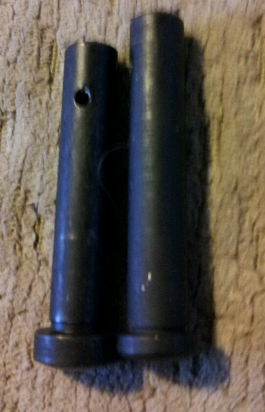

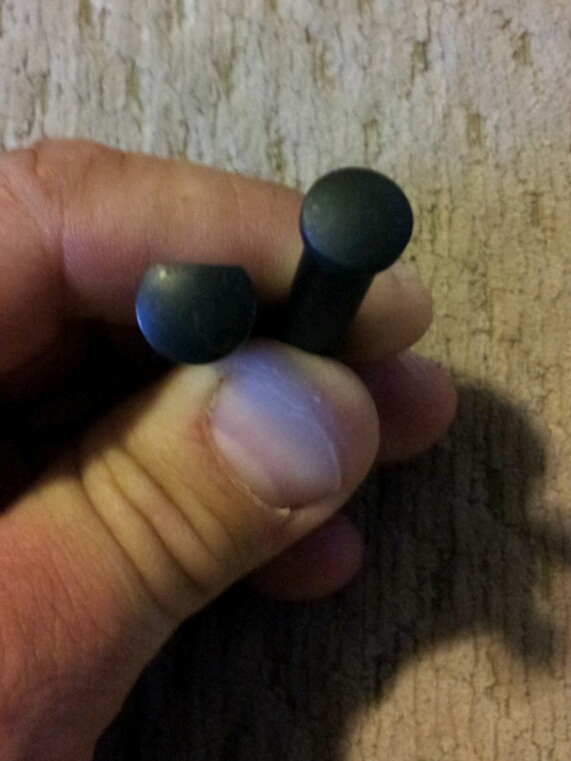

MONTANA308 Posted April 20, 2013 Report Share Posted April 20, 2013 Yes all works except for front pivot pin a had to get mine right from SI. The one in the kit will work but its to short and looks funny Quote Link to comment Share on other sites More sharing options...
MONTANA308 Posted April 20, 2013 Report Share Posted April 20, 2013 armalite on the left SI pin on the right Quote Link to comment Share on other sites More sharing options...
98Z5V Posted April 22, 2013 Report Share Posted April 22, 2013 (edited) Montana - hey, brother, can you make a precise measurement of the length of that SI pin for me? It's looking ALOT like the length of the RRA pin. If you can get vernier calipers on that thing and list the length, I can confirm or deny. <thumbsup> Edited April 22, 2013 by 98Z5V Quote Link to comment Share on other sites More sharing options...

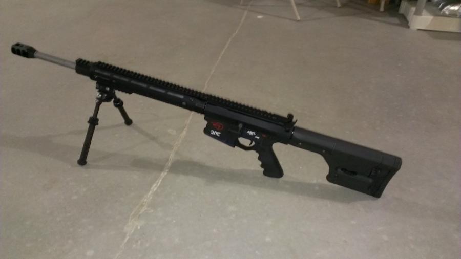

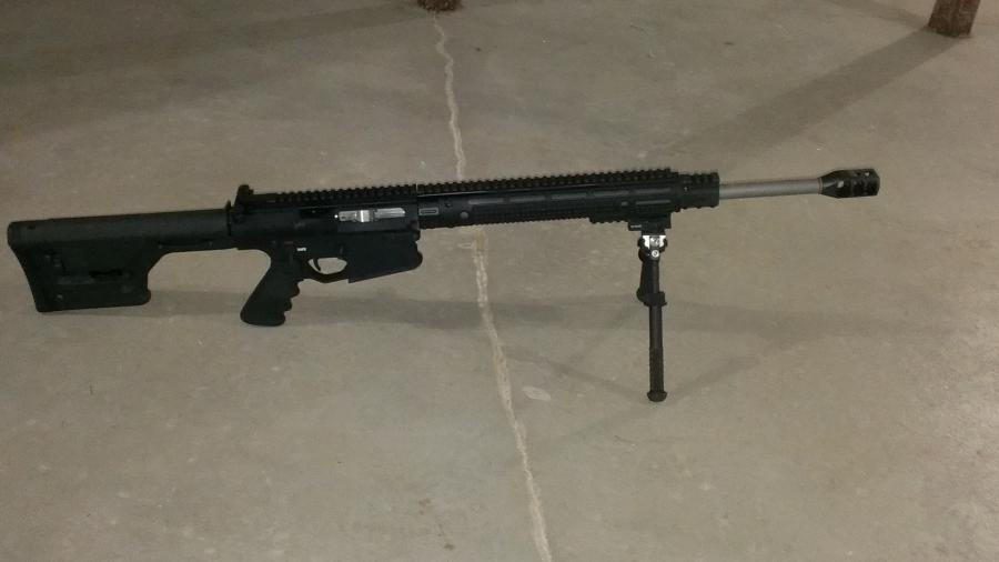

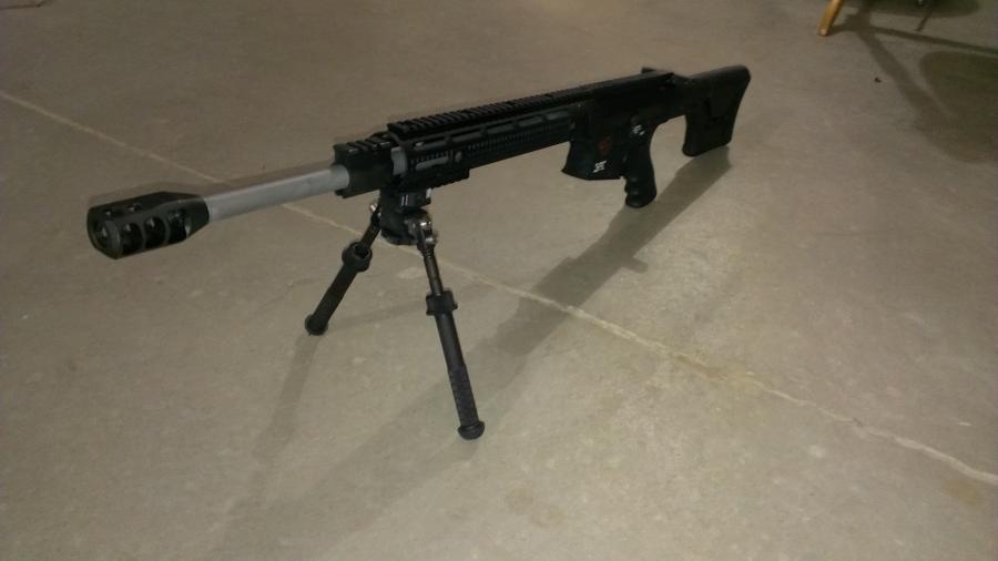

crazybull Posted November 26, 2013 Author Report Share Posted November 26, 2013 Well here it is I completed it a few days ago and just dropped it off with a friend of mine that does Cerakoting. I'm going to have him uniform the black on it so that theres not a dozen different shades of black and of course match the barrel also. Once I get it back in about 5 weeks I'll post an updated pic. Quote Link to comment Share on other sites More sharing options...
