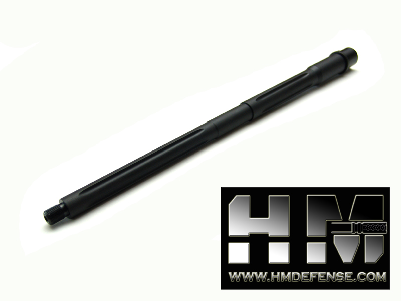

shibiwan Posted February 6, 2014 Report Share Posted February 6, 2014 Anyone have any experience with HM Defense barrels? I'm considering this for a 300BLK build. $250ish. - 16" carbine length - Fluted - M4 feedramps Thoughts? -S Quote Link to comment Share on other sites More sharing options...
98Z5V Posted February 6, 2014 Report Share Posted February 6, 2014 Hadn't heard about those guys until now. Worth looking into. Quote Link to comment Share on other sites More sharing options...
survivalshop Posted February 6, 2014 Report Share Posted February 6, 2014 Seems my Carbine gas system on my Wilson Combat barrel works good on any bullet it spits out , but never heard of this manufacturer. Just think ,YOU can be the first , you know the rules . <dontknow> Quote Link to comment Share on other sites More sharing options...
Dane Armory Posted February 6, 2014 Report Share Posted February 6, 2014 Made from bit chewing 4140Chromoly... price isn't bad. Quote Link to comment Share on other sites More sharing options...
shibiwan Posted February 6, 2014 Author Report Share Posted February 6, 2014 On 2/6/2014 at 5:07 PM, survivalshop said: Seems my Carbine gas system on my Wilson Combat barrel works good on any bullet it spits out , but never heard of this manufacturer. Just think ,YOU can be the first , you know the rules . <dontknow> yeah yeah... I know... buy/try/post review. Quote Link to comment Share on other sites More sharing options...
98Z5V Posted February 6, 2014 Report Share Posted February 6, 2014 On 2/6/2014 at 5:07 PM, survivalshop said: Seems my Carbine gas system on my Wilson Combat barrel works good on any bullet it spits out , but never heard of this manufacturer. Same here, with my Nemo barrel - nitrided, 16", carbine gas. I've picked up some more loaded ammo to try out in it, of varying weights. Right now, I don't have enough ammo through it to fairly judge it, but it seems like it'll be a good barrel. Quote Link to comment Share on other sites More sharing options...
