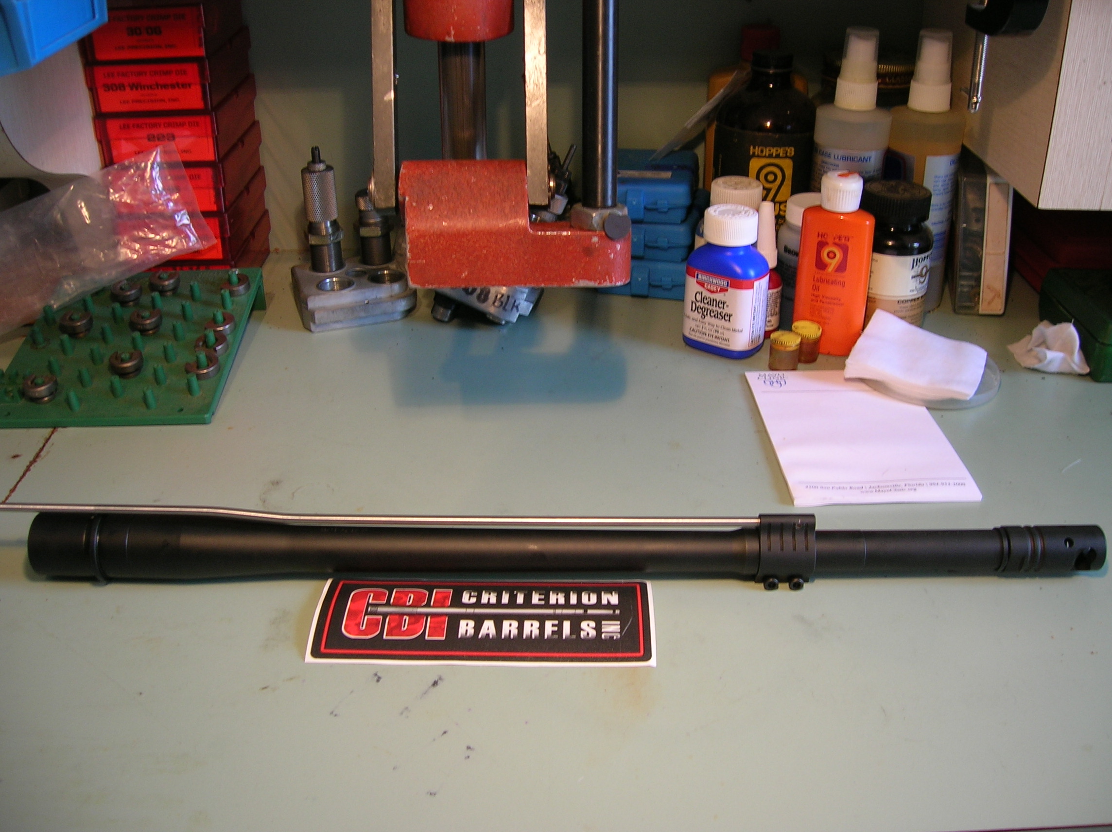

Are you building this rifle your self or having a builder do it ? As far as adj. the Gas Block on the Barrel , don't bother , your just asking for issues , if you want to adj. the Gas impulse , go with an adj.Gas Black ,like has been mentioned . You can look in the Reloading section & There is plenty of Chrono. results in there for different barrels , Powders & Bullet wt.'s .
The rifle length Stock will perceive less recoil for a number of reasons , one being a larger Buffer & spring & in the Magpul MOE , a good Rubber recoil pad . The Hang Guard on the 18" is an Early JP 's VTac ( pre 2009 ) , 308AR , with full length top Rail ( rail is an Exta $ 90 ) , other rails can be added at the normal positions . Why the 16" , just handy to carrie & swing around & slightly lighter , more compact with the Collapsible stock system. I have a Burris 6.5x22x50 on it , but was installed only to have a good comparison shoot out with the other two . I will go back to Iron sights only ,when done, I like Iron sights even with my old eye's. I would stick with std rifle stock components if using a rifle stock system.
I have a 20" HB , 18" med. & a 16" HB, all Criterion barrels on DPMS type Receivers ( the 16" & 20" have actual DPMS Receiver sets ), the 20" HB is a beast ,but will print one hole groups with my hand loads 168's & 175's . The 16" will do as good as the 18" & with those two I went to 155 gr. .Though the 168's do a bit better ,I don't have a range close that I can shoot past 200 yards & the 16" will shoot sub MOA at that difference, if I do my part , so its why I went to the 155 gr. . Just not much of a difference at that range between all three , I have no doubt about the 16" holding its own at 600 yards with good glass . My 18" has a Magpul MOE Rifle Stock & my 20" has an A2 , the Magpul is a much better rifle stock to me . I don't believe in any of that fancy stuff ether , All my Barrels have Rifle length gas systems , std BCG 's & DPMS Buffer's & springs ( 18" has a Tubb's flat wire spring & works great , only sing I had around at the time tat was correct for a 308AR ) , non adj has blocks .The 16" Has a Magpul CTR Stock & the rifle has a little kick , but its a 308 & on the lighter side compared to the other two , all Have some kind of Brakes & they all do what is meant of them , I could care less about noise , I wear ear protection . Slash ( Heavy Buffers ) maks a good product & they work , I just do see the need except as you say you want a .22 recoil from a 308 , it will help . As has been said , around here we seem to hear more issues with proprietary components then Factory copy types . It is good you want to stay with the Matched or same Manufacturers Receiver set . Theres a lot to a consistent shooting rifle , the 16" BBL. is a better all around rifle , would not be my pick for a Bench gun for a 1K yards, but will hold its own with a good Barrel , Trigger , ammo & the most important , a good shooter . Photo of the 16' & 20" , though the Upper Receiver, Hand guard & Scope reside on the 18" now , as seen in next photo . I'll get a recent one on the 16" later . 18"
