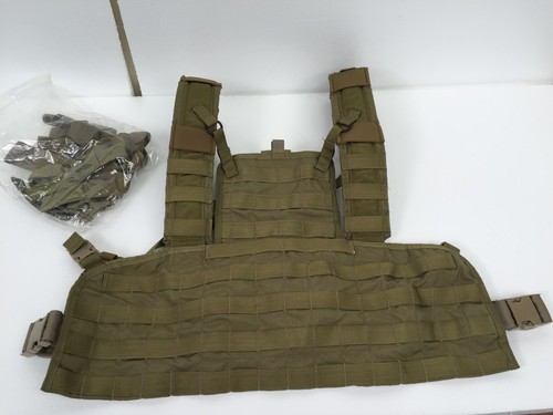

EasyEJL Posted February 23, 2015 Report Share Posted February 23, 2015 (edited) So I won a set of these for free, an eagle Rhodesian recon vestSo i'm looking at plates. It doesn't come with the rear or side carriers.Problem is i'm broke as heck. What I found that i'm seriously considering is getting this or the 8x10 versionhttp://www.ebay.com/itm/221416644776?_trksid=p2060778.m1438.l2649&ssPageName=STRK%3AMEBIDX%3AITuncoated, raw steel level III certified plates. I can do a base/prime coat on them myself cheap enough and just use it with the front plate only till I get the additional carriers. Also, since one plate is flat, I can use it in the backpack without needing the addon rear plate carrier for the vest.What do you think? Its $105 to get a single front plate coated with the anti-spall/anti-frag anywhere I can find it in steel and up from there for any other materials. Edited February 23, 2015 by EasyEJL Quote Link to comment Share on other sites More sharing options...

FaRKle! Posted February 23, 2015 Report Share Posted February 23, 2015 Nice score on the Eagle rig!Avoid AR500 plates. Save your money for composite plates. There are good composite plates you can get around $150 and good deals on used plates (not shot) are always on places like LF and M4C. A couple years ago I got a pair of ESAPIs for $350 shipped. They weren't stolen (no US Gov't markings or stickers), and had recently been inspected (x-ray'd) for cracks/integrity.AR500 doesn't perform well against high velocity threats (such as M193), and instead of capturing the projectile will spall it into you. Quote Link to comment Share on other sites More sharing options...
