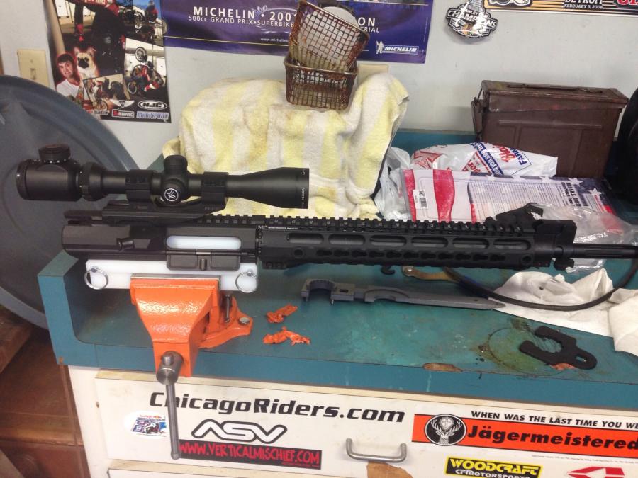

shepp Posted April 22, 2014 Report Posted April 22, 2014 (edited) Went and bought a bench vise finally and replaced my fore grip tonight. Took off the DPMS quad rail and installed a MWI 12" SS-key mod ultra light gaurd, packaging says it weighs in at 12.4oz with barrel nut, I took off 2 pounds roughly. Edited April 22, 2014 by shepp

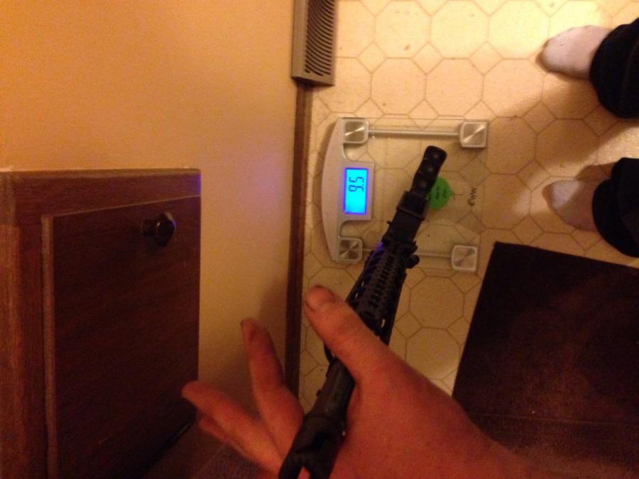

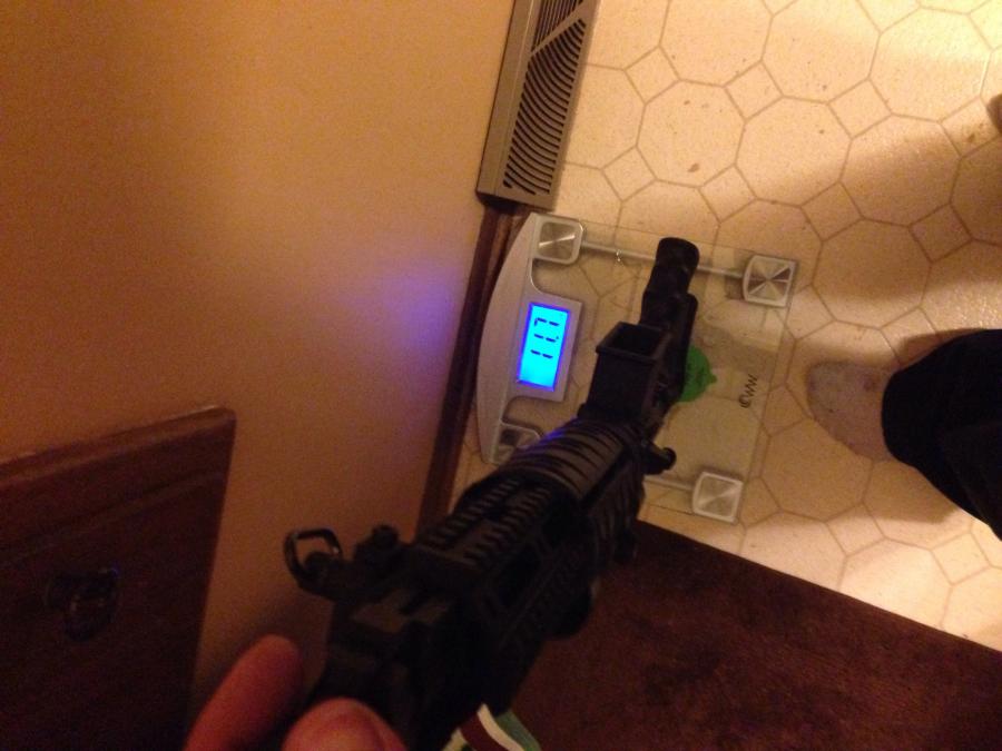

shepp Posted April 22, 2014 Author Report Posted April 22, 2014 Ok I'm an idiot lol, I put it all back together and forgot to put the bcg and the charging handle back in.......... So I gained a pound back. Still 10.5 is a lot better than 11.7
Microgunner Posted April 22, 2014 Report Posted April 22, 2014 That 1.2lbs will be a huge difference after 5 miles.

shepp Posted April 22, 2014 Author Report Posted April 22, 2014 (edited) I bet the end it's threaded I put mine in the bench vice block, removed the gas block and flash hider, wrapped the grip in electrical tape (so I wouldn't mar it up) and spun it off with a strap wrench. Think the quad rail helped a lot in getting grip with the wrench. I read else where guys used pipe wrenches and wrapped the "teeth" in tape What's the diameter of the grip I bet it uses the same barrel nut mine does and that's where all the dam weight was Edited April 22, 2014 by shepp
