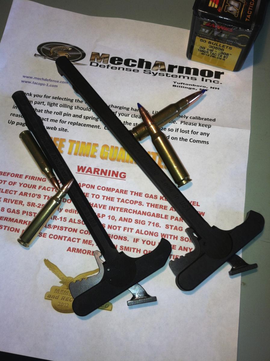

survivalshop Posted March 16, 2015 Report Share Posted March 16, 2015 The actual latches are the same for both AR 15 & 308AR's , the charging handle itself is longer on the 308AR's & the over sized latches do help . I noticed abnormal wear on the one side of the the charging handle channel from the side torque increase from the one I had . I have a photo I think some where or I can take another . May I recommend a complete replacement to a Ambidextrous over sized charging Handle from http://mechdefense.com. I have them in almost all my AR's . He is a sight supporter & their charging handles make it so easy to cycle the handle . Check them out . Quote Link to comment Share on other sites More sharing options...
shepp Posted March 16, 2015 Report Share Posted March 16, 2015 The actual latches are the same for both AR 15 & 308AR's , the charging handle itself is longer on the 308AR's & the over sized latches do help . I noticed abnormal wear on the one side of the the charging handle channel from the side torque increase from the one I had . I have a photo I think some where or I can take another . May I recommend a complete replacement to a Ambidextrous over sized charging Handle from http://mechdefense.com. I have them in almost all my AR's . He is a sight supporter & their charging handles make it so easy to cycle the handle . Check them out .IMG_1069.jpg Those are great handles sold by great people they get my recommendation too. I can pull mine back with one finger and easy to grab with scope in the way Quote Link to comment Share on other sites More sharing options...

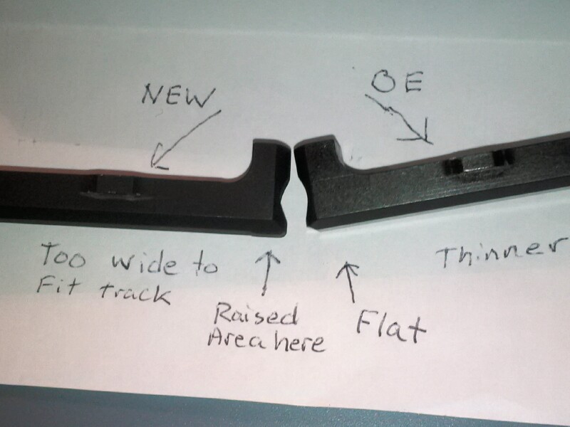

Morgan Posted March 23, 2015 Report Share Posted March 23, 2015 I had a similar issue and bought one from a recommended site. It would not fit my DPMS LR308B because of the areas shown in the pic. I carefully used a super fine file and worked the areas of concern, shown. It works fine now, but as you can see, it does not have as much front meat as the OE handle. I lube this highly when I clean it, so as to keep it slick. Quote Link to comment Share on other sites More sharing options...
